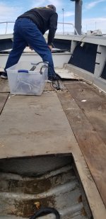

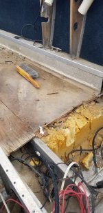

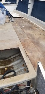

Best method of removing foam...just sawzall into sections and keep breaking it off in chunks..tried the short,square shovel..not much hell?? Pressure wash after...any ever used "Zep-A-Lume" for cleaning the corrosion off in prep for repair and sealing?

Just looked up the MSDS on Zep a lume...pretty nasty stuff..like complete bunny suit nasty...Next idea...

Sadly think you had the right idea with the shovel. I have seen people use cheap roto tillers, but that was on a large ship and had literal rooms filled with foam.

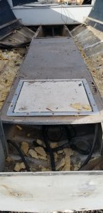

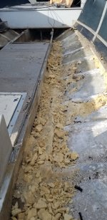

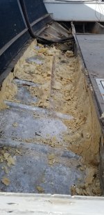

Got the majority of the foam out...NINE 55gal trash bags..phew! Now hands and knees for the other bits...then pressure washer..will pressure washer get the remainder? Or is it wire wheel and scraping?

The foam removal and the paint stripping are the two tasks I am not looking forward to on my MR180. My other two Starcrafts both had the foam sheets, not the pour in, so removal was rather easy. And...with the new stripper material available today without all the good stuff, not sure how its going to compare to the old stuff I used before. I still have a small supply remaining, so I'll save that for the trouble spots.
Following on the residual foam clean up as I'll be there at some point in the future as well.
SHSU
Lieutenant Junior+Starmada Splash Of The Year 2019
Mar 8, 2017
1,766
Can't hurt to try with power washer, but would still want to wire wheel back behind the foam. Want to make sure all the corrosion is out and no pitting is hidden under anything.

That pour in foam is the bane of AL boats, not sure why anyone would want to use it. Yeah it does look like a large amount of crud and corrosion is under the foam from the pics.

Know anyone with a media blaster? I had the exterior and some of the interior done that way. I didn't have foam, but the media blaster should make short work of any as well.
