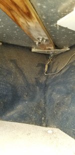

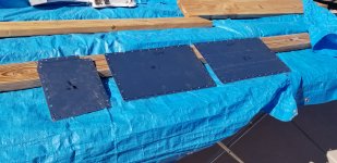

New transom is in...transom has been reskinned and patch panels for the hull...rivets on Tuesday!!

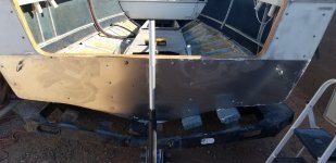

Well about 250 rivets later...7 patch panels in...5200 to glue and seal...PC11 2part epoxy inside the hull....new foam tomorrow

Nice work, looks like some really good patches and rivet work! (y)
Hey @classiccat you have a patch master challenger!

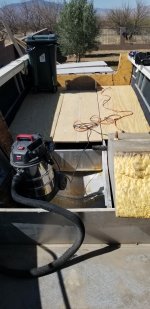

Working on the new deck and foam...delayed by high winds almost daily...and a few dust devils thrown in for good measure...yay!

What kind of foam you going to use?

Extruded...not expanded...polystyrene..1" thick..on edge...rigid, closed cell..waterproof..lengthwise..on top of the cross ribs

Fyi...what you see is one 4x8 sheet of 1" board...guess it's going to take 3 or 4 total...stay tuned!!

It'll take more than that to adequately float a 220V. I did the math, as best I could, for what the statutory requirement would be for my 22ft V5 SS (at its listed capacity/weight) and it came to like 12-13 in of foam (calculating conservatively as I didn't weigh the boat, and assumed that anything I couldn't account for was aluminum). 9 in of that were to float my powerplant and the load of the boat.
3 in of foam is under 500 pounds of flotation (or enough to float around 750 pounds of mostly-submerged aluminum). It, along with your wood, will float the hull but not be up to standards.

You're probably not that far off without needing to float an 1100 pound powerplant on top of your load capacity...however the worst thing in the world is packing full of foam...but not enough.
