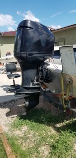

Got around to building a stand for the Opti 200...needed to get it off the pallet and check k out the forklift damaged port lower cowling...geeze this think looks huge on a stand! Gotta get splashwell finished so we can get the engine mounted on the boat...one step closer to splashing it!!

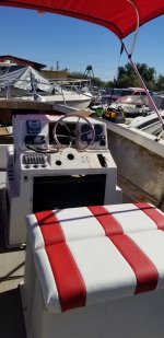

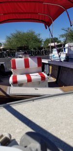

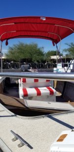

Some other stuff done..cushions are done...console refurb mocked up...bimini installed...hydraulic lines and control cables run...batteries moved to front of helm seat...Optimax 200 mounted... more to come
