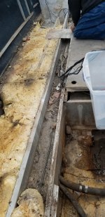

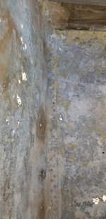

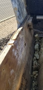

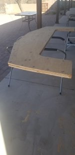

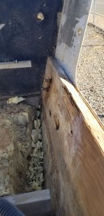

Trying to group the rebuild pics in one area...bear with me...got the transom out..new one is cut..glue and screw and seal this week...floor removal starts tomorrow..prior owner covered rotten floor with 3/8 ply and white roof coating...more to come...I'll try to locate and delete earlier posts..so everything is in one spot...

Seat is out...console is out..both at the house for cleanup and rebuild...

Old transom out..new one glued and screwed ..finesse and sealing over next couple of days...pulling up some more of the "overlay" and original floor tomorrow

Transom corrosion, a common theme on these old hulls.

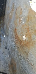

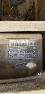

Got the top layer and the bottom layer of decking off..working on the foam...ugh!!..Bonus find..prior owner installed a poly 52 gallon fuel tank and found a 10amp on board charger under the starboard gunwale...
