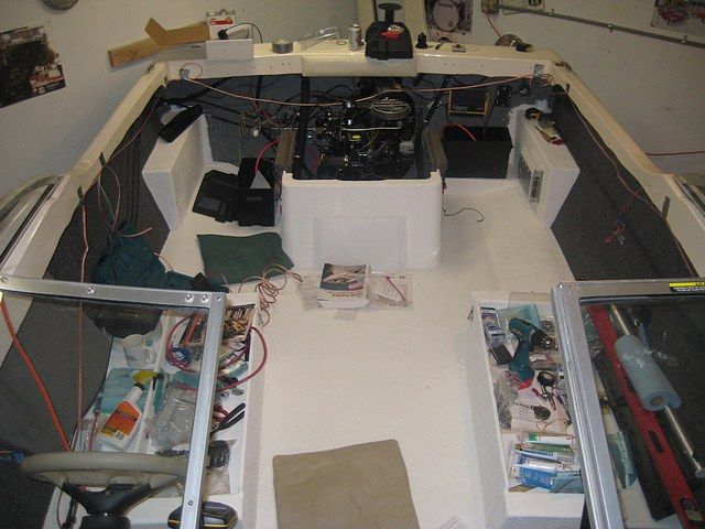

A few more pics.

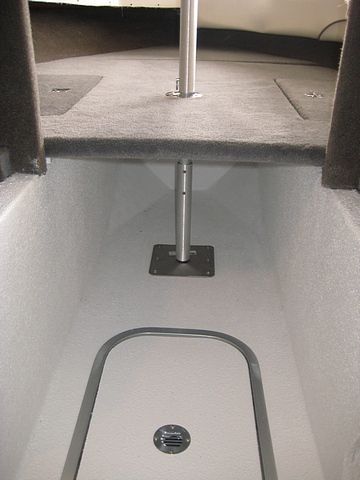

Installed seat,

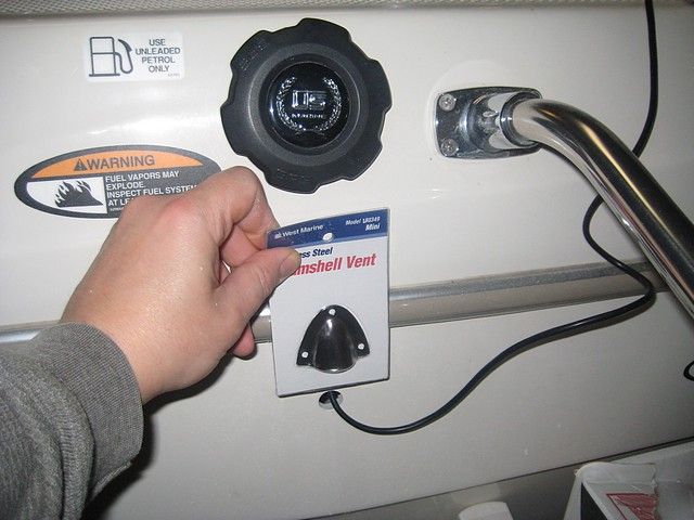

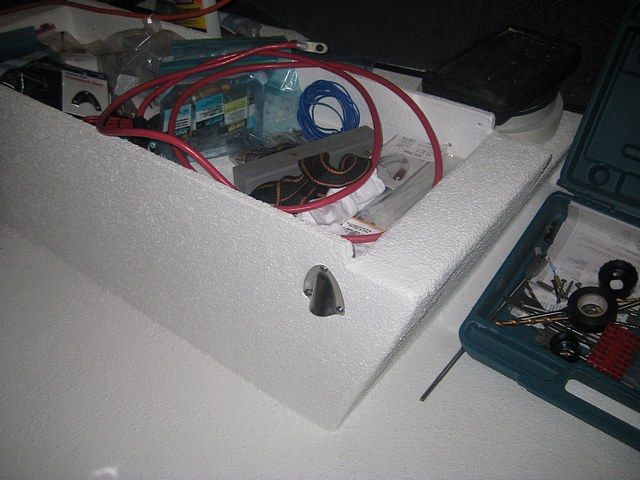

Clam shell vents I used to cover lame holes Bayliner used for drains... Very crude workmanship... This at least looks clean and marine...

I can't believe they just drilled holes and used no finishing fitting. Those clam shell vents really look great! Gives me an idea.
The boat is really coming together now. It looks new!

Nice work on the platform, Bear! The openings to the storage are a great touch.
My bayliner had just the drilled holes as well (some were 1" above the bottom, too, so water would never drain :eek:). Those flanges are a really good idea; They almost look like deck lights how they are positioned.

Drilled hole in transom for transducer cable. More clam shell vents! :D

Looking great. I LOVE your fishing platform up front. I hope to upgrade to a bowrider at some point in the future and that's exactly how I'd like to outfit mine. Some custom bow cushions for the non-fishing days would be sweet as well.

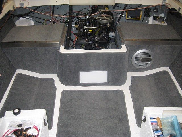

Houston, we have carpet.....

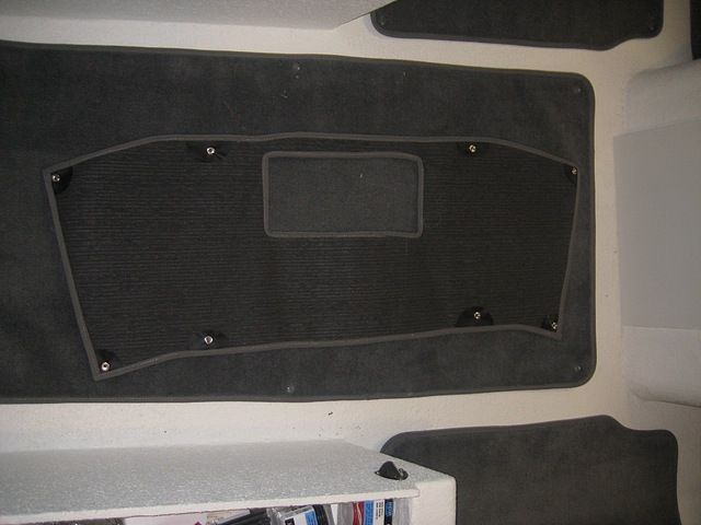

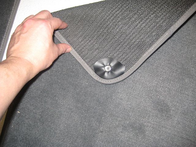

Upholsterer did great work. Nice reinforcements at all snaps.

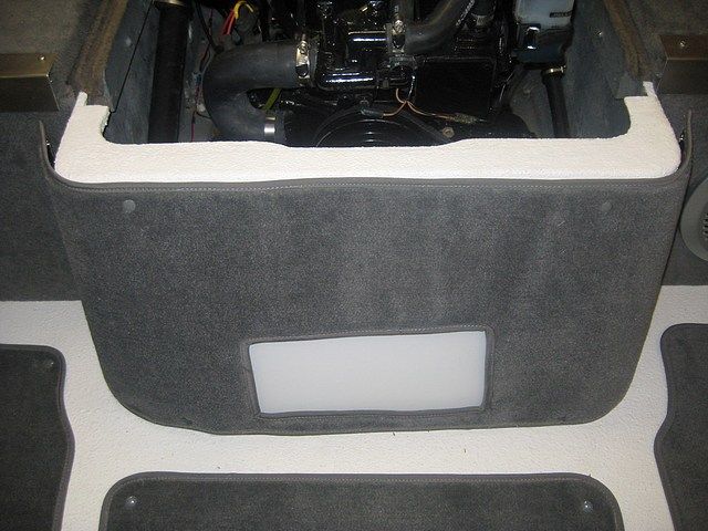

Dog house cover better than expected! I plan to put a stainless plate that matches the stainless on stern boxes. I had the entire cover binded, and 6 snaps installed. This beats adhesive on my newly fiberglassed doghouse!
All together I have ~ $250 total in the carpet, fishing deck, stern boxes, everything.
A few more pics..... Please note the carpet snaps have not been installed, hence loose fit look... She assured me if snap receivers are properly installed, any wrinkles will disappear.

Looks great. i am interested in doing the same thing.. my concern is that if the carpet is out and someone is barefoot how will the carpet snaps on the deck feel.. i guess it doesnt matter as it will only be out for fishing and i dont fish barefoot...but let us know what you thhink of the duraback and snaps on the barefeet.. THANKS

The snaps are out of the walkway. Mostly placed on the sides of decking. I would imagine running on them wouldn't feel the greatest, but I don't think their gonna make you stub your toe or anything. The textured Durabak doesn't feel bad on my feet. I think it's due to the texture being recycled rubber. The deck seems to have some give to it.

WOW! Those carpets looks great! I dig the curved corners on those side ones; Makes them truly custom for your boat. What is the white rectangular area on your doghouse for?

That is a junk piece of plexi covering the hole/ access fuel tank sending unit, ans engine mount. Factory had carpeted piece of wood. I'm putting a 10 ga brushed stainless plate there for the cover...
