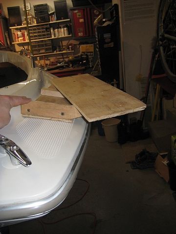

Hey Gang,
This is super cool! This lady at work is our companies master welder... She rules big time! So I asked her if she could help me design a trolling motor mount for my new Motorguide w55 wireless. She said she could, but her husband should get involved because he can make it look good.. He came to check out the boat, had me hold the motor in position a few times, wrote a few measurements on scrap paper, and a few day's later she hand me this mock-up. It's perfect! Exactly what was in my mind... Hes gonna make it in 10ga stainless. It will mount on rubber bushings, with stainless bolts... This dude only looked one time.... I'm blown away! This would have crushed my brain for months! :D
I'll be doing more glassing this weekend!
Also did some research on installing a 4.3... It looks possible, but will require me to fab/tie-in fiberglassed rails to the current the stringers to mount the 4.3. The stringers are to far apart currently. The engine box will also need to be modified. I wanted to have a bench/sun deck style seating/engine box anyway... But I'll continue to research exact details regarding structural safety, and realistic practicality... But I think it can be done...
