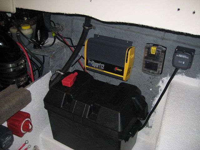

The items behind the port side battery, are the Guest dual bank charging system, 6 input fuse box for house aux items (stereo etc...) And neg house battery distribution stud. All in that order...

Ooooh, very neat and clean looking. BTW, where did you get the 6 fuse box? Is it from NAPA?

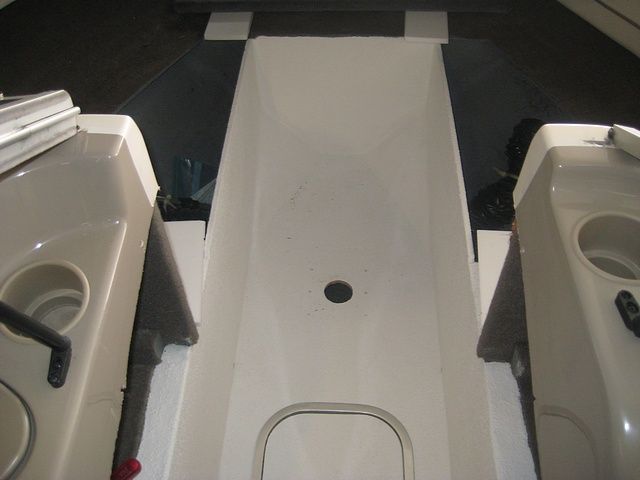

bear_69cuda
Oct 10, 2008
2,109
Re: 1999 Bayliner Project
Thank you sir for the kindest of words!
Durabak comes in many colors... They do offer off white.
Now off to the garage to continue quest. I think I'll mount the fish finder / depth gauge. Still pondering the tranducer inside the hull.
Then I need to calculate wiring runs, gauge and color...

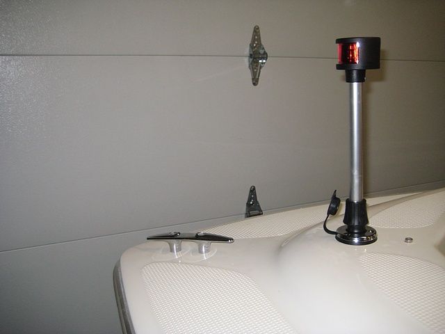

My friend Patrick and I installed some bling on the Bayliner,
We installed starboard and port side cleats for docking, and fender hanging. Port side docking with bow cleat would have been difficult with trolling motor installed. I like the idea of hanging fenders at the side apex's of the boat.
Installed plug style raised bow light. Needed to be raised due to trolling motor height, this makes red port light visible.
Also installed stainless through hull bilge fitting, chrome bilge vents, and horn cover. Mark and I have the same taste! Stainless looks better than white plastic.

Is that cleat the Attwood stainless through bolted cleat? I was thinking of replacing the chrome cleats on the Bayliner with the Attwood stainless cleat. I called Attwood about it and they said it is supplied to a few different boat manufacturers as an OEM item.
Its got a nice contemporary look that looks nice on a lot of boats.
Attwood 6" stud mount cleat:
Hey! Nice thru-hull!
bear_69cuda
Oct 10, 2008
2,109
Hi Mark,
Yes there from Attwood. The same cleat in the pic you sent 6". I also was thinking about replacing the other 3 on the Bayliner so they all match... My stock cleats have screws visible from the top-side...

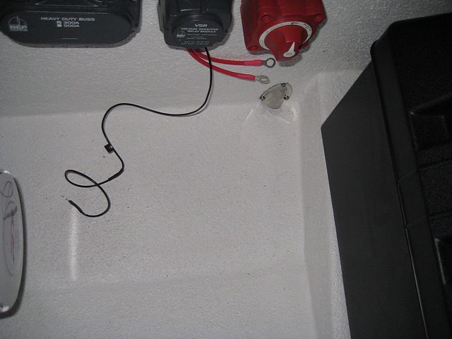

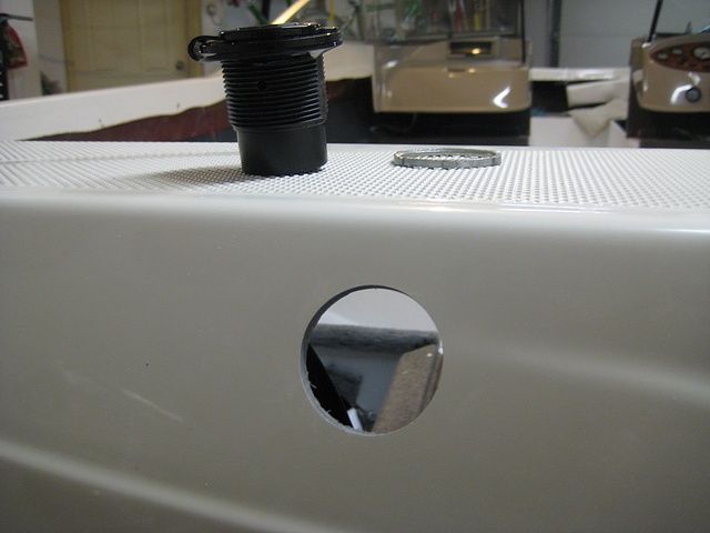

My Guest charger had issues, so I exchanged it for this one.
The a/c through hull plug adapter for the guest is specific for that charger, so I need to visit West Marine again... :D A few pics of placement, and 1-7/8" hole in stern.
Also thought these clam shell deals would look cool covering the unfinished holes into the bilge...
