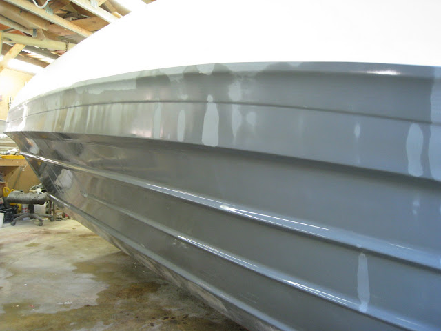

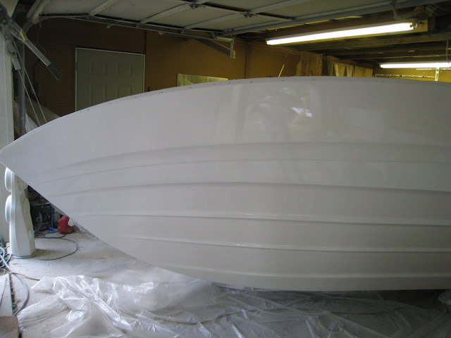

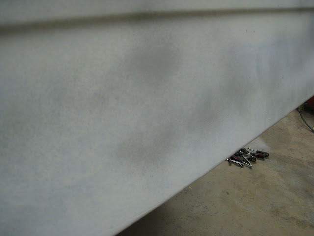

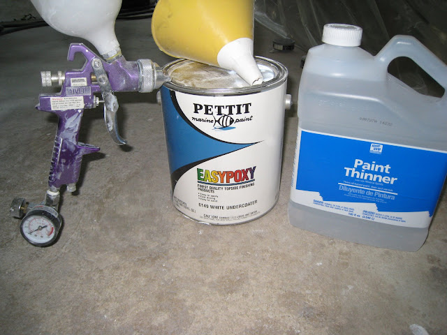

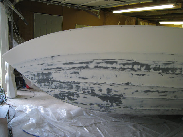

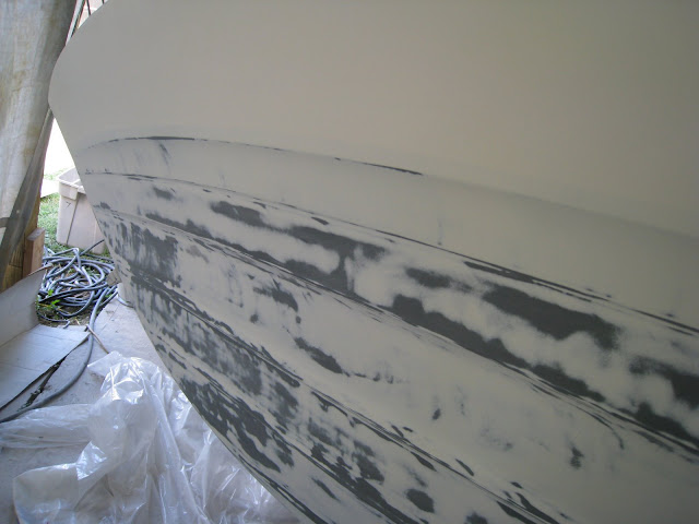

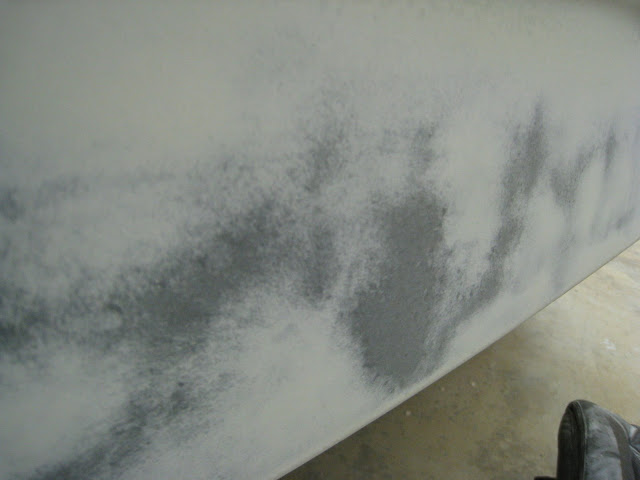

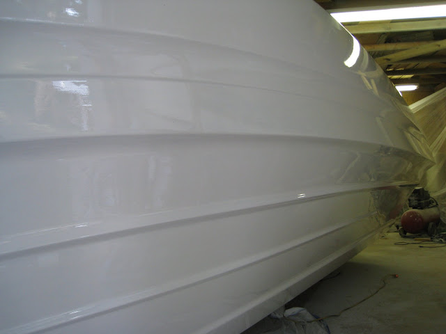

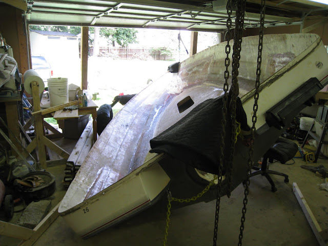

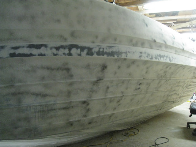

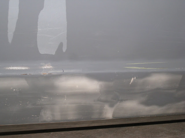

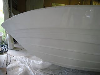

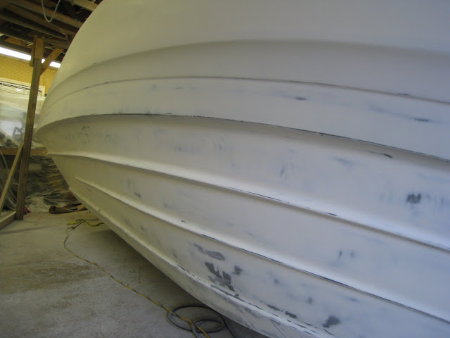

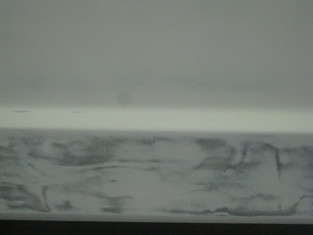

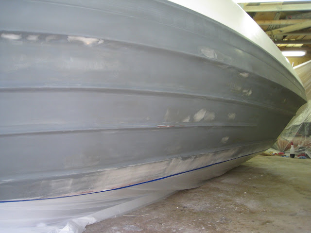

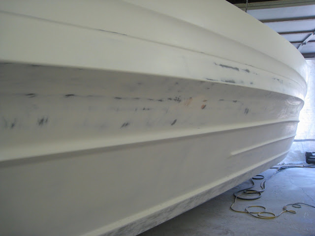

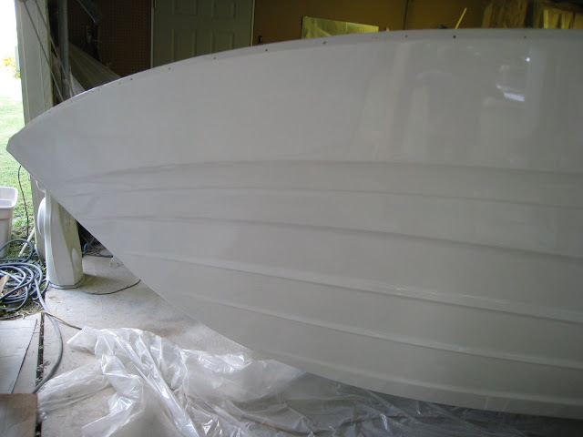

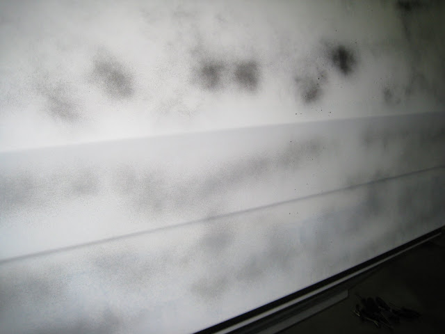

tons of photo goodness to make up for it! I have been hard at work the entire time and things moving forward nicely. I didn't flip the hull as intended, as I just couldn't figure a means to do it alone. As a close second, I rigged up a means to tilt the boat sideways, so each side could be done individually. This, so far, has been working out well enough. Today I'm at the point of applying my first layer of primer on the hull, so here are the missing bits to get you caught up..

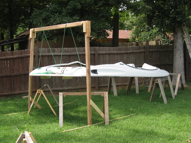

Needing room in the garage, the cap found a resting place in the yard. I'm resting it on some sawhorses for sanding, priming and eventual painting.

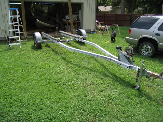

The first time I've seen my trailer empty. While the hull is in the garage I'll take the opportunity to rewire it, install new lights, new bunks, new rollers, new wheel bearings, new u-clamps (the existing ones look scary-corroded) and rebuild the ball receiver assembly.. and maybe paint that old rusty crank, too.

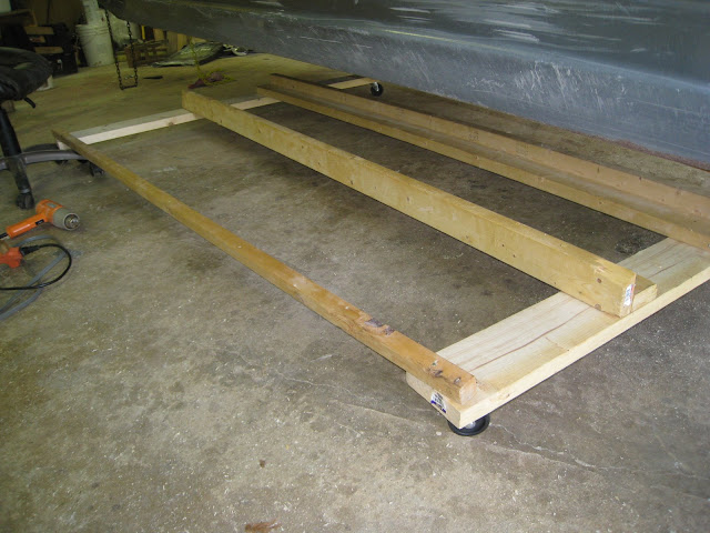

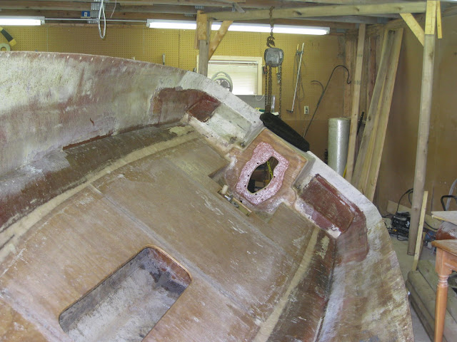

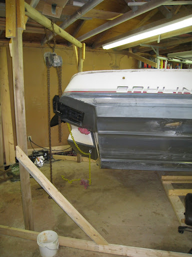

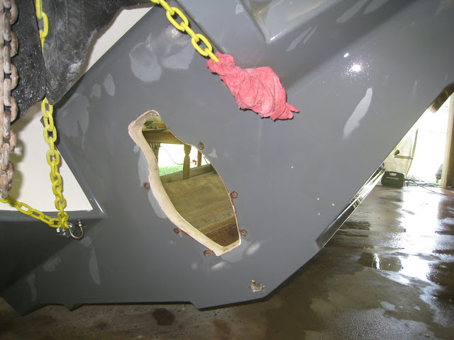

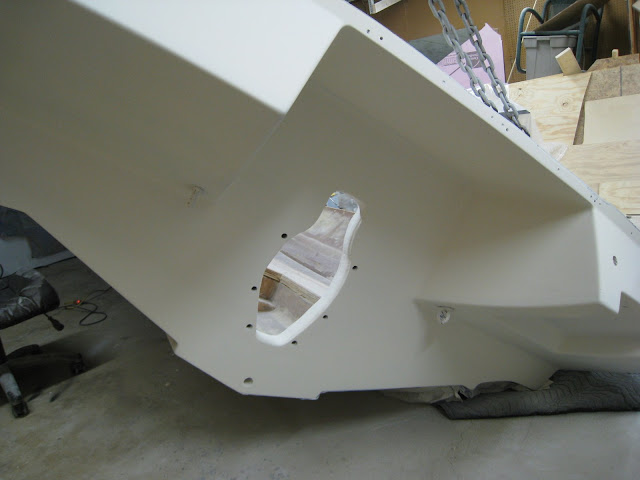

I wasn't able to flip the hull on my own, so this will have to do. I'm lifting it via the bow and stern eyes. Note the yellow chain.. it goes from one stern eye to the other. This allows me to simply move the chain fall hook from one side of the chain to the other in order to lift the respective hull side. Works quite well.

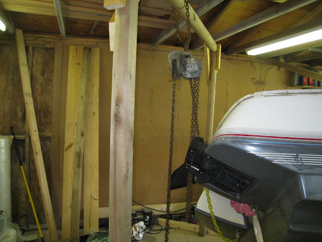

Here is the gantry I made for lifting the hull. it is made using landscape timbers, as HD was having a $2/ea special, which made them as cheap as 2x4's (they have the added benefit of being handy for landscaping, too
Another look at the gantry build, for those looking to duplicate it. I added a brace against the side wall as the verticals began to tip sideways at one point.
