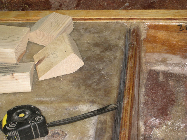

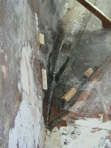

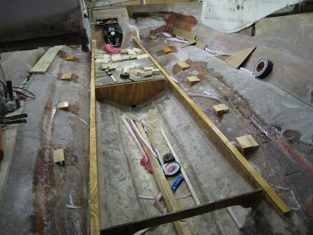

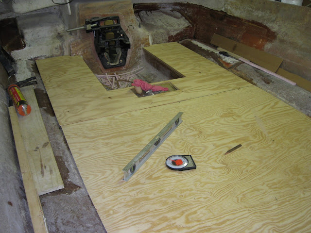

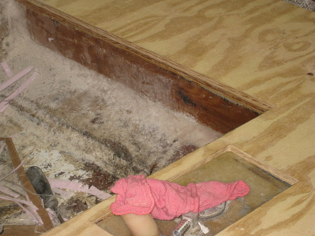

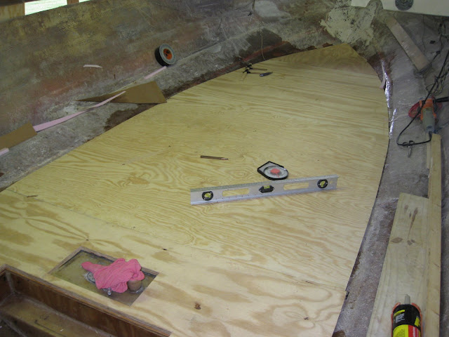

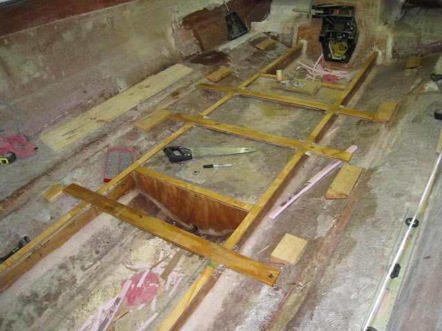

Not trusting my deck cutting skills, I decided to make some solid platforms for the edges of the deck to rest on. They are made from 2x4 bits cut at various angles (from 16-45 degrees) then poly'd and glassed to the hull. I wasn't too worried about making them perfectly waterproof, as they aren't crucial, just there to make me feel better and to add support until the deck is fully glassed in.

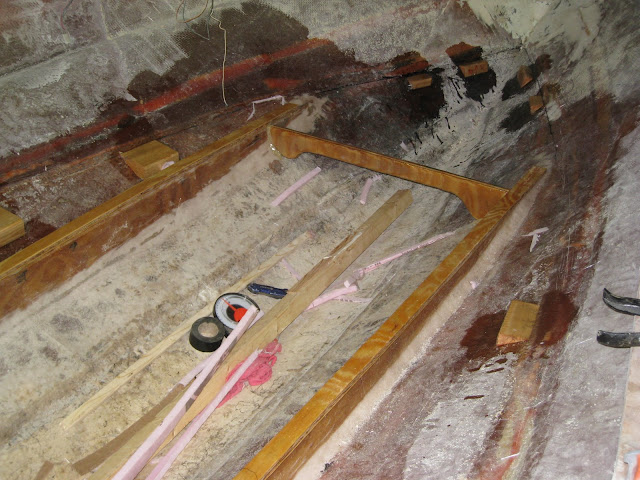

The dog bone is now mounted. I measured the ski locker length before placing it in, as I would hate to find it is in the way when cutting the locker hole. Once the PL sets I will tab it with glass just as I did with the bulkheads. Also notice how the deck supports go right into the bow. I was most concerned about that area, as the chines, combined with sharper angles, make for difficult deck cuts and I wanted to ensure proper support in an otherwise unsupported area.

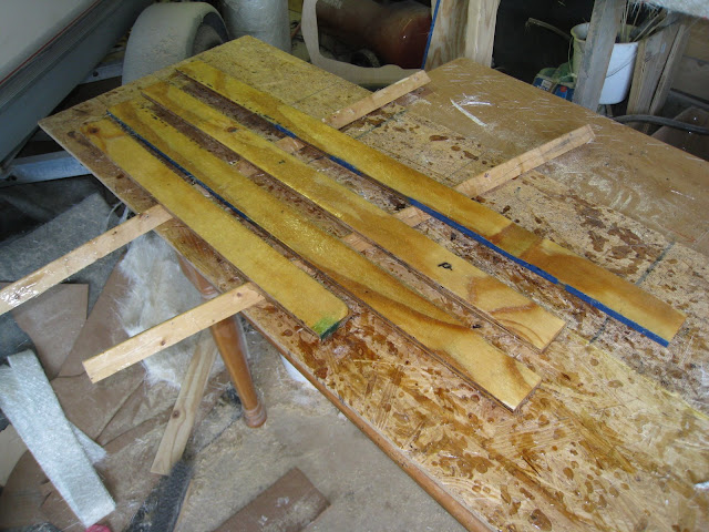

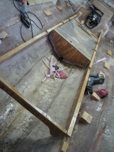

I installed the stringer lifts. They are 1/2" plywood cut in ~1" strips and PL'd into place. Notice the fuel tank is nicely under the stringer tops, now. I have lifts drying on the poly table for the bulkheads, dog bone and fuel tank which will go in tomorrow.
Tomorrow I begin marking and cutting the deck! Milestone, baby!
