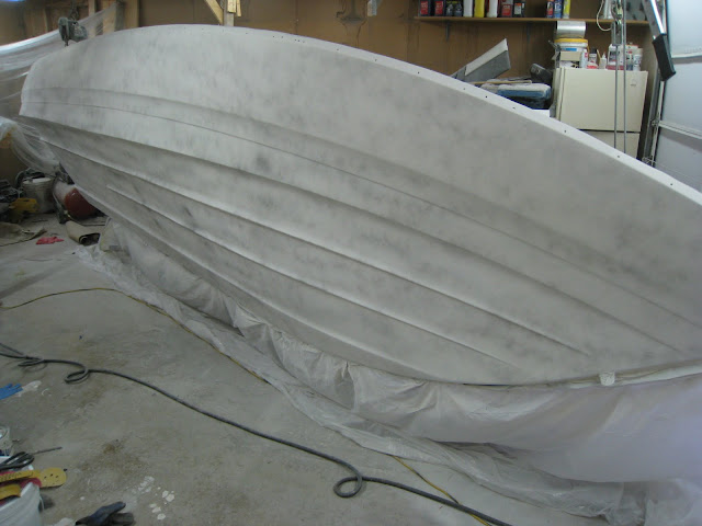

I wet sanded the starboard side of the hull completely by hand and have to say, even by hand it is way faster to hand wet sand than it is to power dry sand! Now, I've never wet sanded in my life, so this is totally new to me and I can't be more impressed. I literally sanded one side of a 20 foot hull with one single 2"x6" piece of 320grit sandpaper. Dry sanding this same side used at least 3 sanding pads and 5-6 strips of paper, so that is a major material savings.
So what is bad about wet sanding (everything has a price)? The mess! You get paint dust, now liquefied, all over your pants, shoes and arms, so wear something you don't mind becoming 'painting clothes'. A very important lesson I learned while wet sanding is to wash off what you sand, quickly, as when it dries it is almost like a new paint job, a real drippy, messy paint job, and requires sanding to get off (which means re-sanding everything you just sanded). So wash what you just sanded often to avoid repeating your work.
Of course, the sanding was all for a purpose.. paint! Paint which I got in last night. It is automotive paint this time around, as I have grown to despise topside paint, and since I have to clear coat it, I might as well base coat it, too. Before I submit my boat to the sprayer, though, I still have more practice time to do with my HVLP gun. I'm having a tough time getting paint to spray on without sagging or getting more-than-I-want orange peel, so I'll be spraying on some practice panels until I get the hang of it enough to try the boat again. A major delay in forward movement, but I've been wanting to learn to spray paint for a long time anyway, and this is a perfect occasion to hone my skills.
And the long awaited photos..
Time to find those last few nick and scrapes using my trusty guide coat, AKA vandalism. I can't express how useful this technique is. The difference between "It looks smooth to me" and "I know it's smooth" is a wide margin.

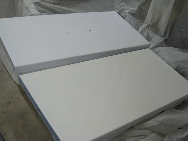

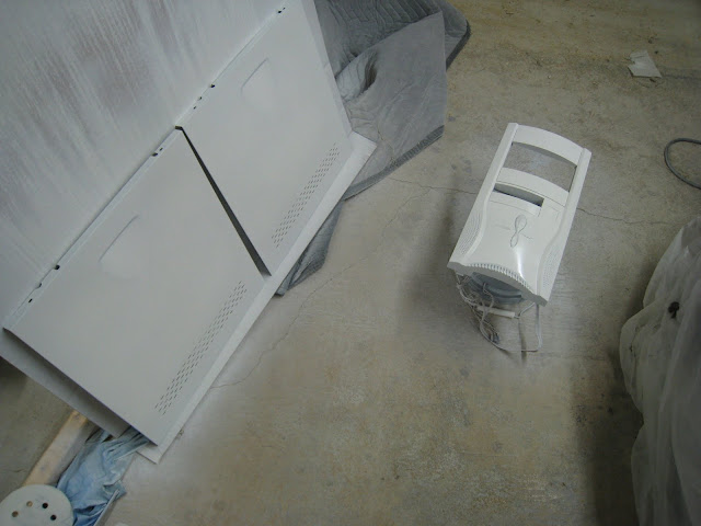

Computer cases in a boat thread? Blasphemy! Here is my practice testbed. I used this because I was about to throw it out, but once I had it all painted, I wished it was my actual case.. it looks stunning all painted up! Yes, I am a computer geek.

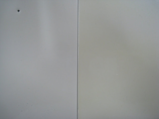

White versus Pearl - Battle of the titans! .. or something (Pearl is on bottom)
Light sources is what makes pearl stand out. Although the camera has a hard time capturing it, the left panel has a noticeable purple hue around the light. The greenish-yellowing, by the way, is caused be the fluorescent lights. The pearl apparently brings out the icky color of those, too.
The difference is subtle, but you can see the effects of the pearl on the right side panel as it moves from light to yellowish to light again. The left panel is white with no pearl.

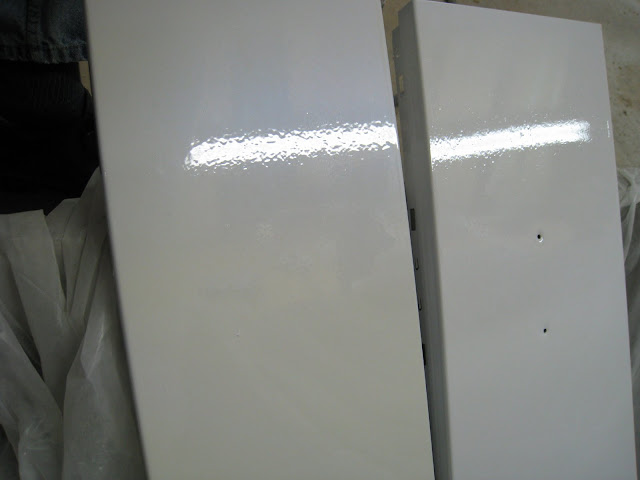

Pearl paint aside, this is what I've been trying to eliminate.. the orange peel effect caused by.. well, I have no idea what. I have been able to minimize it in later attempts (this panel has been repainted a LOT of time, hehe) with a mixture of paint thinner and acetone as a thinning agent and some better gun handling. Although the latter is likely more influential.

also....all paint has orange peel when sprayed...some worst than others...
automotive paints use REDUCER...not acetone or mineral spirits...so the results should be different when you spray the good stuff
Read the directions on the paint can and or on the manufacturers data sheet look online for thier PDFs that show reccomended spray pressures and such...I use a separate regulator and a little inline air filter for my setup (HVLP) It is usually at 25ps when idle, 10 to 12 lbs when spraying, when spraying is the important pressure! I go a little high on the pressure as my guage probably isnt accurate and sprays better a little high
To reduce orange peel, (this will be info for clearcoat as the base coat wont orangepeel)...spray a medium wet coat, let flash 5 to 10 minutes....then a wet coat....followed by another wet coat after the 2nd coat is flashed..should be tacky and not wet...(touch it in an inconspicuous area with the tip of your finger).....spray that last coat and let her dry.
HVLP use your bigger needle and spray tip (IE 1.7 mm tip) vs the 1.4 tip...clears need the bigger tip to get good coverage
a couple runs and sags WILL be INEVITABLE as you're spraying a vertical panel....try not to get too many runs....these will have to be sanded off using 800 or 1000 grit and polished out.....once it's all dry (next day)
after that you are DONE...you can leave it as is and it is fine....may have some orangepeel but look at your Ford or another cars paint..they have it too!
for a SHOW FINISH add a 4th and maybye even a 5th clear coat layer! 1/2 of that will be sanded and polished off...in the old days laquer guys would do 7 to 10 layers!!!!!
then carefully wetsand the whole shebang and polish it using finer and finer polishing stages...till super glossy no one said it was EASY ...it is however mostly LABOR INTENSIVE thats why a show finish / super smooth gloss etc is expensive!
