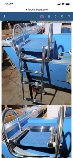

Actually, my wife likes the sleeper seats so I’m making them so they come out easily and hidden underneath are the pedestal sockets so I have flexibility to turn my boat from a family boat to a fishing boat within minutes.
I too was mulling over reworking my splash well and incorporating 2 small folding jump seats in the corners, but they may end up pretty narrow. but I just picked up this swim ladder for one corner, so I’d be down to one jump seat unless I could somehow incorporate a step to the walkover platform. This photo is from another iboats Starcraft forum mate (sorry my feeble memory forgot the member name) and I really quite like it over the swim platform that sticks out the back.

SSM - thx for the info. I like the swim ladder idea as well. That just might get added to the list.

Anytime. If you want to see the ladder full scale, let me know. I’m not far from you.
