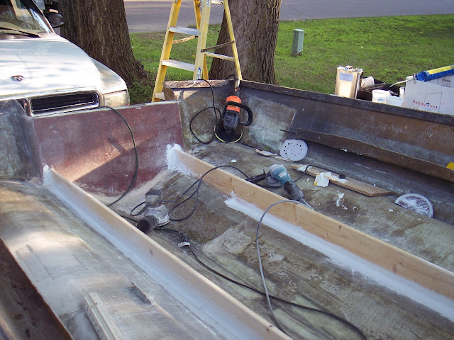

Well, so much for me doing a tutorial. HOWEVER, I will detail the process I used. All in all, I was quite happy with the end result. What I did was made sure the stringers were set well into the boat and braced properly. Then I simply took a chalk line and hooked the front of the stringer where I wanted the floor, and then to the back where I had marked a line where I wanted the floor. SNAP! Chalk line! I did the other side, and then compared the two. Almost spot on on each side, and some of the marks I had made previously with a different method were crossed by the chalk line, so I was confident enough to make the cut.
What I did to cut them was to take my router and set a 1/4 inch shaping bit 3/4ths the way through the wood. Then I screwed the wood to my table, and put my spare 12ft piece of wood 2 1/2 inches ( verified by placing the router at various spots along the line ) away from my cut line and screwed that down as a guide for the router. Zipped my first cut, then set the depth to cut through....did a nice job of giving my a nice straight line, and then I routed a 1/4 inch rounded edge on the top so I can glass it with a nice radius.
So, in summary, I made a rig to suspend my stringers from my hull above where they were going to be placed, and then scribed the shape of the hull onto them. Cut, dry fit and then chalk lined from front to back to find my height and cut with a router, then rounded the edges for glassing. Easier done than said when it was all finished. I freaked a bit because I couldn't envision what I was going to to, but as usual, a good day of thinking it through gave me a solution that worked well.

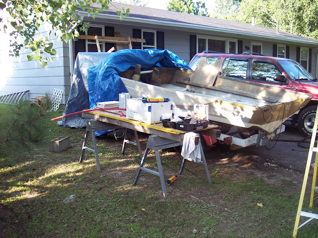

Second set of PL applied to glue the two stringers in. Once that's set, I can make the radius for the fiberglass and start kicking some resin!
I made a bit of a mess with the glue moving the stringers into place, but going after the PL the next day with the relatively mild days we are having allowed me to scrape the excess off easily. Now I just have to give the glue a chance to harden a bit and I'll have two stringers in my boat in no time! :)

Well, got the corners done. I'm going to do some more grinding on the hull now that the two stringers are bedded and the corners are radius'd. I want to make sure that the fiberglass bonds well. I'm tempted to put a layer of mat over them first, and then run the biax up the sides. I'm not sure yet. I've got 2 gallons of polyester resin, so I know I won't run out anytime soon, and I've got lots of CSM and 1708 to work with. Fortunately, the weather here has only been humid with light rain, and my tarp has held up with the ladder in the middle of the boat and tied down to the trailer.
I was looking at sheets of plywood today and our Menards has Baltic Birch. It's 9 plies to a half inch sheet...very sturdy! I was planning on a half inch deck with plenty of glass over it anyway, but this Baltic Birch looks promising verses the Aracao Ply they have...I saw some voids in the Aracao stuff, and the Baltic is SOLID. Granted, it's $32/ 4x8 sheet, but for the extra strength I'd get from a 9 layer ply verses a 5 layer ply, I'm intensely interested in going that route. Of course, I have to make sure I don't cut the ply wrong if I do get it...measure 8 times, measure again, and then cut after measuring one more time...better measure that again... :D
I'm going to use pink foam insulation panels to make my deck cut out instead of cardboard since this seems to be a better template....either that, or I will use sheets of luan....we'll figure that out when we get to that stage. If I keep going at the rate I'm going, I'll have my final stringer installed in the boat by next weekend...weather and my job permitting! After that, it's all deck!
However, one thing that needs to be addressed is adding knees to the transom for added strength. I can use up a little bit of splashwell space without sacrificing that area for battery space since I'm moving them under the back corners anyway....
