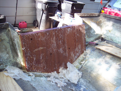

Grrr...! I don't know about this fiberglassing thing.....I'm a little down on it right now. I had everything pre cut, laid out and organized. Started putting the resin on a corner and stuck my corner piece on....mat saturation was crap. So, I tried adding more resin thinking I was short on the amount of resin it needed. Okay, I'm seeing progress, but how much resin does this stuff need in order to saturate? I was using the nice little ribbed roller to get rid of air bubbles, and all I'm doing is rolling out the resin, not the air! And it's just not conforming at all.
I'm getting the sneaky feeling that the resin I'm using isn't breaking down the binder in the glass mat I'm using :(
redfury
Jul 16, 2006
2,659
Re: Ooo! Sparkly! Redfury's Grinding again!
Well, this is the three stages I went through. Prep, prep and more prep. Then I laid 2 pieces of glass on to get it to get a proper exothermic reaction. I was rolling resin OUT of the glass. I put wax paper on it and went in the house for 15 minutes and came back out and pulled it off. There was no change. It was FULL of air pockets.
Not happy with the results, and the fact that it is the TRANSOM and I'm not screwing around with that....I pulled the 2 layers of glass off in disgust.
I have let myself down and have resigned myself to the BBQ for the evening...it is gas and has a faulty ignitor......:p
So, I'm going to go to my supplier tomorrow morning and talk with him and probably buy some supplies.
Man, I had high hopes and had everything planned out in my head. Just gotta shake this off and take another shot at it.

I kept rolling it! The more I rolled, the more air bubbles I got! If I SATURATED the glass with resin, it would wet out and look like it should. If I started to brush out the resin, I would get air in the glass. If I started to roll the air out, I'd get air in the glass.
What's the trick? I thought perhaps if I used the wax paper and then rolled it out, it wouldn't allow air back into the glass ( poor mans vacuum bagging? :D )
I wasted 1000 ml of resin on this already. and the stupid mat did NOT want to conform to any corners at all. Isn't this stuff supposed to be the easiest to work with? How much resin should I be expecting to use on a 20x30 inch transom?

Yeah, well....that just doesn't seem to work with this stuff. I found some glass cloth and put a layer on....that wetted out wonderfully. I'm just going to use cloth wherever possible. If you look closely at this link, you can see what I'm talking about. It doesn't get better than this no matter how much I work it. http://picasaweb.google.com/Redfury...hkey=Gv1sRgCJnR5u_858rxXw#5360311106612292914
click on the magnifying glass in the upper right of the image to see it better. I can't use it like this.

After looking at it up close it looks like what happens to me when the resin starts to get too thick to soak into the glass. Could the resin you are using be a little too thick?:confused:

Did you seal the wood prior to glassing? If not, the wood is likely sucking resin out of the glass from behind. If you did coat it before this, did you sand the serface prior to glassing? I have had trouble with doing 1708 layers over other 1708 once cured. If I dont sand down the stitching of the cloth till smooth with the strands of glass I play hell trying to get the glass to wet out fully. I guess to me, if it isnt wood sucking out resin then there is likely something wrong with the type of resin you are using. Mat should just soak that stuff up and lots of it! One more wuick question that I just though of. Is the surface of the wood really irregular? It looks like maybe there are high and low spots.
God, I wish it were thicker and stickier! It's general purpose laminating resin without wax. It goes on pretty cleanly.
The transom wood isn't irregular and the wood was coated prior to this mess.
So, last night I said the hell with it and put on a layer of thin cloth I have and that went smooth as all get out. Used a plastic body spreader and it went on like no ones business. Except, I cut some small sections of that mat to use on the sides of the transom to build it up a little bit, with the cloth over them after giving them a good coating. Nope, still craptastical results.
I'm going to bring a sample down to my guy at express composites and see what he has to say about it. I might just have to change what I'm using with the stuff.

There are a couple of other things you might want to look at. I had better luck when I wetted out the wood first and then laid the mat into the resin. Reapplied resin and used the brush to saturate the mat. I also found that it might lift in a few areas. For those, I had a fresh brush to dab the mat back into the resin. Obviously it can get messy here and you can start to pull more mat off the surface than you're setting back in. If that starts to happen, use a brush with a little acetone on it. You're going to have to stay there for 5 to 10 minutes to catch areas that may begin to lift and take care of them as they occur. I make it a point to have several pairs of poly gloves allready out of the box and ready for when I get "Yetti paws" from working the mat.
I didn't have much luck at all with the bubble buster roller. It acted more like a pusher than a roller. Had just as much luck with a plastic spatula as the roller.
You can also take a look and see if the mat is made of several layers. If so, you may be able to separate the layers and use thinner mat.
