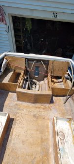

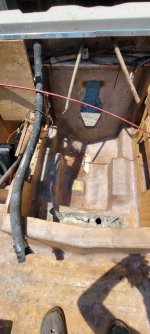

I just took these today after a little cleanup. I'm at the console with some smoothing before I last a layer of 1708 on the floor.

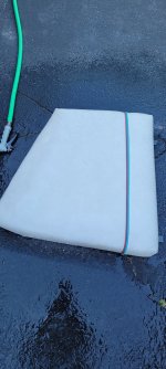

A little premature but since I'm working on getting more money together for more supplies I brought one of the cushions from the bow to see how it would clean up and I'm quite pleased with it considering it's 33 yrs old. The entire bow upholstery is great other than one cigarette burn but gets more worn as you head towards the stern and with its age is still awesome compared to others of the same vintage for sale.
I used Wesley's bleach white a couple of times.

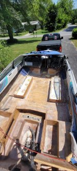

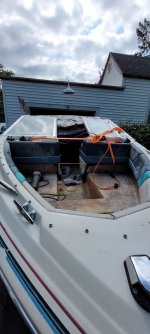

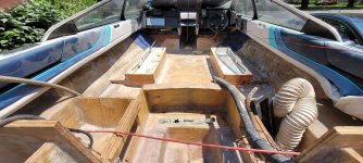

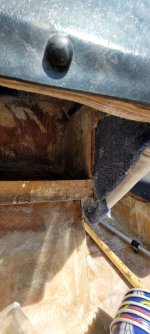

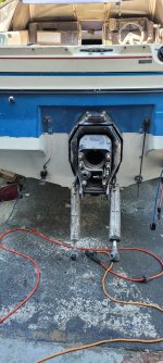

Another noob mistake discovered! When I repaired under the consoles it splayed a bit so now I'm down to doing this before final adjustments on the windshield. To my defense though the shelves underneath were rotted so that didn't help I'm sure 😉

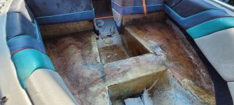

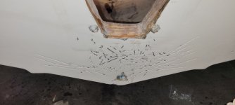

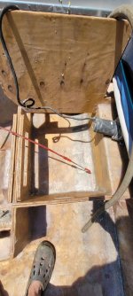

Bow is all reinforced, I couldn't believe that there were stress cracks here!
Finally my glassing is looking like it should......transparent!

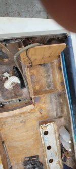

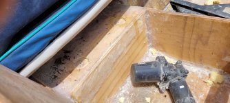

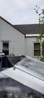

Really no cooperation from the weather last week and this upcoming week to do any glassing between the deluge of rain a couple of days ago and the up to 3 inches they're expecting starting this afternoon.
There has been this issue with the misaligned windshield that has annoyed me since day one but I finally figured out where the screws are!
You actually have to pull the glass partially out to pull the bottle seal and that's where they hid those blasted things so I just wanted to share my triumph 😊.

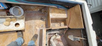

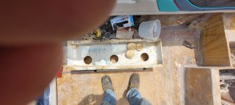

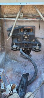

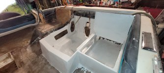

Well I backed as much of her in the garage as I could with the rain but I have all the glass finished.
Ground out the cracks on the gelcoat for the transom and will be using the fairing putty on it and the floor today.
I hope to put the non-wax gelcoat on the bilge area today.

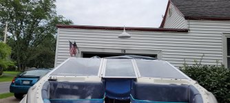

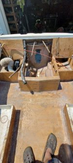

Will using the ratchet strap work to reduce the splay in the hull? Meaning, once things are glued/glassed back in, will it hold the less splayed shape? I have the same issue with my windshield, probably from mother nature removing most of the wooden supports before I acquired it. . My quick and dirty option is just to remove the center glass, but since I have the boat gutted, I'd like to try to get it right.
88 Capri (2022 SOTY)
Master Chief Petty Officer
Aug 25, 2019
864
Pulling the hull helped some but the issue that created the biggest problem was that the shelves under the consoles had rotted and didn't realize it till after everything was set.
What I eventually did was get the windshield assembly straight as mush as I could by jacking them up and getting them plum from one side to another than I replaced the shelves and made supports to hold the windshield in place.
I did have to adjust them still but not near as much if I hadn't do the fore-mentioned things.
On my boat the pass through interior is what held the windshield in place and that had also become weak causing issues also.
