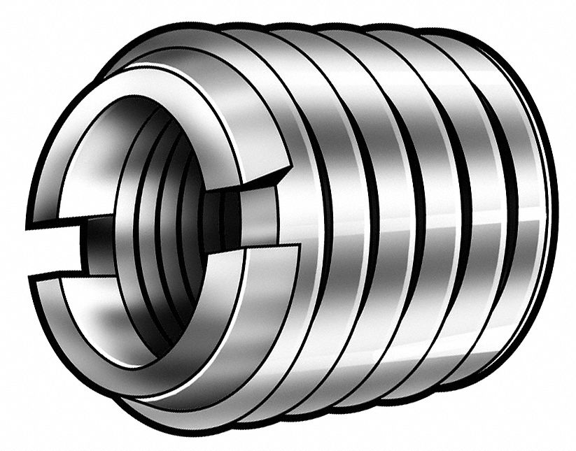

Make sure the tank compartment has drainage to the bilge. You WILL get water in there from the hatch. I would use stainless bolts and stainless threaded inserts... I'd also try to devise some kind of rubber seal.

Yes there is drainage to the bilge 014 (4).jpg This little "mouse hole" allows the water to drain to the bilge, but I think the water would get into the tank area even if there wasn't that hatch. Hey those threaded inserts are the way to go! ;) I think I'll attach that hatch with them. But how about the rest of the deck, should I screw it also?
