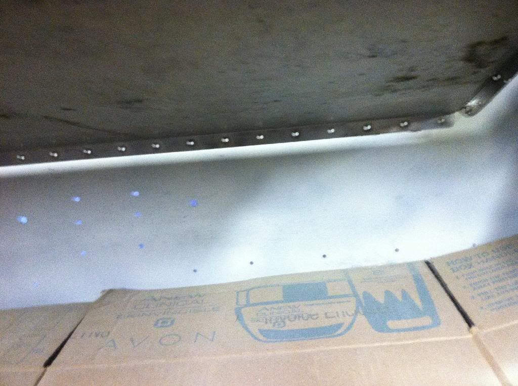

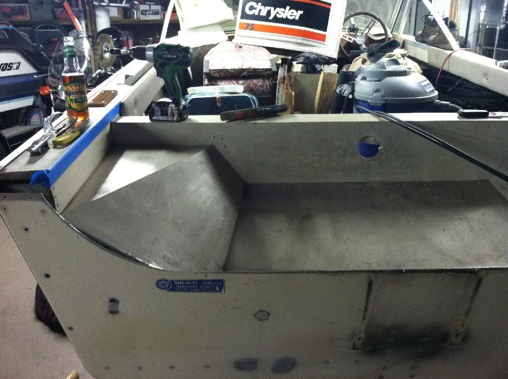

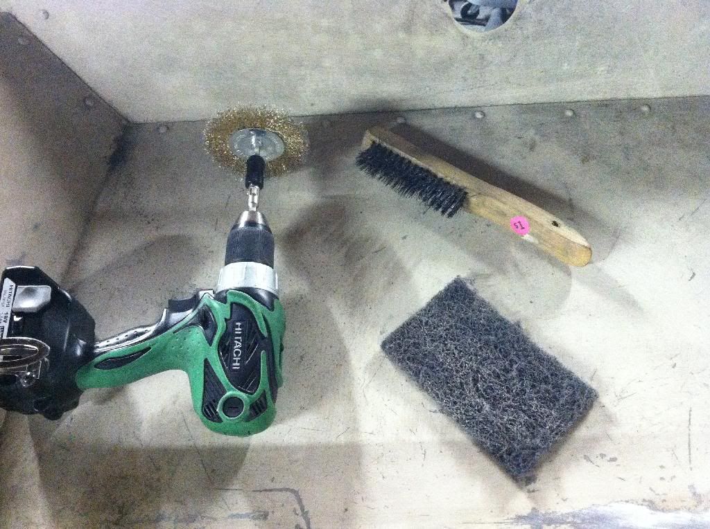

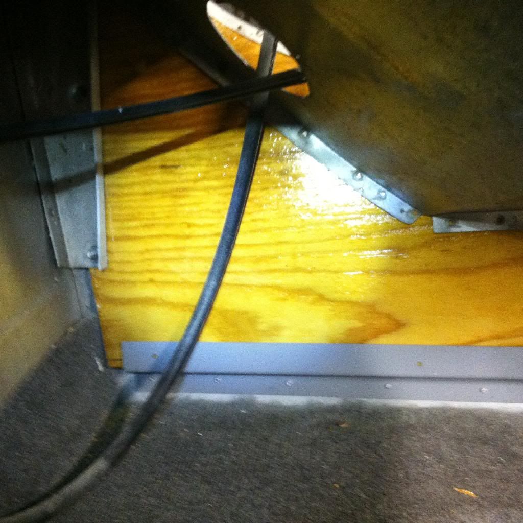

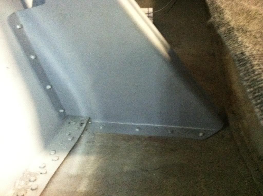

Got some cleaning, and sanding done on the splashwell as well.
The tools I've been using.
I'll have to get some gluvit before I can do much more than just sanding and prep work. Till then thanks for stopping by.'

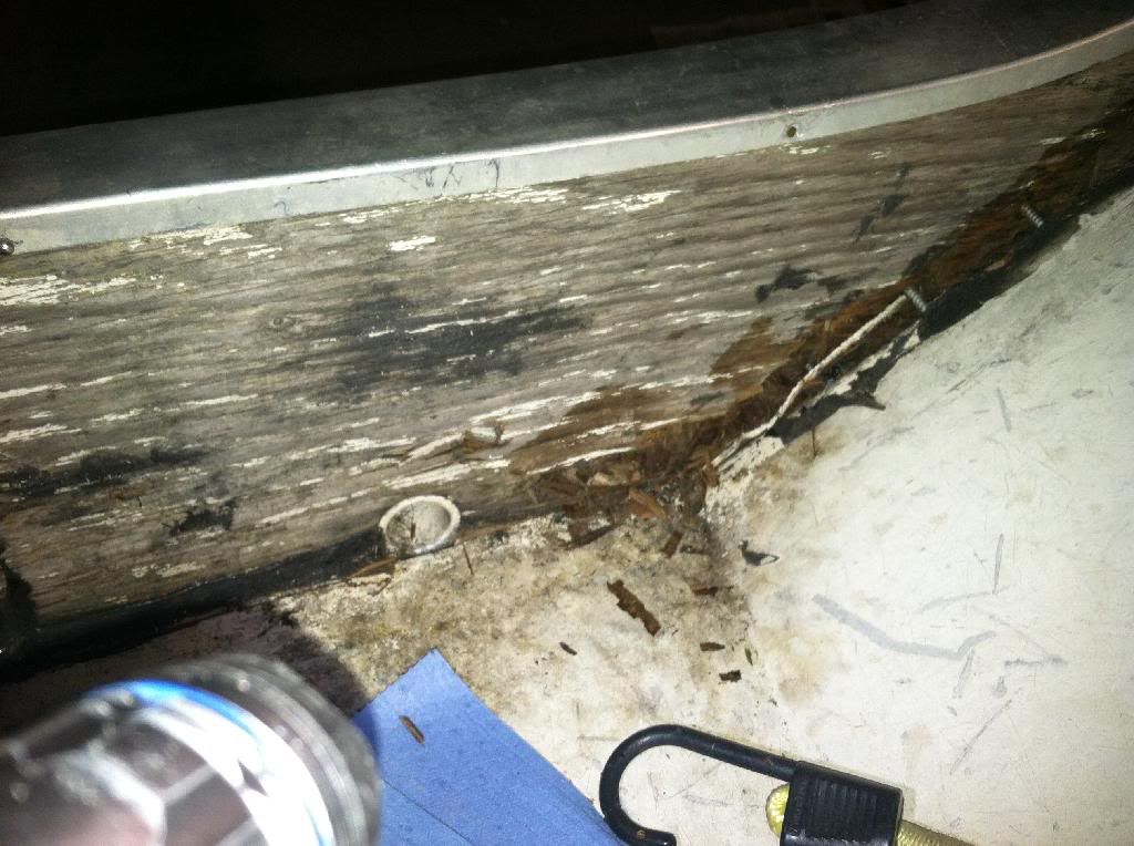

Having water sit in the hull thru repeated freeze~thaw cycles is usually what kills foam.
The foam below decks now appears to be similar to what many vintage SC's had from the factory: white bead styrofoam like a cooler.

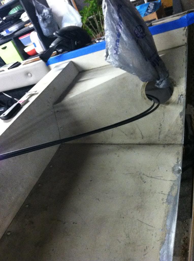

Re: Replacing my 16ft SS Starcrafts Transom
You got good wood, Dave. :smile:
I hate that styro (misused beer cooler) foam. It crumbles and plugs the limber hole, clogs bilge pumps and switches and generally makes a mess. And it also holds water. The junk under my deck smelled, too. I prefer the closed cell sheet insulation from the big box. It stays together and is impervious to water. So I recommend tossing the styro for the sheet foam.
On the splashwell, since you are doing some new rivets on the knee brace, I would make a 90? angle to fit behind the separation and put a couple of rivets on each flat. I think that's a sealed seam anyway, but the added angle will stop the spread. And maybe when the brace is reattached and the transom wood is in place and secure, the gap may close on its own. I'm fairly certain the loose brace caused the split.
I've forgotten, Dave - Are you replacing the floors? Sorry, these threads start to run together after a while.

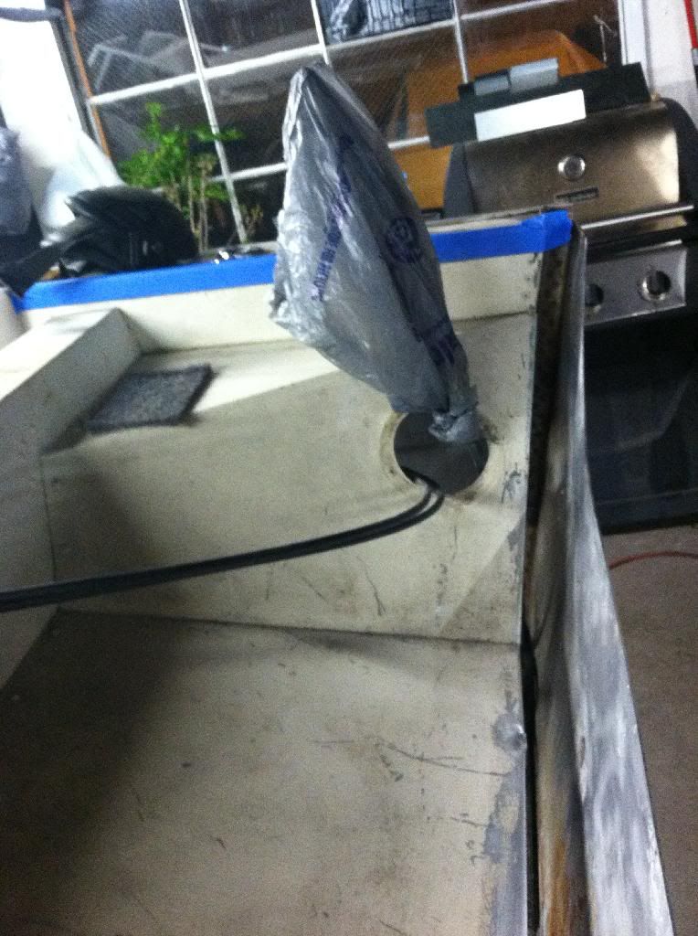

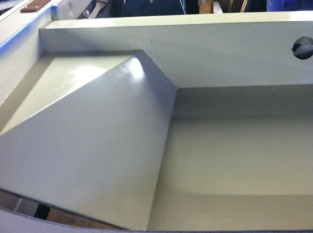

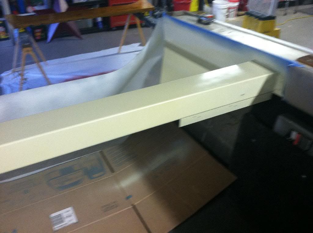

Got some more work done this weekend. Got the splash well painted.
Primered the inside of the transom skin.

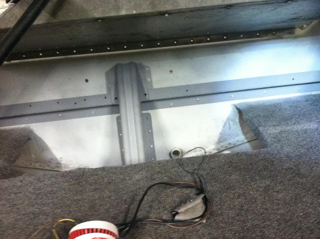

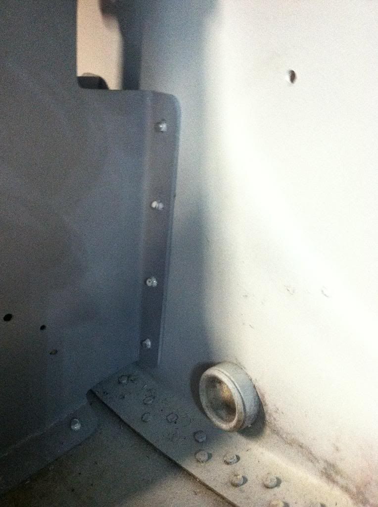

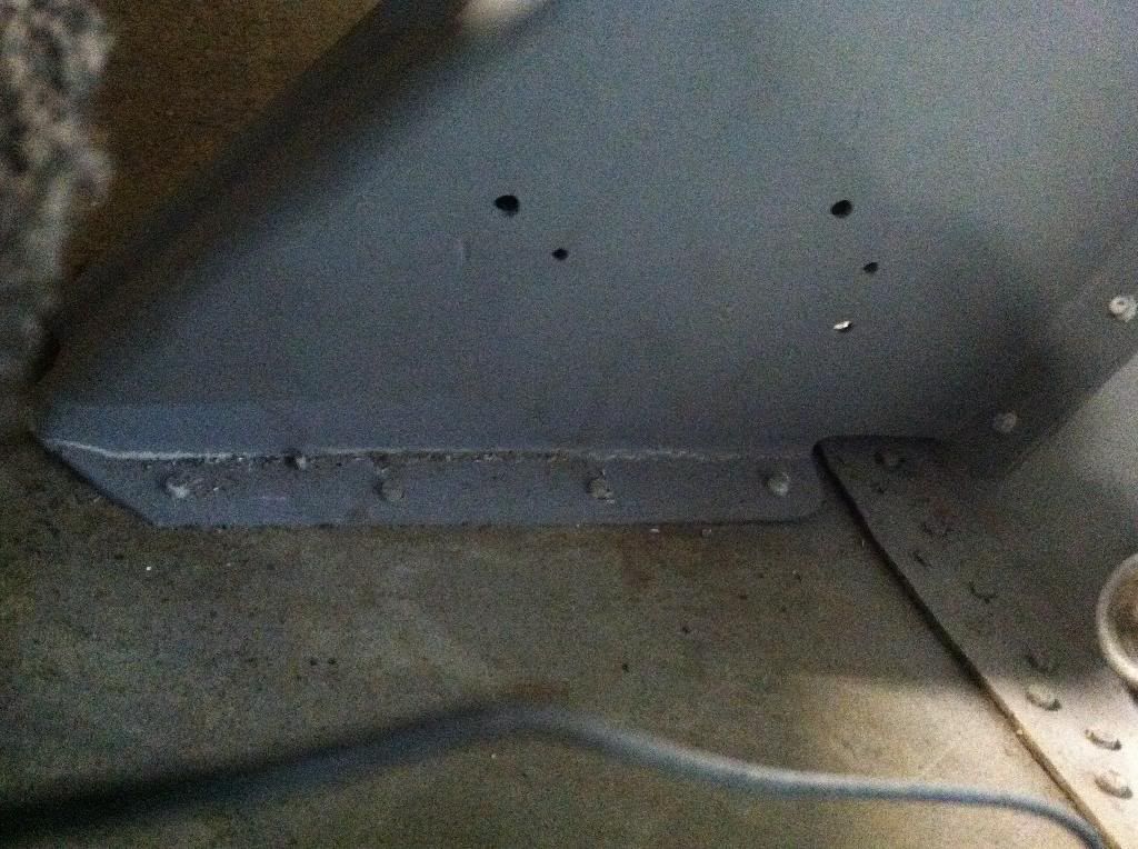

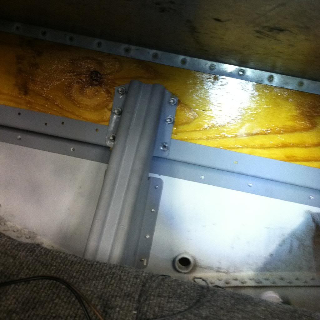

Repaired some more damaged rivets. This time with 5200.:facepalm:
This is the knee brace going back in.

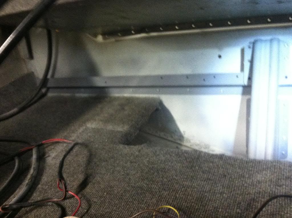

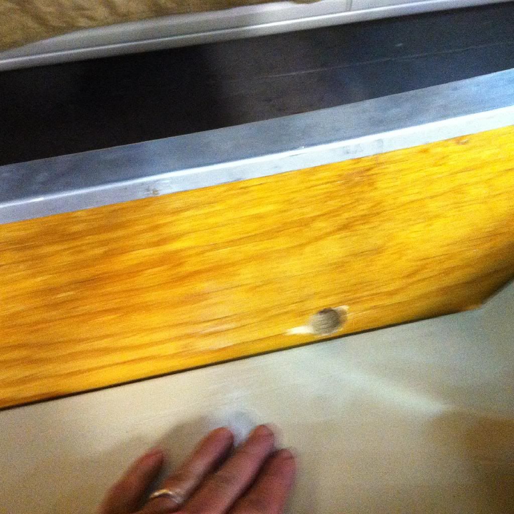

More of the knee brace. I think she turned out good.
Also got the z brace for the transom reinstalled.

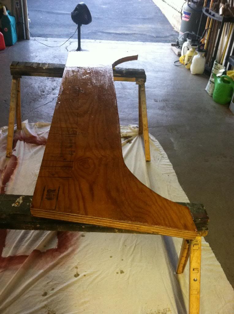

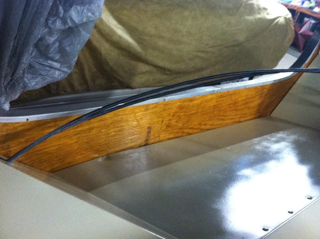

One last thing varnished the other side of the transom wood. It is finished.
The first mate said the color of the splash well reminded him of an office file cabinet. I told him it was as close to the tan I could find, and that it was just until next fall when I plan on repainting the boat in some new cool colors.:cool:
I'm going to install the transom wood tonight so that hopefully by thursday I can take her to the lake and do a leak test on everything before I remount the outboard. As always thanks for your help, and thanks for stopping by.

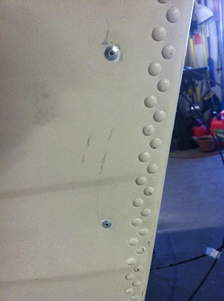

Almost forgot I have one more quick question. I'm having trouble finding 3m 4200 anywhere local. One local boat repair place said to use silicone caulk for reinstalling the bolts and screws. Another boat repair shop said 5200 would be fine. What do you all suggest? I want to do this right. The only bolts that should ever need to be removed should be the motor bolts I guess. Will 5200 be okay for them?

I can't find 4200 locally either, so I used 5200 for all my bolt & rivet sealing. You will be able to remove the bolts if you need to, it will just take more effort.
The general consensus is that silicone caulk doesn't belong in a boat....I agree with that. I became an instant believer as I tried to remove it from mine when I started my project! It doesn't last, and causes a lot of cursing! :laugh:

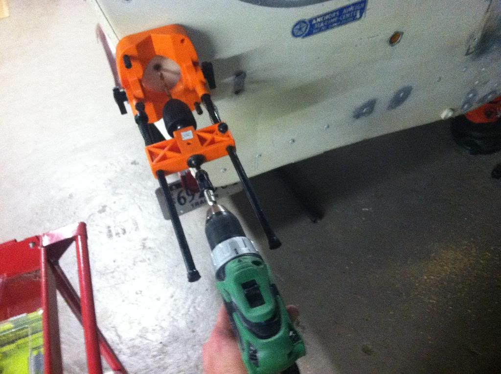

This is what we got done tonight. Transom wood set in place.
Drilled all the bolt holes except the motor bolts, and the tie downs. Used my new drill guide.
If you don't have one get one. They work really well.

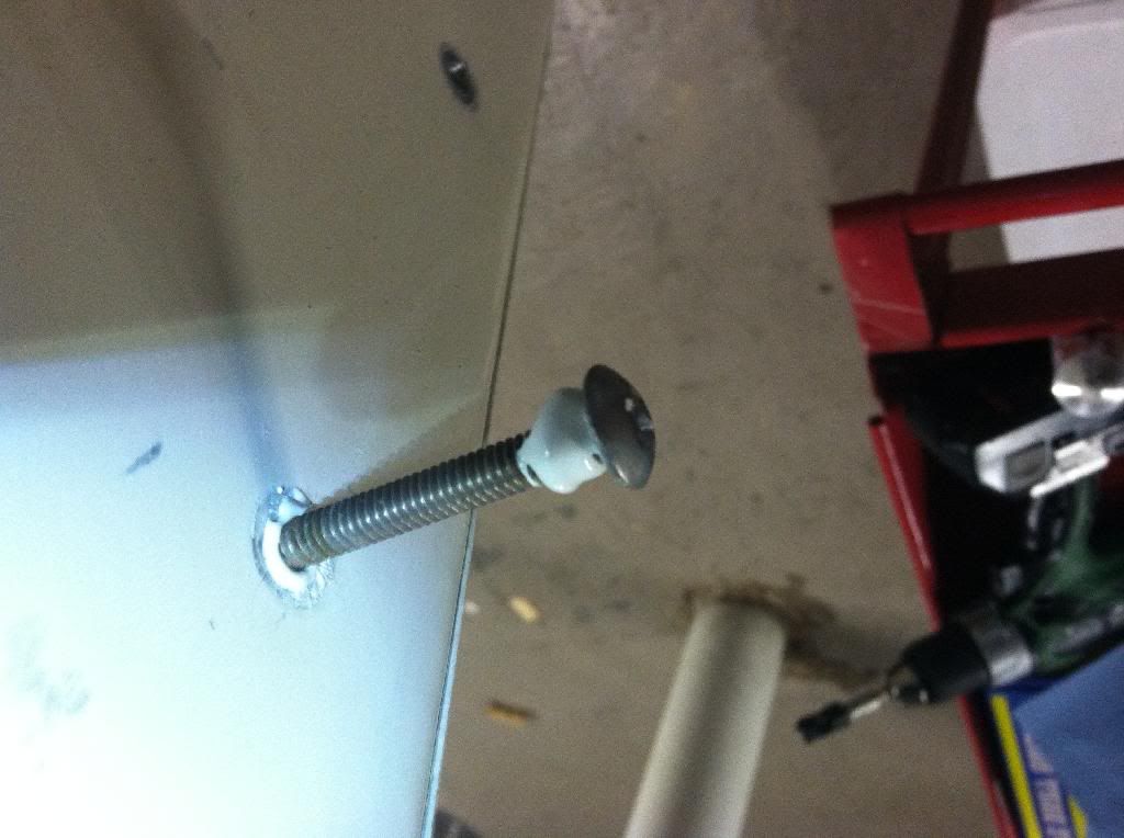

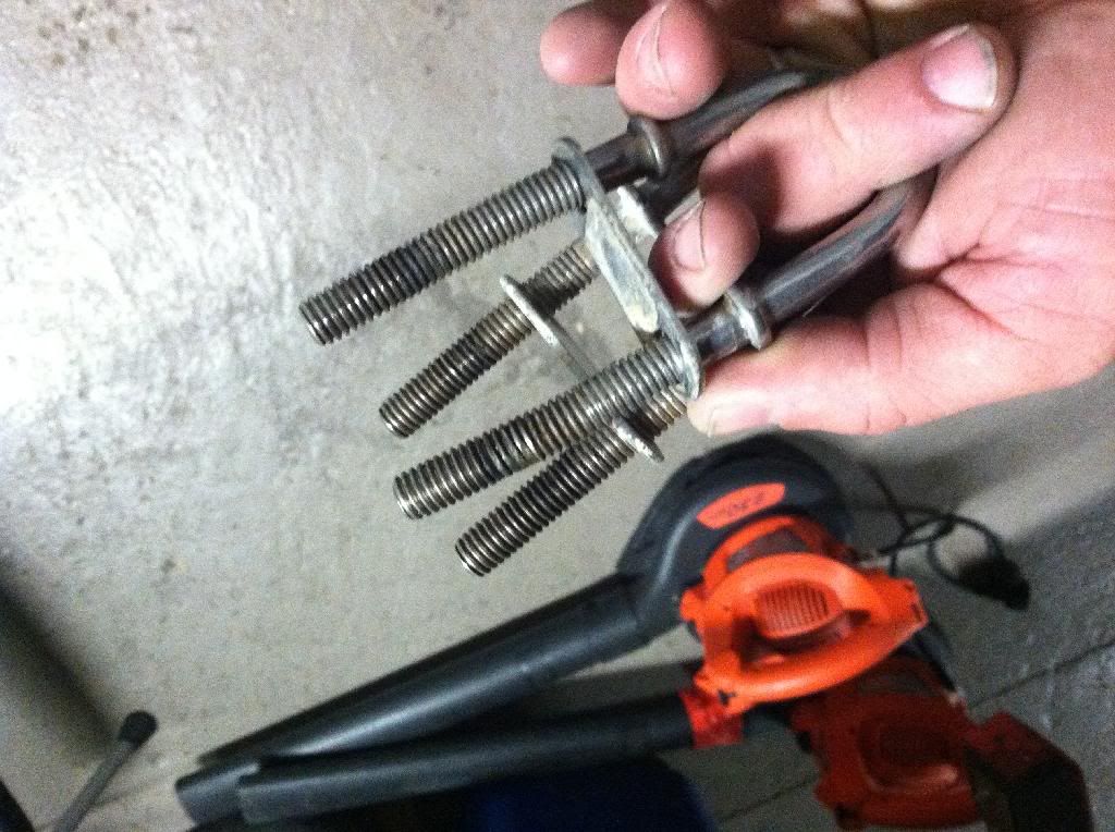

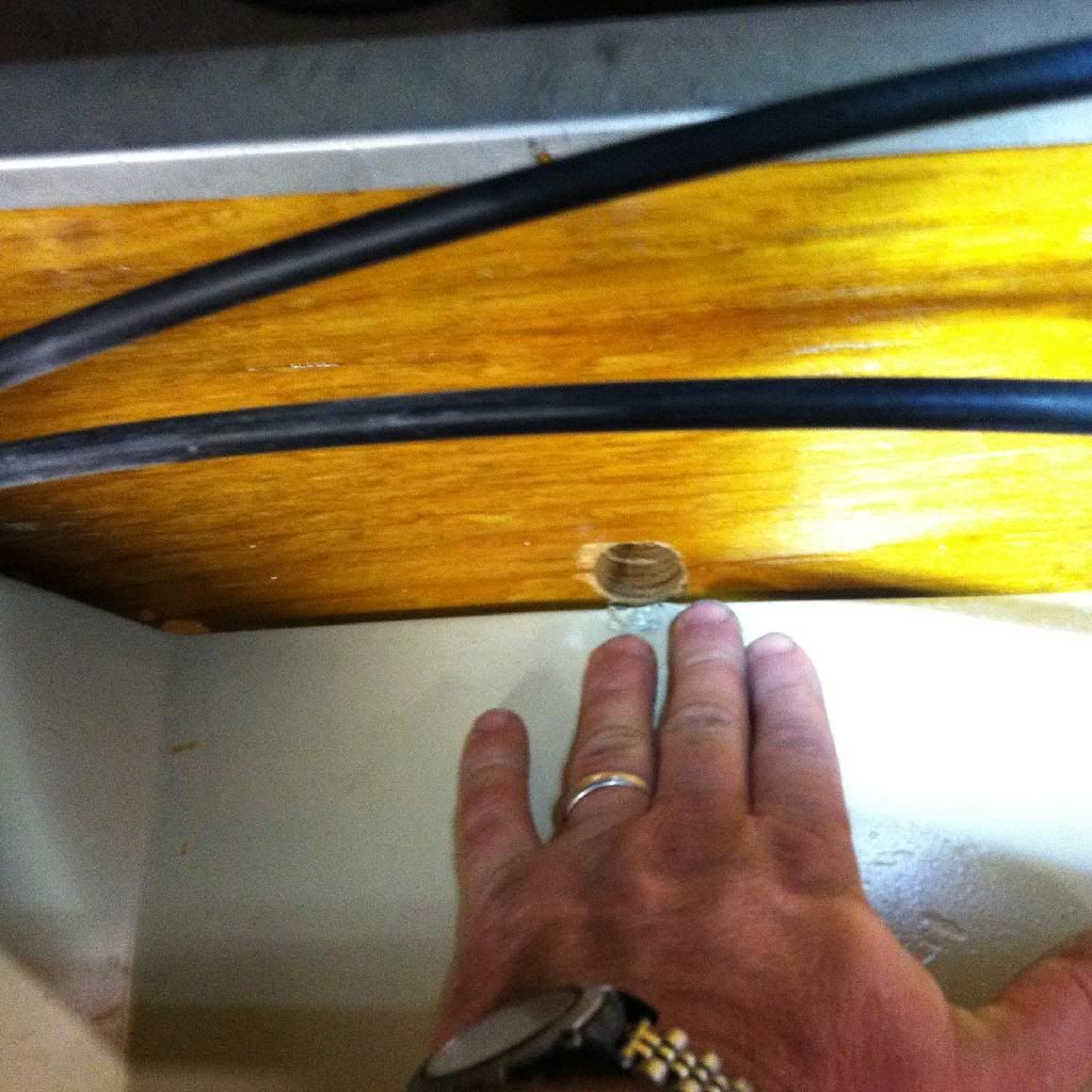

Installed all the through bolts into the side supports, and the knee brace.
I put 5200 in the holes, and on the bolts as well.

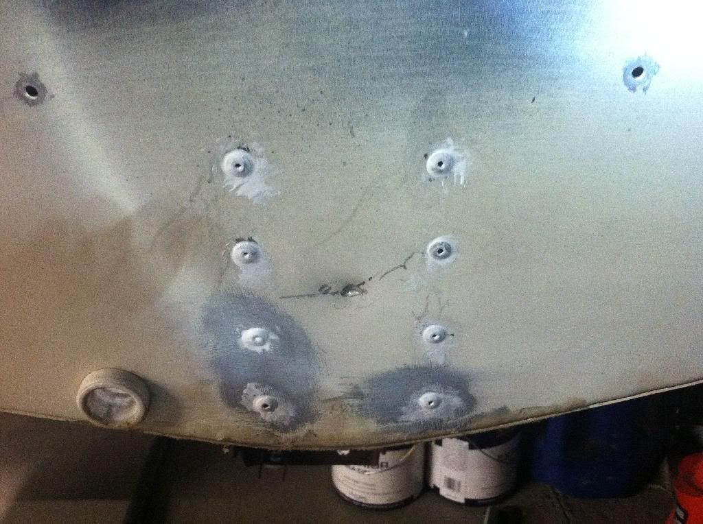

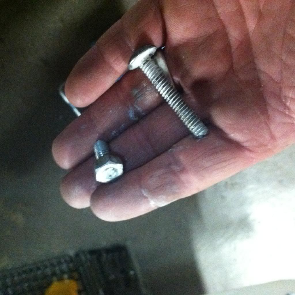

Got the splash well drain holes drilled as well. I have to make a tool to install them. I've got to find the thread or instructions here for the tool.

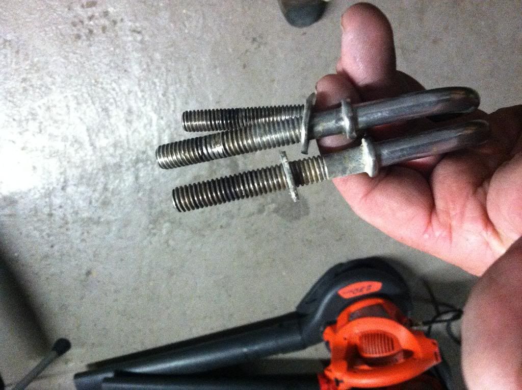

Everything wasn't a complete success tonight. I did manage to break one bolt.
I'll pick up a new one tomorrow. I also need to get two new tie downs the two I have are pretty bent up.

If you have any aluminum plate, metal backers for the tow/ski eyes is a good add for the inside of the transom.
Here's the flaring tool you're looking for:
GO SLOW, and let the nylock nuts curl the edges of the drain tubes.........
