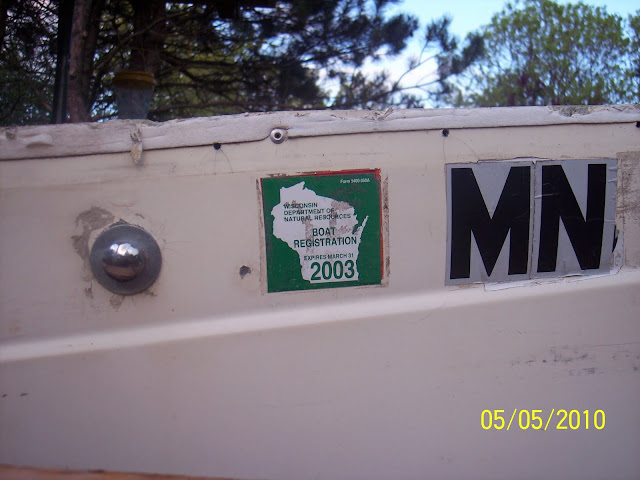

Hey, guess what I found out....my boat was a former Cheesehead! Blasphemy!

Never! Actually, I think the boat is originally from Iowa! :eek: Talk about a confused boat!
