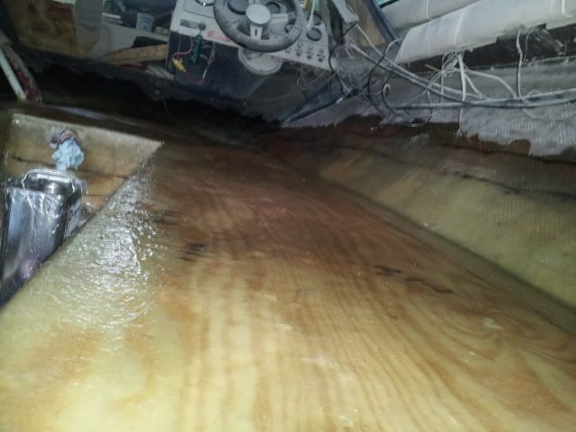

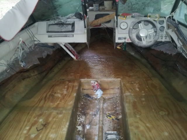

I rushed through the tank tabbing and got a few bubbles in it, but they are cut out and repaired now. I'm running the csm layers 6", then 9" down into there too, so I'm hoping this thing will be rock solid. The original stringers were (I guess) 1/2" ply, and it looks like it was barely 1/2", maybe more like 3/8". It also appeared to me to be all chopper gun glass on the original stringers, and not awfully thick. I now have 3/4 stringers with two layers of 1708, and all that 1708 overlapped to cover at least one layer over the entire hull below deck. Original deck was also half inch, which is now 3/4 also, tabbed with 1708, then two layers of csm. I'm hoping she lasts me, and somebody else, a long, long time.

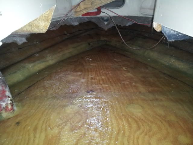

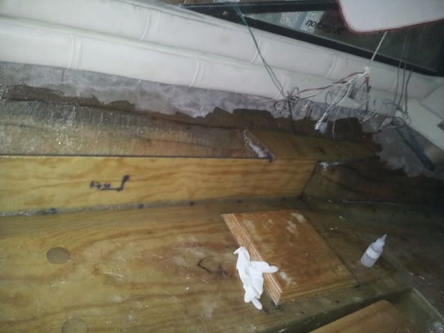

I remember when I was here. I never thought I would see what I do now!
I think I can use the old wood for a template.
Wood removed.
Samded on it some with 40 grit and an orbital sander. Pretty much just polishes the glass .

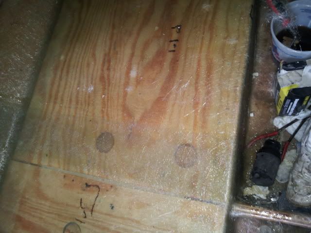

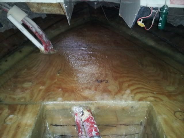

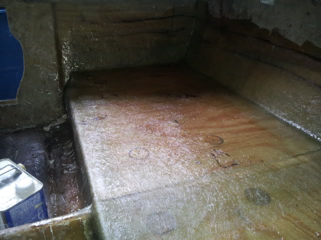

Got the deck glassed today!
I started by sweeping and blowing it off with compressed air. Then I sanded the whole thing with 60 grit and a vacuum hooked to my orbital sander. Its been very rainy lately so I wanted to sand off the very top of the wood in case damp air was getting to it. Then I swept again and vacuumed the whole thing. The final prep was liberally washing the deck off twice with acetone. I mean I really drenched it. Then I waited 30 min before I began glassing.
I had my glass all pre cut and marked so I knew where each piece went, and which layer it was part of. I rolled on resin first, then waited a few minutes for it to soak in. Glassed in the first layer, ate lunch, then glassed in layer two. I used in the neighborhood of 5 gal of resin and it took about 5 ? hours, including breaks.

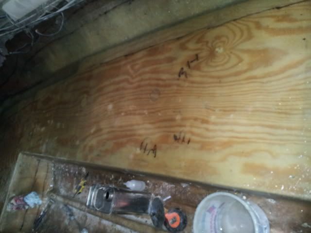

Re: dixie hustler "deck job" (turned full rebuild)

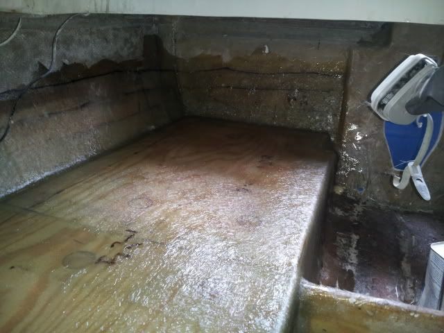

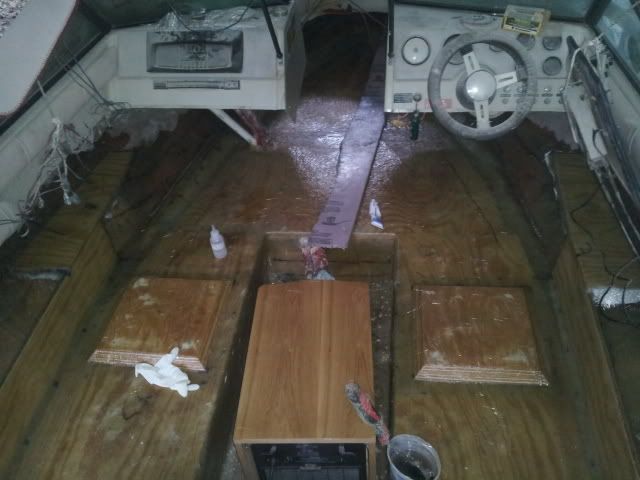

More eye candy.
Joints looked like this. Have two main ones that will be visible.
I know it looks like bubbles where the csm laps down onto the tank stringers and bulkhead, but that is just the white color showing through from some pb made with flour. It really made the bend quite nicely all around. The csm is a pain to handle and move around, but it wets out much easier than 1708, IMO.
All the little white spots are sweat drips. I tried to keep them to a minimum, but it was 85? and I was soaked through all my clothes.
All in all I think it looks good and will work well!

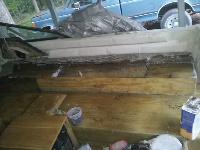

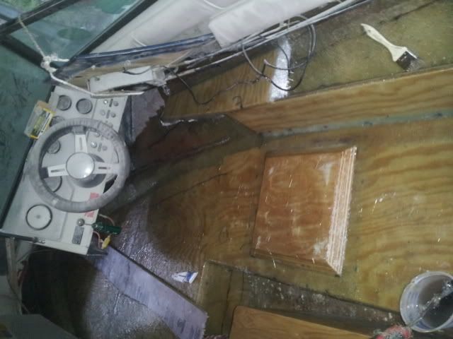

Built and glassed in seat pedestal mounts, built and glassed in my side "panels", built my motor mounts, and diagnosed and repaired a clutch master cylinder that took a poop on me during a "10 min trip to the store". Did not enjoy driving my truck several miles in traffic to o'reillys with no clutch pedal!
Any who pretty productive day!
I sanded and sanded under the seat mounts, but just wasn't happy with the way they sat. The glass isn't perfectly level under them, so I optep to screw them as well as glue and glass. I predrilled the holes, filled hole with 5200 , and topped with pb. Shouldn't cause any problems.
I coated the backside of my panels with 4 coats of spar urethane. I would have rathered use epoxy, but I have plenty of spar on hand. I attempted wrapping the csm around the ?" ply....just wasn't happening. So I'm gonna sand that off and fix those edges.
