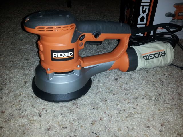

Look what I found in my truck! This one has a 4 amp motor, and adjustable opm. The biggest reason, though, I think this model was put in my back seat :p, is it has an adjustable orbit. Adjustable from 1/8 to 1/4". I believe on 1/4" it will really do some sanding. If it isn't worth the money, I can take it back. Gotta speed this thing up! Hopefully it won't sling glass all over me like when I sand with the grinder.

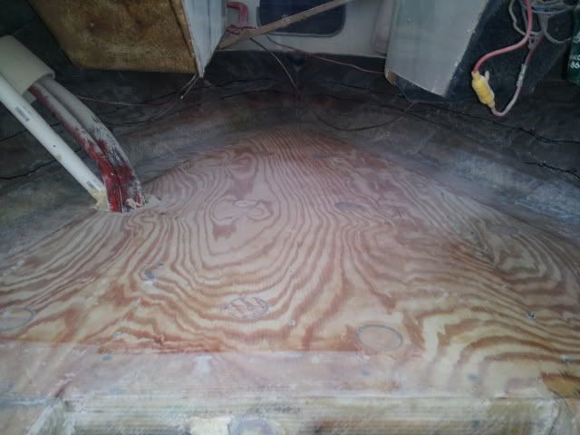

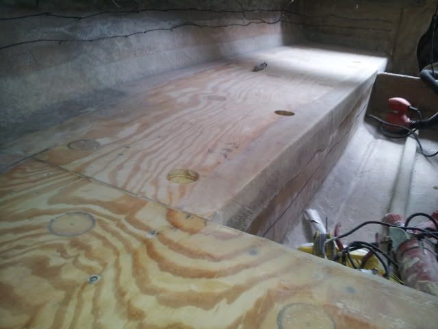

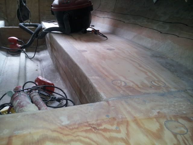

Ha ha. Have an update. Not a big one, but progress nonetheless. Today, in report, doesn't seem like much, but it was a good full day!
Finished sanding my tabbing and making the edges of the tab transition gradually to nothing. Then sanded the whole deck. Cleaned all the dust out of the boat and vacuumed up. Prepped the last remaining foam holes and replaced the pucks, then I cut out both layers of csm.
I will have to sand the last few foam holes in the morning, vacuum and blow the deck, acetone, and I think I can start glassing the deck! I hope I will have time to glass both layers tomorrow. I haven't decided whether I will use 6oz as my finish layer. I think I'm going to glass 2 layers of csm, then see what it looks like. If I don't think it will sand and gel attractively, I'll do a layer of 6 oz. I'm thinking of leaving the csm, and using 6 oz on my side panels (which will pretty much only be about a 6" high wall placed a few inches away from the hull sides, to create a place to catch flip flops, sunblock, etc).

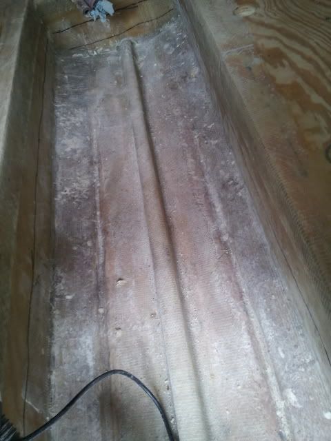

This rascal was difficult to glass, to say the least! Two layers of 1708 over it. I will 5200 strips of plastic over the wood strip, as well as on each side of the bottom of this tank compartment. Then glue the tank to the plastic strips with 5200. That will attach it to the hull, and allow drainage.

I forgot to take a picture of all the csm laid out on the deck, but I'm sure you all get the idea there.
