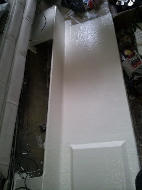

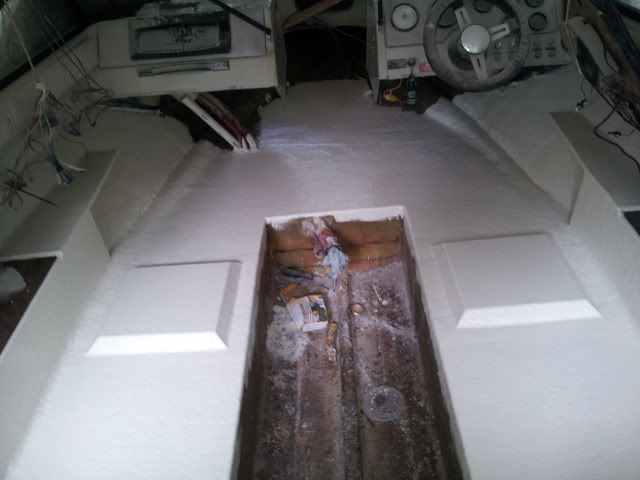

On your final coat you might try not thinning it and then using a large plastic putty knife to spread it out smooth. If you take your time you can get a really smooth coat and only have to sand down faint ridge lines left by the knife. Doing this give you a thicker coat and allows you to sand a bit better without te fear of sanding through the full layers. Something ondarvr talks about here on the forum.

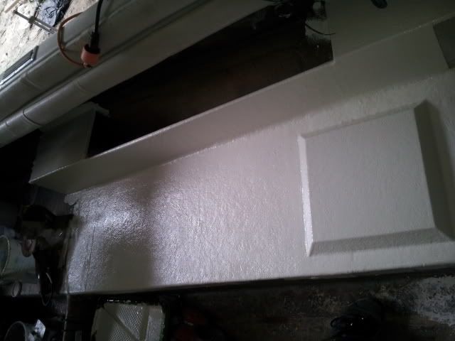

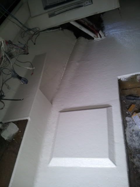

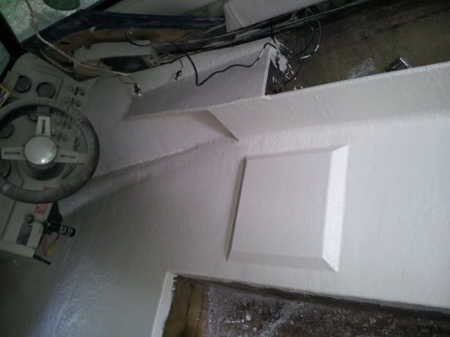

I sanded and sanded and sanded this morning. Finally ran out of sandpaper and said I'll go with it! I got lucky with my csm seams. The rear seam will be under my bench seat, the front seat bases covered most of the middle seam, and the front seam is way up between the bow seats. I should have sanded the front seam much more. It shows pretty badly, but it will be mostly covered when the boat is finished.
The bare areas I'm going to do with bilge coat, since they will barely be visible and it's much cheaper.
Does anyone know if the tint I used for the gelcoat will work for the interlux bilge coat I have?
She's starting to look like a boat!

Uhhmm I doubt it since Gelcoat is Polyester resin based and Interlux Bilgecoat is paint. But...I've been wrong before!!!

Thats what I was thinking. Wonder if I can tint it another way. I didn't get your last post until I was done. I've read about that process before. I like how it turned out, though, but I'm sure squeegee-ing would have made it better.

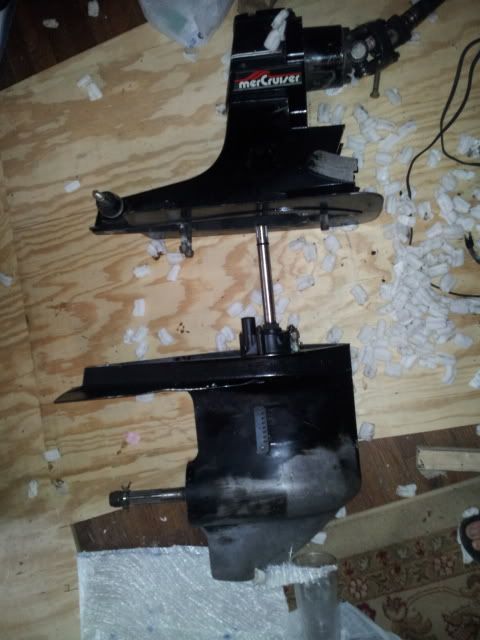

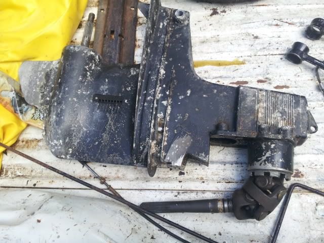

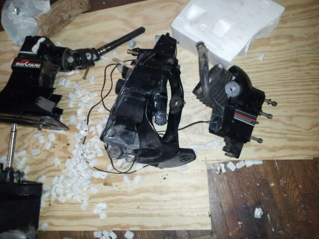

I have a little surprise! My outdrive was tired. It was in decent working condition, but bellows, along with lord knows what else, had let water inside it. It needed to be pressure tested, and who knows what that would have told me. I'm sure it could have used new seals all around. It needed to be sanded and painted, the studs were broken off into the gimbal housing, etc. I also think it needed new u joints.
Well shortly after receiving a quarterly bonus at work, I ran across this little jewel! It pressure tests well, and looks good inside. Had a new water pump installed before it was put up for sale, and the gimbal bearing supposedly isn't very old (though I'm going to grease and install my new one anyway. It was missing two studs, but none were broken off inside it, and it looks loads better than mine did. All for 450$, and I was able to keep mine. Not sure whether to hang on to mine as a spare, or drill out the studs, clean it up, and put it up for sale. It shifted and drove fine for me before I took it off.

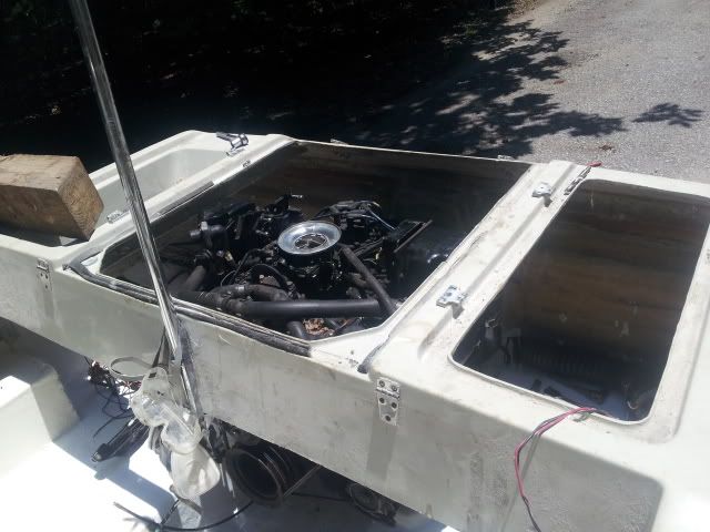

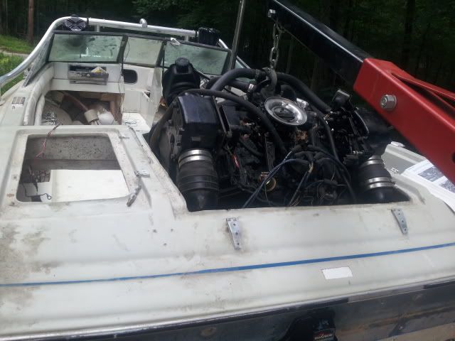

Still haven't hauled her off to get a bath, so no full body shots yet. But here is a glimpse of what I've been doing. I laid two layers of csm on my hull slice from the outside yesterday and sealed up my key hole with a few coats of epoxy. That gives two layers of 1708 over the slice, as well as two more layers from tabbing on the inside. Then two layers of csm on the outside. So it shouldn't ever be an issue.
Today, I fought bellows and a gimbal housing!:grief:
I got the bellows all on and the two halves of the gimbal housing back together, and installed the shift cable tube without the core. Bolted the gimbal housing and inner transom plate on.
Tomorrow I hope to get the motor in, aligned, trim and steering all hooked up. Maybe Thursday I can wire everything up and get a test fire in?
Any tips on motor installation/alignment and getting the trim system setup properly and bled are welcome!

Watched and saved! I have a pretty good thread saved from the archives on engine alignment also. I am fairly disappointed with the info the mercruiser manual has on it.

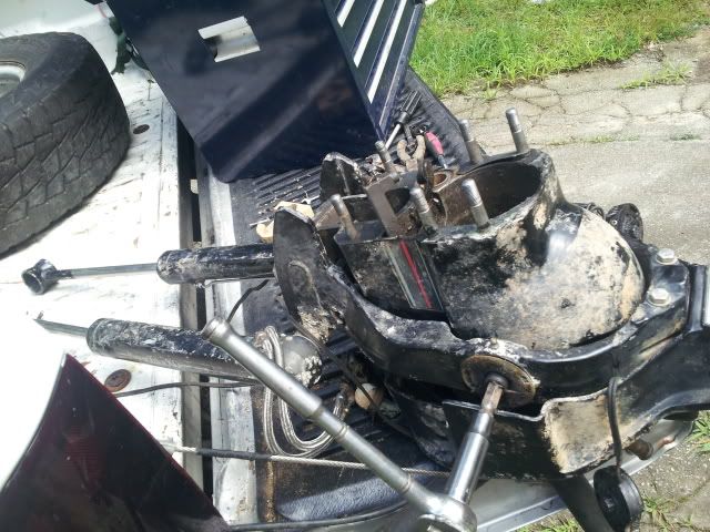

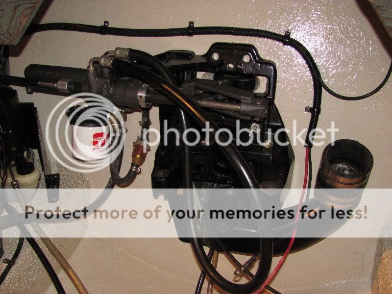

Does anyone have me a picture of the steering assembly where it bolts to the inner transom plate? (Power steering model) I can't remember how it goes together, and I didn't take pictures during disassembly because I thought it was simple enough :/.
Woodonglass
Honorary Supreme Mariner
Dec 29, 2009
25,933
Re: dixie hustler "deck job" (turned full rebuild)
Is this what you're looking for...
mwe-maxxowner
Master Chief Petty Officer
Jun 20, 2012
825
Yessir that's it. I just couldn't remember how it all bolts to the boat.

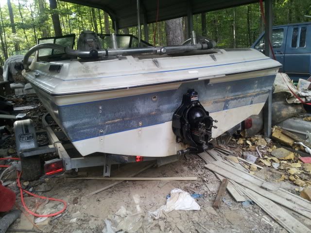

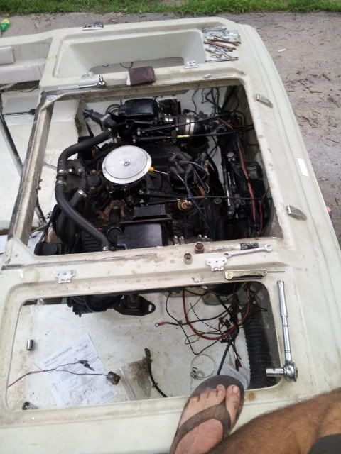

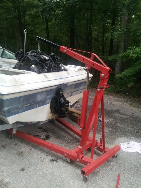

Tight fit!
As of.now complete outdrive is on. Trim is operational, steering is in (though it has some excessive play without the wheel turning?)
Fired it up and it pees and turns and trims up and down! Now I guess a water test is in order to see if the shifting and throttle are adjusted properly.
