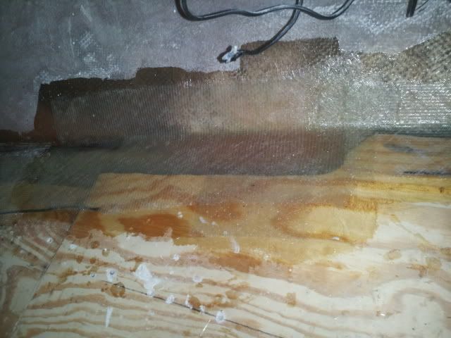

One last pic. Starboard about middle way:

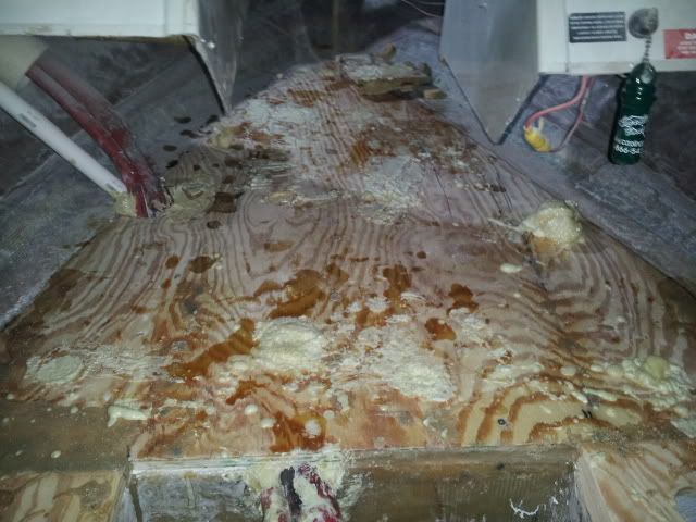

I got it all sanded nice and pretty. With a 50 grit instead of the 24 that was on there it wasn't too difficult to keep the wood nice and flat. Hot it all with the grinder, tapered the tabbing, then went over it all with the orbital.
Then I did this :heart-borken:
I really made a mess. I hope the foam sands off OK. One 16 lb kit to do the bow. Hope the other does the rest!
Foaming isn't nearly as scary as I imagined.

get a 6" stiff putty knife and it should scrape that off the deck. Or a real flexible blade on your recip saw.

On the other foaming I kept a wide putty knife handy to.scrape away foam before it set and kept it much cleaner. For those interested it sands right off too.
