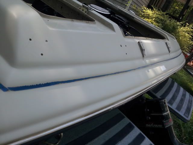

For the drips, try a hard plastic spatula with a sharpened edge, as much as possible, to pop the drips off from the bottom up...

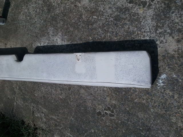

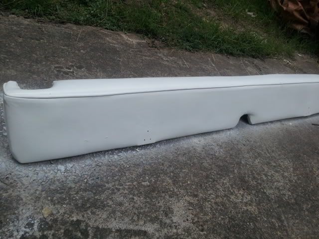

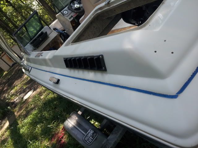

I wish I had taken some before pictures, but these two areas were stained and spotted with resin prints. Scrubbed with a scotchbrite pad and acetone and it cleaned up fairly well.
Here is one trim piece I used rusto vinyl paint on. That stuff works great!

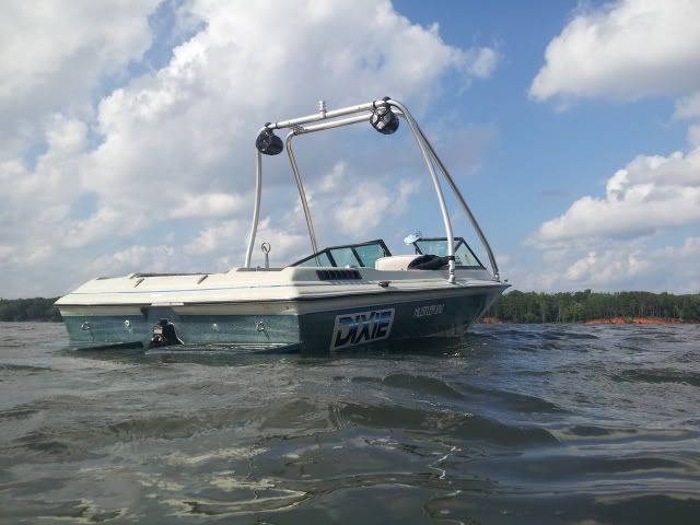

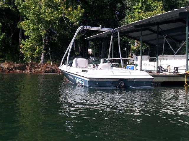

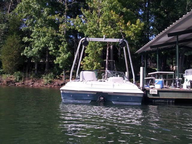

These two shots were before I cleaned the hull today, but its nice to see in the water! It cleaned up well, but it is dull.
The boat performed flawlessly. Well, aside from not wanting to idle...at all! I swear it's like I picked up 100 horses. The boat is so nimble and quick now I love it.

Congratulations on getting it splashed!
Looks sweet sitting in the water...
Nice refresh on the vinyl...saves on some upholstery work and obviously much faster.
Now that you have it cleaned up, you might try some buffing on the gel...you might get lucky and bring back some shine to it...
Don't forget about us and keep posting pics/vids of all the fun you'll be having blasting around...

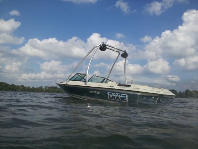

Few pics from this week! Have a few small problems. It's tough to get into neutral from drive. It is either a neutral switch or an idle issue (the idle surges some and is a little too high on the upper end of the surge). Along with the transom leak that's about it. I think the transom leak is a bad shift bellows seal, but I'm not sure yet. She runs like a top aside from the idle. Faster than before and much better takeoff.
I really like the dual swim steps on the rear. The wires to the tower speakers and the fuel tank hatch are temporary. I'm running wires through the tower next week, and eventually glassing and gel coating a proper fuel tank hatch. I'm really impressed with the 4.3. I'd planned to go with vortec heads and a 4 barrel, but I may just leave it alone now. Pulled boarders up with 4 on board with ease.
