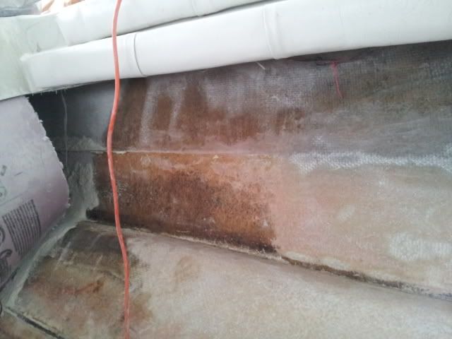

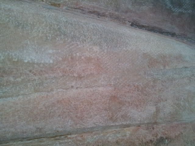

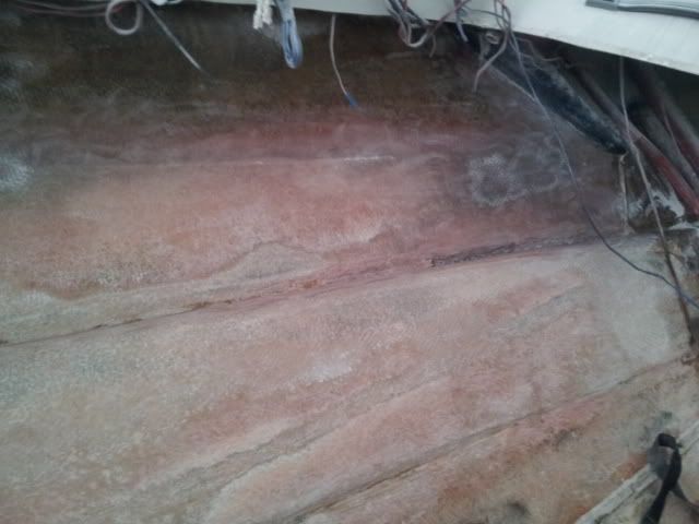

Before ↓
After! ↓
I also cut a transom template today out of pink foam. I filled in the old voids and I think I failed miserably. I think I pit way too much chopped strand in. I would wipe it on, and if I tried o smear it around some it would just start gathering a hairball of chopped strand. We'll have to see the next day I get a chance to grind on it and see if I created something that got hard and I can sand and if I kept it warm enough. If it didn't work I only wasted about a pint of resin...and about 10 ounces of chopped strand.
