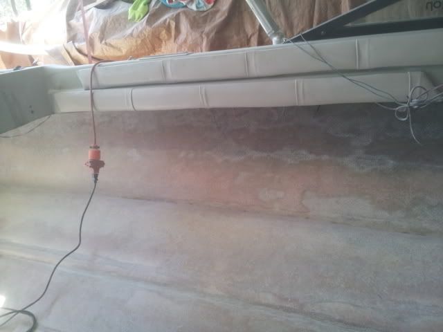

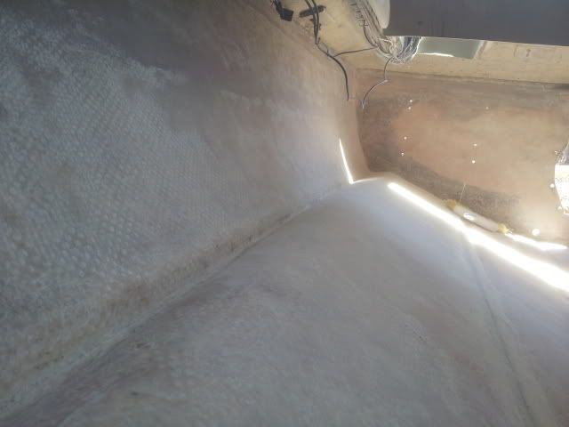

I am about 80% done with the grinding, but I had to have a break from that today. I got a late start and my truck batteries were dead at hoke depot, so once I finally got home I was in no mood to grind!
I did round the edges over pretty well with a palm sander, and may take a grinder to it for even more of a round over. I cut the straight lines at a 45 to make that part easy. I think it'll take a week to clean this thing up after I get it together!

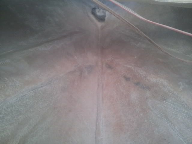

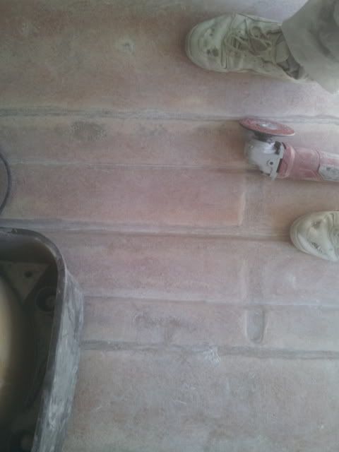

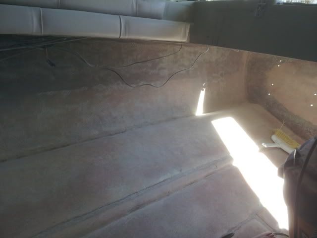

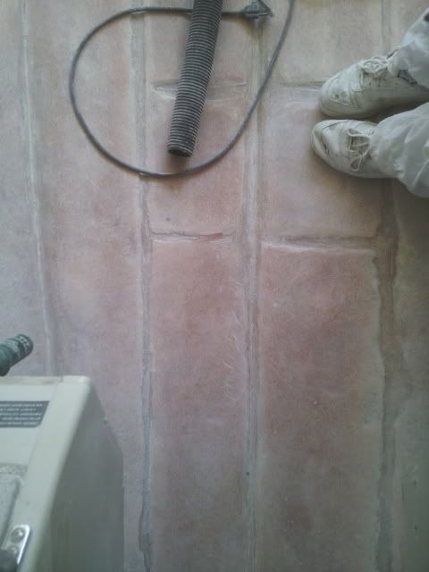

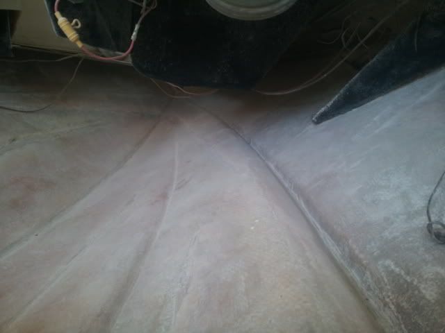

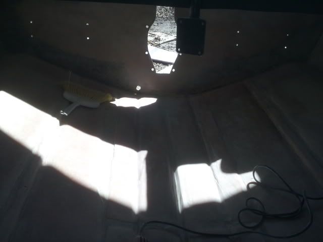

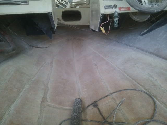

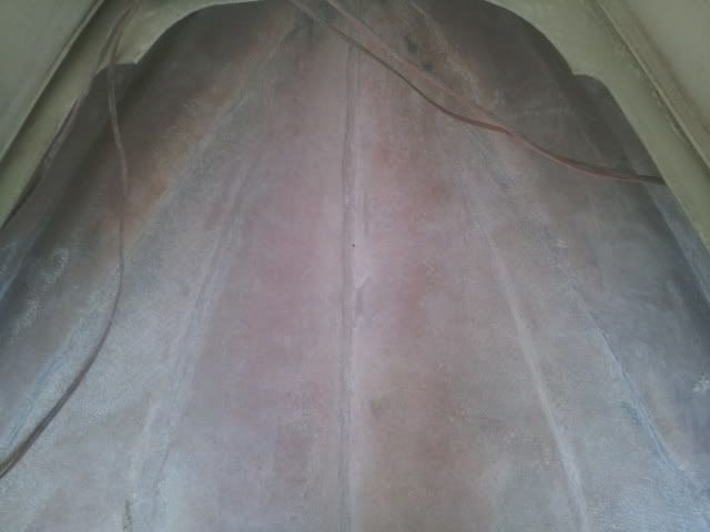

:victorious::whoo::whoo::whoo::whoo:Grinding is done, woo! :whoo: Cleaning all the dust out now and focusing on getting the transom glued in.
JASinIL2006
Feb 10, 2012
5,763
Re: dixie hustler "deck job" (turned full rebuild)
Feels good, doesn't it? Congrats!

It does feel good. And I'm right on schedule where I hoped to be. I finished up right before it's warm enough naturally to glass.

Ahhhh, the look and feel of Nice PINK Ready to go Glass. Ain't she a Beaut!!!!!
