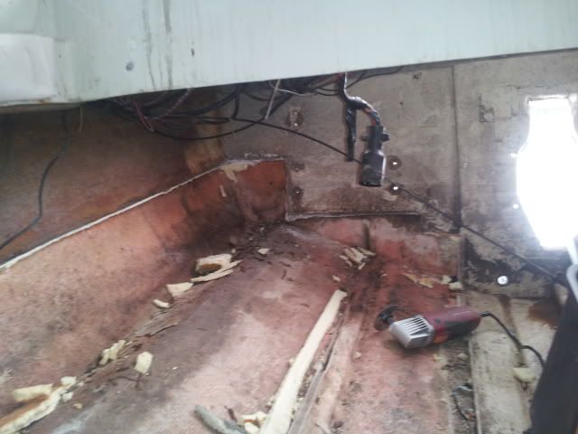

Got the foam shelves and the transom out today.

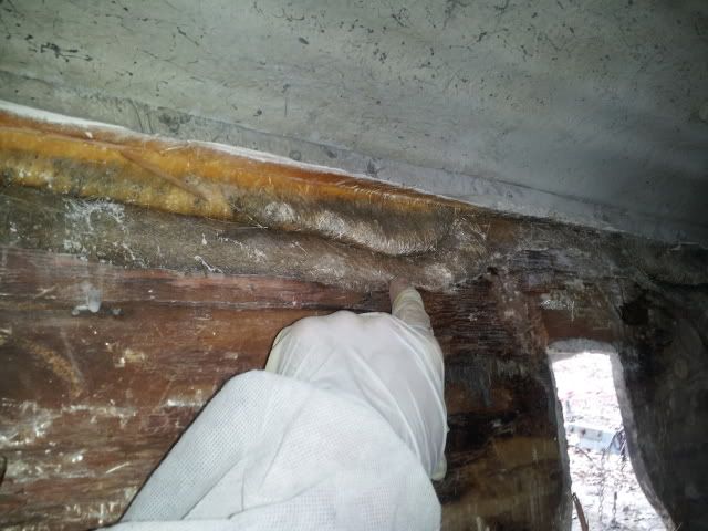

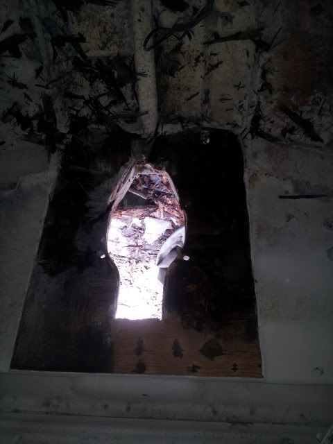

You can see a lip where the wood transom stopped in the last picture. You can also see where the hull slopes away from it a couple inches from the top and the wood was just sticking up with a fiberglass encasement.
I see no reason I can't run the top of my new transom here and bevel the edge so I don't need to go up and over the top. That line on top is where all structural support stops, methinks. It will curve back up to the top there in the middle above the keyhole.

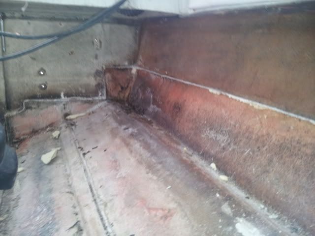

I think I can use the old wood for a template.
Wood removed.
Samded on it some with 40 grit and an orbital sander. Pretty much just polishes the glass .

You're going to need a more aggressive grinding method... angle grinder, rubber back pad, and coarser discs. The angle grinder will throw the dust out of the way and it won't build up like with the orbital sander. All the orbital sander is going to do it give the fiberglass a nice massage and polish.
