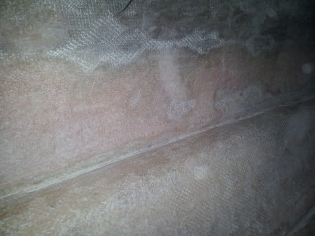

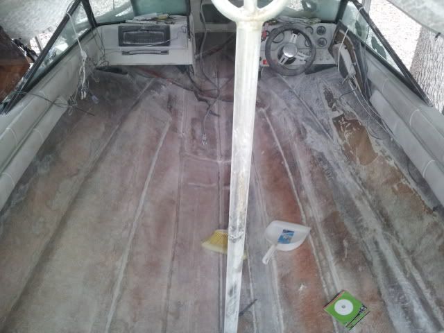

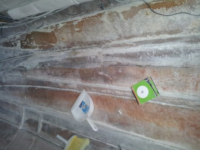

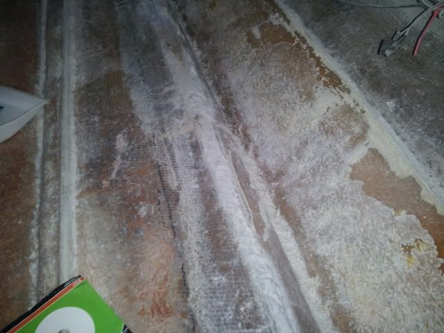

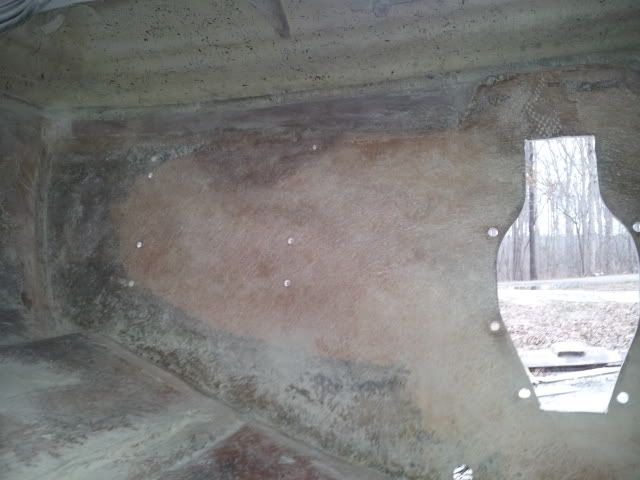

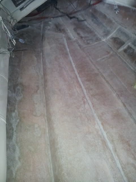

I've been quietly doing some grinding when I have time to. I dug out my digital camera today so I might see if I can get some decent pictures of this thing. The phone does so poorly in the low light, even with flash.
Ungrinded side:
Grinded side:

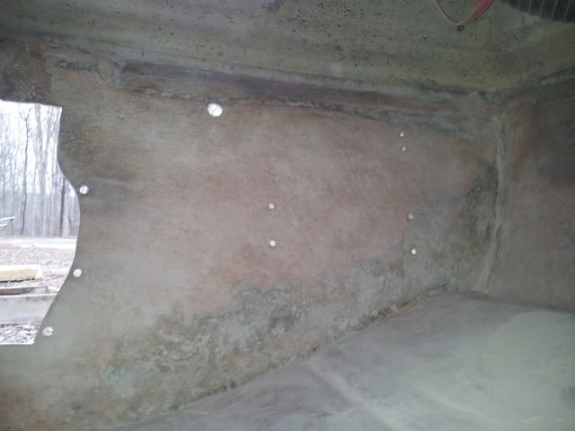

Transom:
I still have some sanding and filling to do around the edges of the transom, particularly at the bottom. I haven't done any grinding from the consoles forward, I've just been focusing on them back for now. Once I finish the other side of this half, I'll do the consoles forward. Then maybe install some wood!

Lookin' good!
You're getting there.

Thank ya sir! :D So far it really hasn't been so bad. The uncertainty before starting was the worst part. As far as the work goes I think I disliked the disassembly and removing whatever I had to to get started most of all. I think I've done a good job of suiting up as I haven't really had much of an itch or irritation from the grinding. I'm starting to wish I hadn't sold off the motor for my other boat...
There are a couple places in the groove around the edge of the transom where I just couldn't get a grinder to make contact. Should I attempt getting a wire wheel or something to it so the peanut butter will stick better, or will just a couple small spots not be an issue?

Wire Wheel on a drill will scuff it enuf. Wipe it all down with acetone and call it good. Can you post a rough drawing of what you are contemplating for the bow?

Been at it since about 8 this morning! Finally called it quits. I'm a dry grocery orderfiller for a Walmart distribution center and I'm a little sore from some friendly racing this weekend ;). So that coupled with two days of grinding was getting to me.
Anywho from the consoles to the transom is now ground! Next I'm either gonna take a break from grinding and fillet in my strakes and fix the cut in my hull, or cut and glue in my transom. Or both.

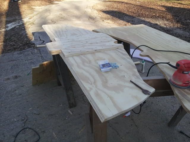

↑ Then that's what I will do! I'll drill the holes to the size of the through bolts at first to hold it snugly in place while I glue it to the outer skin, then I will carefully drill the wood out a little larger and fill with pb. Then after cure I'll drill the pb. I'd hate to discover I have a wet transom in 5 years because my holes were not very well sealed.
This will be my new transom! Thursday will be nearly sixty so I hope to attempt sealing it all around with one layer of csm.
