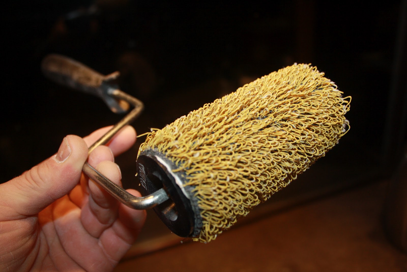

Re: dixie hustler "deck job" (turned full rebuild)
A coarse roller pad? I guess I just kinda assumed I'd be slathering it; n with a putty knife.
Edit-im thinking you meant to make the gel less slick. Doh!
Will that make the gel unattractive?
If you consider a texture like this unattractive: http://www.magnetpaints.com/Monstaliner/images/monstaliner-roller-texture_0777.jpg
It looks like there are also foam rollers like this: http://www.pickupspecialties.com/Herculiner/Herculiner_kit.jpg that may be a little less aggressive. I'd probably try out a couple things on some scrap wood and see what I liked best.
