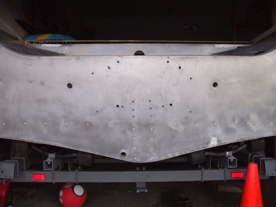

As promised...here are some photos of recent work.
The stern end of the gunwales are now bent back into place.
Knee-brace bolts have been drilled and are being shown test-fitted backwards.
The previous restorer's botched drilling made this a bit of a challenge, but they all look good from both sides now.
The stern U-bolts are bolted thru the transom with plenty of 5200.
Also a nice view of Starcraft's double-riveting from the factory.
The starboard side was cut to fit the transom with the endcaps.
I should have cut these earlier as many others have and this would have been easier.
The cast pieces fit well now and are ready to go.
