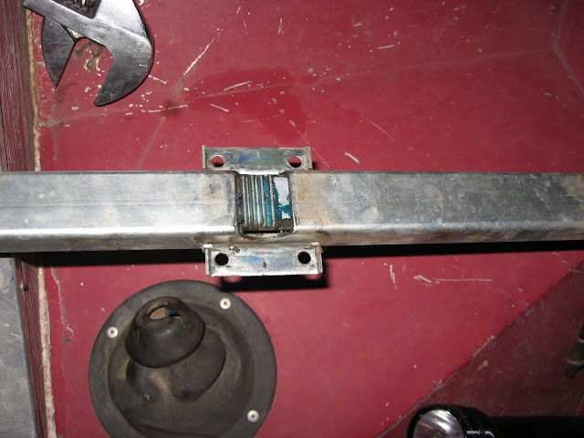

Haven't updated for a while. Got my two new rivets in and my leakage mostly stopped.
I made some (gravel) protectors for my trailer lights out of some old ductwork:
The final result can be seen in front of the taillight in the pic above (if you look close).

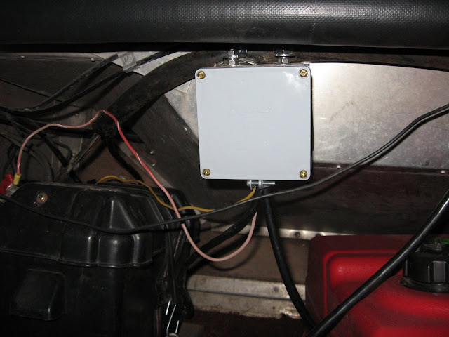

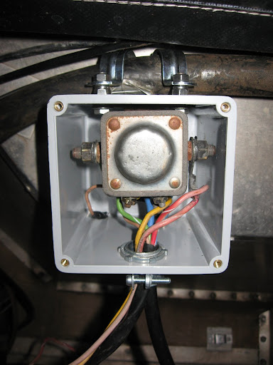

Encased the tilt/trim solenoid in a water "proof" box from maynards:
There were two holes already drilled in the splash well, so that influenced the location of this box. The solenoid should be safe from flying fishing rods and wet fingers (still need to deal with dangling wires):

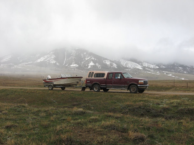

Got everything sufficiently functional to take a road trip. No on-the-lake action shot (having too much fun to fiddle w/ a camera), but you get the idea. Nice snowy day for a ride in a bowrider (actually, we hit the lake the day before this shot).
Everything went well. Hardly a drop of water in the boat after a day on the water. The motor ran great until later in the day when it started acting stubborn when I would punch it. I had to ease into it slowly (getting onto plane) otherwise it would die. I need to work on that. The first order of business will be to free up the throttle linkage (on the motor) that is fairly tightly bound by prehistoric/fossilized grease.

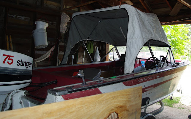

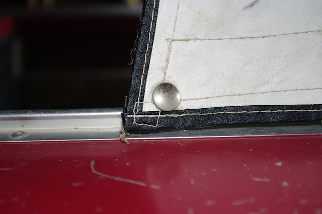

Picked up a nice used top for the boat this spring. I didn't give much for it because it was made for an old trihull and I was unsure of fit. I did a test fit today. Luckily, for the most part it fits.
The top is not pulled tight (the base of the frame is just sitting on the gunwale) but it doesn't look bad.
Can I somehow attach the buttons and deck hinge to the aluminum trim/rail on the inner portion of the gunwale without drilling additional holes? If so, will this trim withstand the stress?

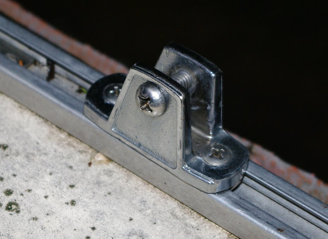

This is the deck hinge (in an adjustable track) on the boat for which the top was originally made:

Re: '77 Starcraft SS 16 (freshen)
Hope I can find something like that....fishing in the rain, woohoo
Looks like plenty of headroom, nice score!
I lucked out. I don't like the sun or the rain. But, at least I risk going outside :) Now if I can finish getting this top tied down.
Sounds like a big hassle to me...that canvas is more trouble than it's worth. Tell you what, just send it my way and I will take it off your hands:D
I need to find a nice topper just like that one. Perfect since I am 6'5" and could use some clearance.

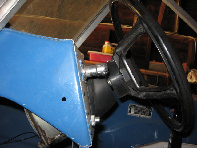

No real progress other than a partial sense of direction in seating (that shifted to steering). I was fighting trying to position the driver seat and just couldn't make it work. The boat has such a low console coupled with a low hanging steering wheel. Knocking knees! And I'm not exactly vertically challenged like HA. Here's a shot of the current mess with the most worthless old junk pedestal in the world.
I looked at my old lonestar. It has a higher console (about 6") and a steering column that tilts upward. The seat can easily sit closer with this high console. So, I'm thinking that the SS is a poor design (or at least not accidentally designed with a future of pedestal seating in mind).
The angled steering would be an improvement, but... I went and sat in a "modern" boat -- it has a low console (just like the SS), and the seat sits close to the wheel, but the steering wheel tilts... bingo. With my back, I would prefer the driver seating be extra good. So, today I took the plunge with a used tilt steering setup.
After I get that, I can get back to thinking about the seat position. I'll put in an air-ride pedestal to avoid transfering too much bounce through my spine (actually I probably won't wait too long on that).

I took the lazy way out. I decided that with the tilt steering I wouldn't have to think too hard about whether a 20 degree tilt would get the wheel up high enough - I could just set it where I like it. Eventually, when I redo the console (which is showing some signs of rot), I can mount the unit a little higher if necessary.

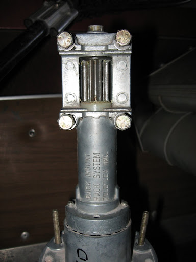

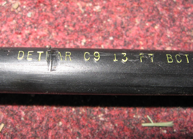

While giving the wheel the evil eye (before giving it the business with a puller), I decided that I would unbolt the cable and make sure that it would mate to my replacement steering unit. The answer is no :( Evidently I have an older style of rack cable with finer teeth. Here's the old cable:
Here's the new teeth:
Poop. The tilt wheel looks like it will almost tilt up so that it is horizontal. Cool. I'm committed to this endeavour now, so I need to find a compatible cable. Here's the old part number. What replacement cable do I need?

I'm fairly certain I need a UFLEX M86X14 or a Teleflex SSC13413, but then I blindly dove into this tilt deal telling myself "the teeth look the same... should work right?".
I'm antsy to get this new steering unit installed, although realistically I need to find a good deal on a cable. I might be able to sell the 13' detmar cable for a reasonable amount since it is in excellent condition and it sounds like they are a little hard to come by these days (since they are no longer made).
