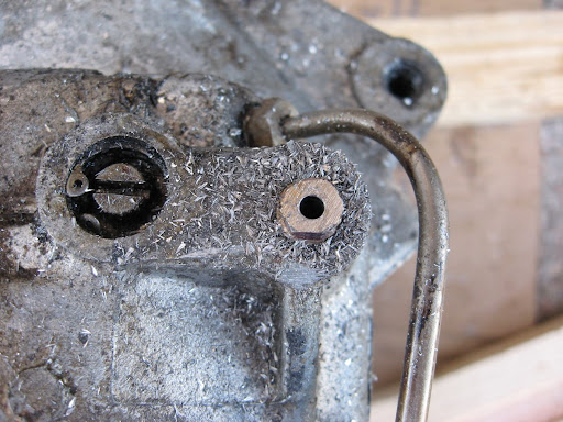

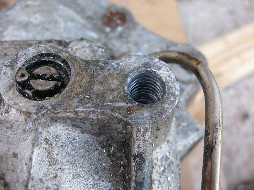

Here is the work that went into (mostly) installing the power tilt. The unit had two cut off bolts that required removal. Heat got this one out:
The other one was stubborn and cussing didn't coax it out. I finally said screw it (well maybe not that PG) and drilled it:
Then tapped it. Should have repainted the scorched area on the tube.

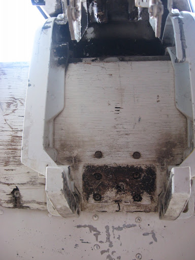

The wood behind the manual tilt was entirely rotten:

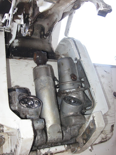

Didn't take any pics of the outboard levitating, but here is the power tilt mostly bolted in. Need to do motor/wiring.

Sounds like I need to get some thrust pads to complete the tilt conversion. In the meantime, I might tear off that external board (between the outboard and transom), cut a new one from marine ply, seal it and reinstall. What would you guys recommended as a sealant for this board?
