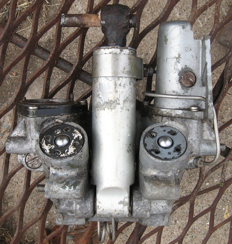

I want tilt, so I picked up a cruddy tilt unit w/ no tilt motor, complete with cut-off bolts and screws from fleabay this winter. Pic attached. Ooh, purty! I used a drill w/ a flathead attachment to test the operation of the cylinders. Typical fleabay junk: the cylinders were all stuck but they finally broke loose. Fortunately they were only a bit corroded (from saltwater I think). They shined up nice and I worked them in and out.

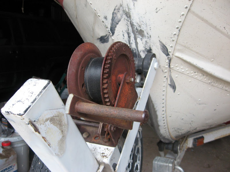

I also replaced the junky trailer winch w/ rope with a junky winch w/ strap. Pic attached. At some point, I would like something a little nicer, but really I would prefer a wider trailer. This trailer is NARROW -- the fenders are so far under the boat that it's nearly impossible to step on the fenders to get into the boat w/o performing acrobatics (and that's with a dry trailer).

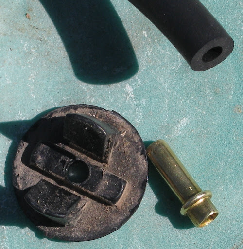

The water outlet hose/tube on the 70hp had split and was leaking, so I needed to replace it. It was cold, so in the back of my mind I was thinking "Gotta be careful, this brittle old plastic might break.". But the front of my mind was saying "Come off you POS. I have some boating to do!". The back of my mind was correct, and the little plastic fitting broke. Had to do a little fixing. I found a brass fitting that would fit the hose, and drilled out the plastic fitting so that the brass piece would slide right through. The throat is not as long as I would hope (or barbed) but it fits tight and should work.

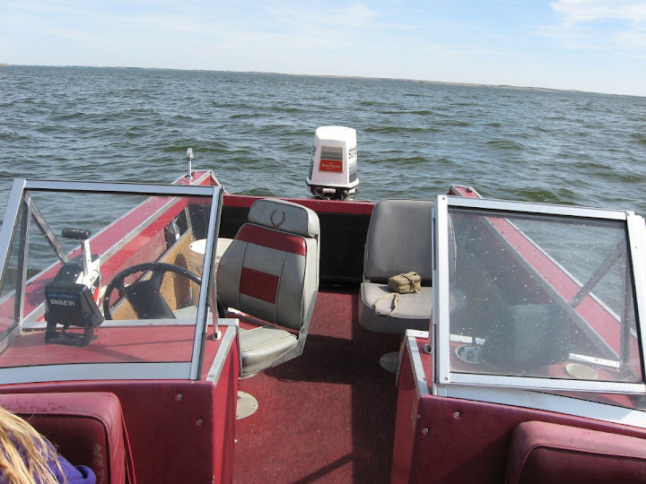

We had a nice "winter" day of around 70F Thursday, so I took the boat to the lake for its first test (with me at least). The boat has some minor leakage (I saw some trickles just above the drain plug), but nothing too major.
It was a little windier than I had wanted, which made launching less enjoyable since the docks aren't in the water yet. The motor moved the boat well (didn't check speed, but I would guess 35+) -- a power tilt would be an improvement. I need to do some adjustments to the trailer bunks/rollers because the boat didn't slide on/off the trailer very well.
I didn't get any in action shots, but here's an on-the-lake shot:
