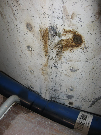

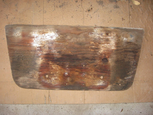

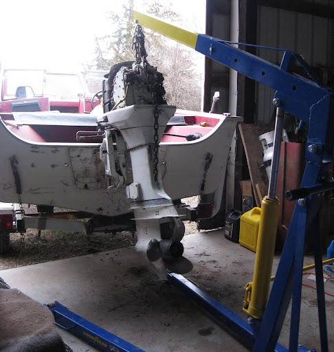

I had a few minutes this evening, so I decided to hoist the outboard and remove the exterior ply.
Levitating engine:
Rot city:

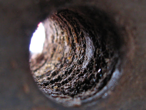

Looking into one of the lower outboard bolt holes through the transom. Not so purty. There's a fungus among us (soft maybe 1/2" in):

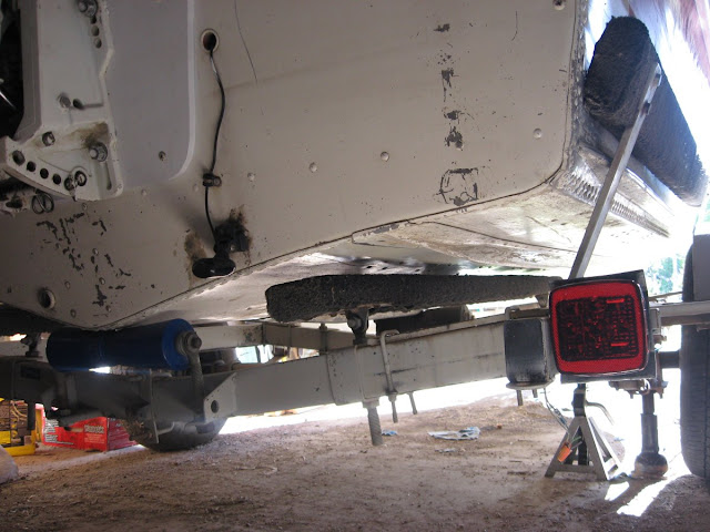

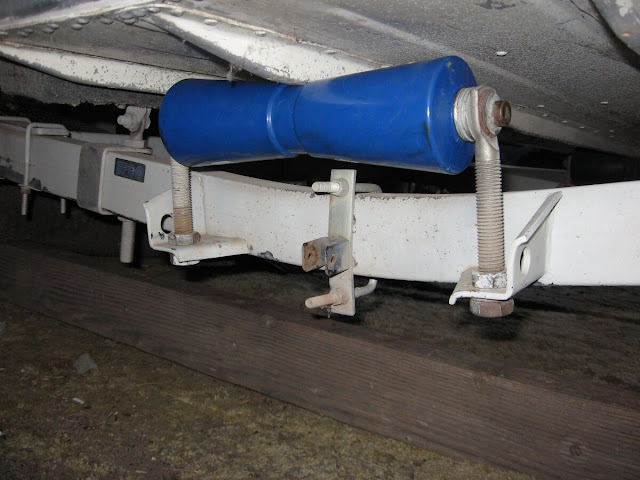

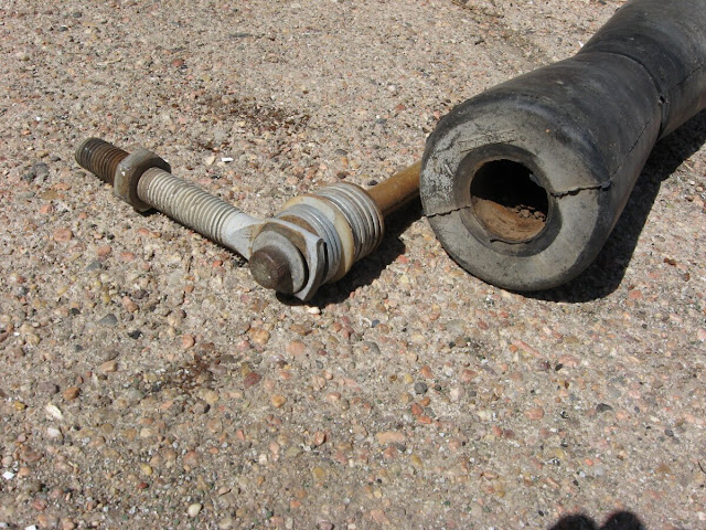

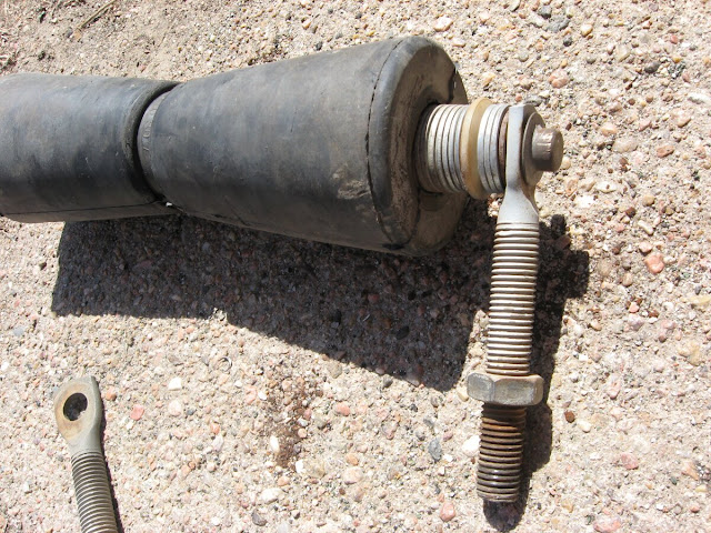

While waiting on the epoxy & paint to dry on the transom stiffener, I did a little work on the trailer that will go under the boat.
The rear keel roller was in bad shape. I had been prolonging its life by using some washers that would fit inside the rotted section.
I tend to mount my rollers a bit high and roll the boat on much of the way (instead of clunking it into the trailer), so I really appreciate rollers that roll. I bought a greasable roller shaft, but the grease outlets didn't sit within the roller, so I'm sending it back. Here's the new poly replacement with the solid roller shaft:
... and installed on the trailer under my LoneStar.

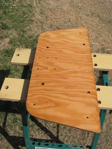

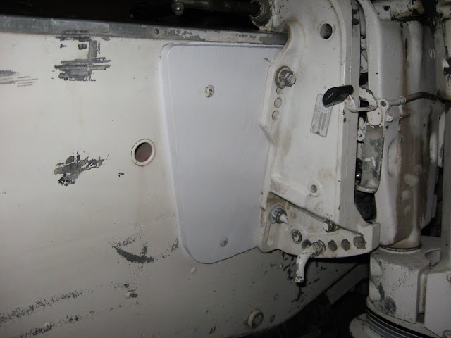

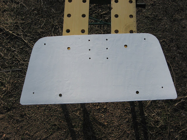

Here are some pics of my work in installing a new transom stiffener. I gave it a couple coats of epoxy and then a couple coats of marine paint.
Stiffener w/ fresh epoxy:
Top coat applied -- only a few bugs and bubbles :)

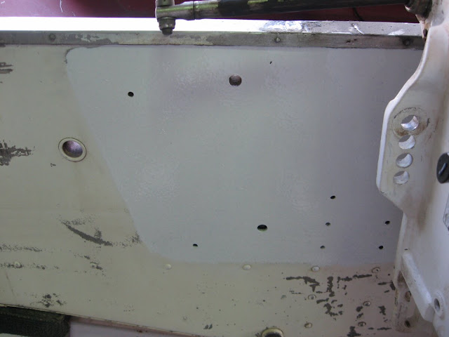

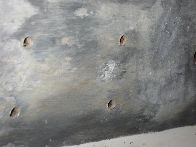

I hadn't noticed when I removed the old stiffener that the aluminum behind the stiffener had some corrosion. I noticed it only as I went to install the new stiffener:
I shined up the corrosion as best as a person in a rush can do, and rolled on one coat of paint (and another bug):
It was a bit chilly, so I ran a heater on the new paint for a bit, and then installed the stiffener. Paint matching? White is white, right?

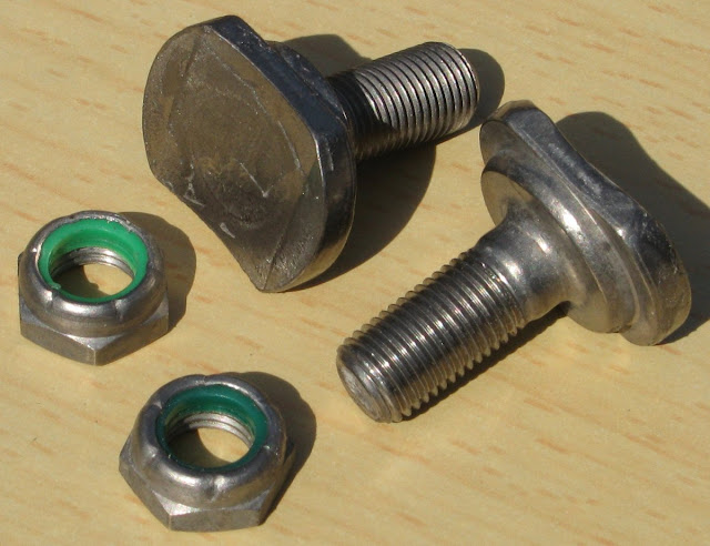

The knee brace bolts really could be a 1/4" longer. Why so short Starcraft? This was the WORST part of the install and I struggled with each nut to bite a single thread (fortunately I didn't strip anything).

Looks good dead; I love that old starcraft white looks fine till you put actual white near it. I just finished that piece myself. I had to replace the bolts so I put 5/16 ss slot heads i think 3" long and they just clear the nylocks. My transom is a little thicker than stock. I didn't want my v6 merc to fall off the first time i hit the throttle

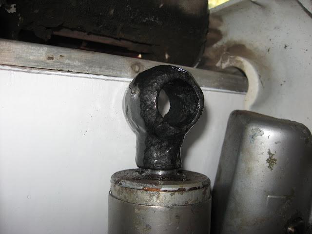

Didn't get too much accomplished this weekend. Did a little work on the tilt/trim.
I threw a little paint at the badly corroded tilt cylinder:

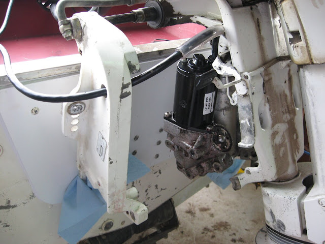

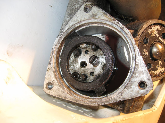

Removed the base of the previous tilt motor to install a new one.
I mostly installed the new tilt motor (with two of the three screws in) but I can't get to the back corner screw (in the left of the pic above). Looks like I will be removing the outboard (again) so that I can put that third screw in. For now, I put some fluid in the tilt/trim and made it go up and down so that I felt like I accomplished something meaningful.

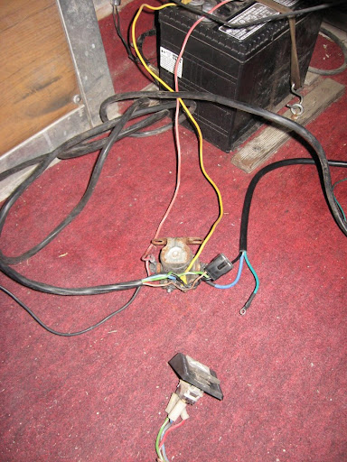

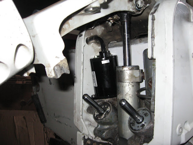

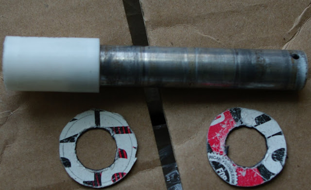

Took the engine off AGAIN. I'm sure the engine is wondering why it needs a boat at this point. Turns out I had the tilt/trim motor oriented wrong, so I had to rotate it around a bit. Note the high tech wiring bushing.

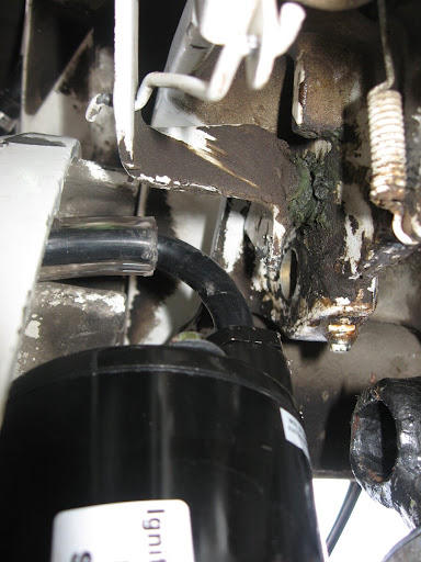

Unfortunately, the wiring outlet on top of the tilt motor hit on the tilt lock lever:
So I removed it. The bushings from the manual tilt cylinder are evidently different than the power tilt. Patience running thin so I fabricated an alternative. Pex plus washers from an oil jug. The washers should be oil resistant :) I read that pex is resistant up to 73F.
The end result is working tilt/trim. Finally!
The tilt cylinder looks like it might leak a bit, but it seems like the leak will be slow enough for now. I'm going to use it as is. I only temporaried the wiring. I did a three wire setup because that's what I had to work with. I need to mount the solenoid in a good/safe/dry location -- need to think where that might be.

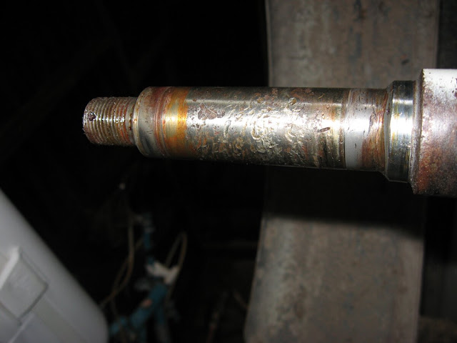

I started to think about new axle bearings and ran into a nicely pitted spindle which I posted about here.

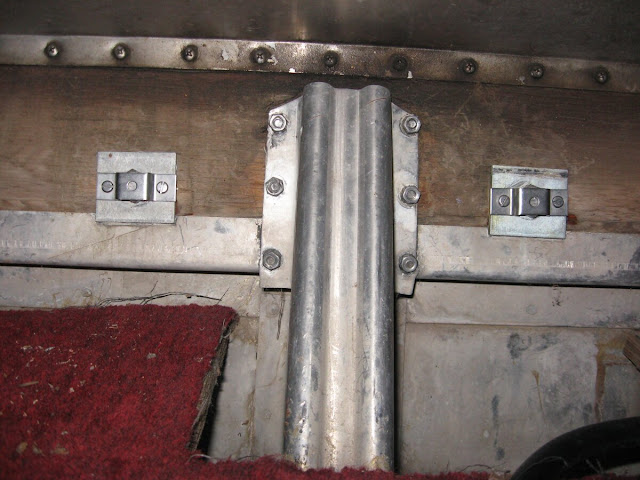

Switched my boat to a different trailer. This SS has more of a vee to it, so the rollers can be lowered a bunch and the bunks raised a little (where needed).
In the short amount of time it took to switch trailers and go for a short boat ride, the boat took on a fair amount of water (seemed like more than it had in the previous boat ride). I thought it was odd, but forgot about it because I was busy fixing other issues. There was still some water in the boat, and in the process of adjusting bunks and rollers, a good amount of water started running out. I traced it to one of the knee brace rivets. Upon further inspection, I can see another missing as well. I'll have to get a couple rivets and some 5200.
