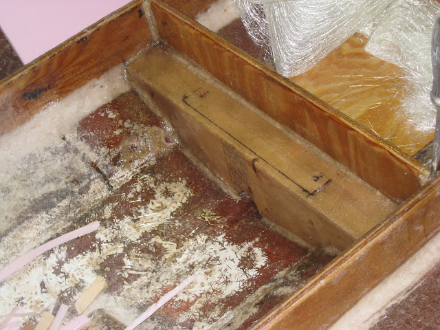

Not much forward progress today. I took some time to measure and cut the glass for the stringers. When I was measuring i noticed how little roughing I did on the initial sanding of the hull, so I took the afternoon to rough up and smooth out all of the hull areas which will be getting glass applied. This was a gentle reminder of just how horrid grinding was on the tear down. Luckily I've gotten used to the fiberglass feel and it doesn't even itch anymore (which could be bad.. :confused:).
Tomorrow begins the glassing of the stringers, which will likely eat up a good amount of poly. I'm 2/3 into my first 5 gallon pail and will likely eat into my second pail before the stringers and bulkheads are finished. I bought a 3rd bucket last week, so hopefully I'll be covered for the rest of the project. I sure hope so, at least.. my fish finder budget was spent a while ago ;)
Once the stringers are glassed and the bulkheads are in, I'll be on to the engine mount and installing the transom plate. Then comes the deck and the engine. That will truly be a milestone.

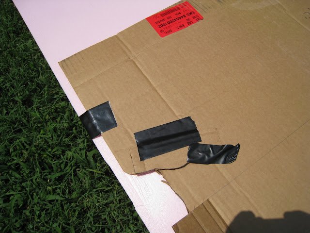

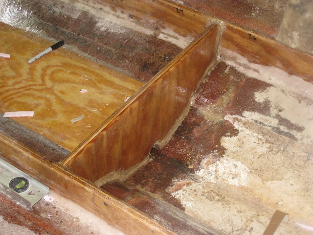

After a lazy weekend, I finally have a full update for everyone.
I spent the time finishing the bulkheads and getting to work on the deck template. I did not manage to make a how-to video on glassing the stringers, as the speed in which it must be done just didn't allow me take time out to video it. I will try to make a video about glassing around corners and curves in order to partly fulfill the promise today.
My fear of the stringers being too short came to fruition and I had to make caps for them. This certainly is not ideal, but at least it isn't catastrophic. The stringers will still be solid, so I'm not too devastated over it.
I cut some cardboard as close as I could guestimate, but since it is too floppy, it was near impossible to judge exactly where it should meet the hull, so I bought a few sheet of pink foam and began using that as my template material. It actually cuts easier than cardboard, but at $9/sheet the major reason I opted for it was it doubling as flotation foam.
Cardboard seems an easy templating material, but I quickly found it difficult to cut straight lines and trimming off small curved pieces is barely possible.
The bulkheads are finally glassed (tabbed) in. I bedded and filleted them with PL. In the background you will also notice the fuel tank support. I purposely didn't spend much time on the tank support, because I worry it may see standing moisture often, so I want it to be able to air out if water does make it to the wood. I don't want a repeat of rot, especially in an area I cannot access.
Using an engine mount placement guide I fabricated, I was able to finally place the engine mount. As with the other bulkheads, it is PL'd in place and filleted, then tabbed in with glass. I plan to wait until the engine is almost in to drill and mount the engine mount, just to keep it out of the way and also allow me more thought on how to place it without risking it being off a tiny bit.
Here you can see the entire fuel tank support. I made it short so it can shed water easily. Below it you can now see the drainage pipe I added below it. This pipe is molded to the fore bulkhead yet spaced away from the aft one. This will allow any water which manages to sneak into the fuel tank area to drain out. The purpose of the pipe is to prevent blockage from leaves, etc from getting stuck inside the fuel tank bay, which will soon be inaccessible
Here you can see the drain pipe. The PL filleting isn't very clean, but then again, it will never be seen.

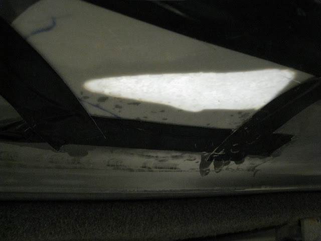

I finally got around to patching the hole I made in the hull during the teardown. I used a flexible cutting board as a semi-rigid backer with a piece of wax paper against the hull. I then placed a few layers of mat on the inside.
I just used guerrilla tape to stick the backer to the hull. It worked so-so. I'm sure I'll have a good bit of sanding to do, but at least there isn't big gaping hole anymore, so there is forward progress. I noticed an air bubble I'll have to fix later, but no worries.
The mounting holes and drain hole are now drilled in the transom. Judging the angle of the holes was difficult at best. I may have to adjust at least one hole later on. I haven't figured out how to inject resin into the holes to seal them. They will need sealing, though.
On the bottom drain, they don't seem to make drain plugs which are long enough, so I will likely use some 3/4" PVC to span the remaining distance. PVC isn't great, but it will be a barrier for the wood which isn't spanned by the brass drain.

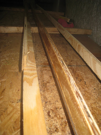

Ugh! The bad news.. the stringers are too short! In order to fix this I cut some 1" strips of 1/2" ply and poly'd them. I will PL them into place. The reason for the need is the fuel tank sits above the top edge of the stringers and I can't have the deck sitting on the fuel tank instead of the stringers.
