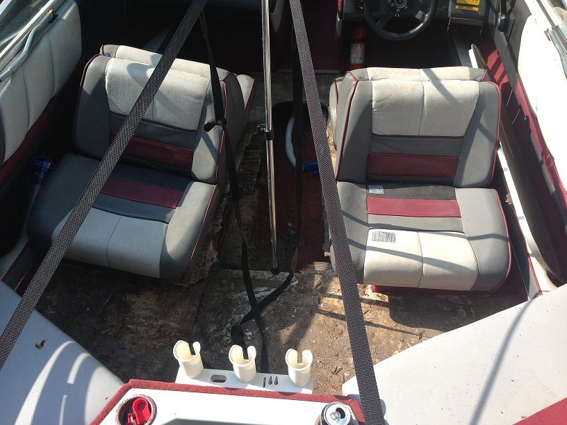

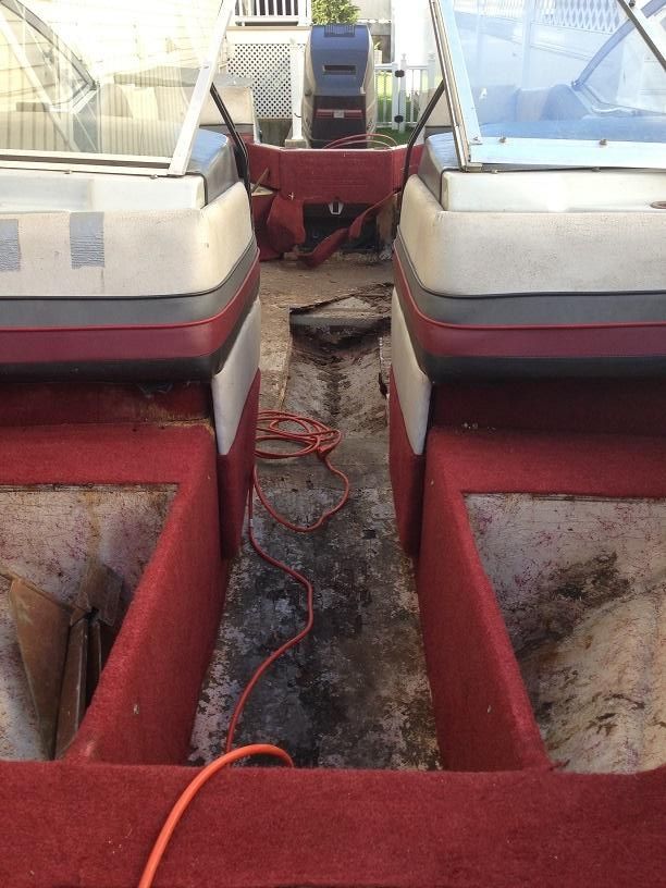

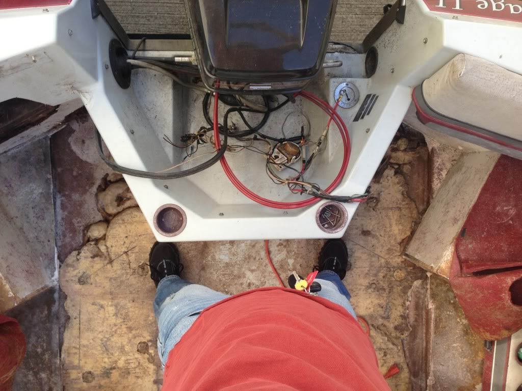

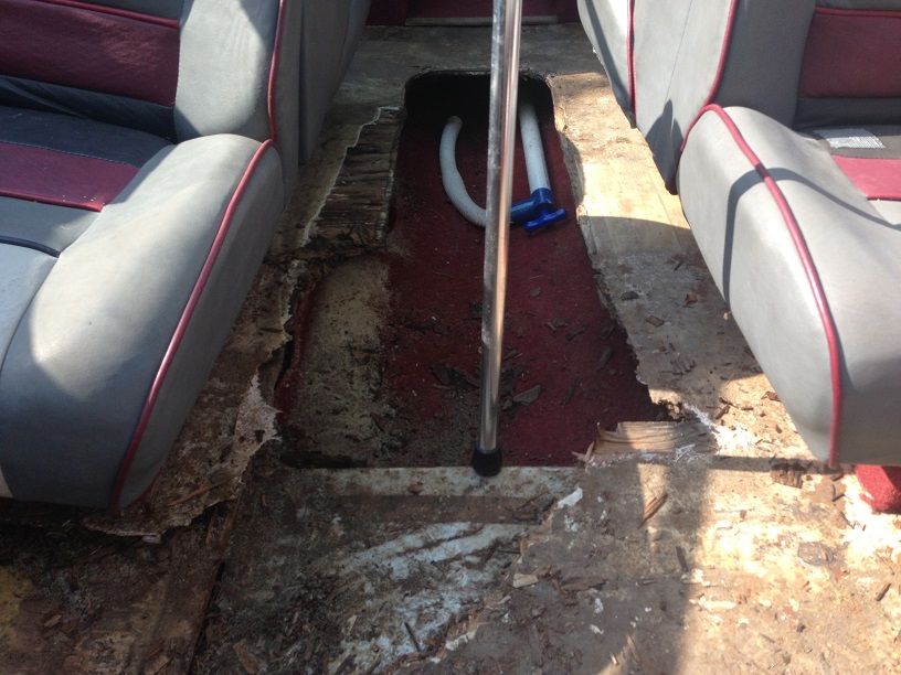

So I was in denial thinking that my 25 year old Maxum with the soft floor could be simply repaired by re-decking. After sifting through all the posts on this forum and reading a ton before I got the boat in my driveway, I felt like this is no big deal... I can handle this! Well, I got the boat into the driveway on Saturday and started right out with the demo and surprise surprise... there's rot where I didn't want there to be of course.
I'm a newbie at this but am sorta handy I guess.. I've got all the tools to do it but very limited space. No garage, just a very small driveway.
I haven't cored the transom but will tonight and expecting the worst. The stringers look shot in the areas where the I was able to get into behind the fiberglass - actually, the port side stringer looks like the fiberglass was compressed down.
So I think I'm off on a restoration of this boat, but got a bit discouraged yesterday with all the rot and demo needed and thinking how its all going to go back together. Reading through others posts definitely builds on the confidence though. I like the hull even though its a very typical maxum/bayliner style.. It's fits my family well and who the hecks got 20k to drop on a new boat.
So I want to get the idea in my head on a few specific items like the splash well and cap. I don't want to remove the cap. As I've mentioned, I have extremely limited space and no garage so wouldn't have a place to put it and really don't want to deal with doing that nor having the hull shape deform as I've got no means to support the hull other than the bunk trailer its on. I've seen others do their resto's with the cap on so I want to try and do the same... Question is how to deal with the splash well cause its obviously in the way of the transom. Any suggestions? ALso the two box seats at the stern on each side of the splash well are foamed solid and attached to the hull on the back side - really hard to get to with a sawzall. Any suggestions on how to get these out? Also, I have to research some more on removing the motor as I've never done that as well. I'm thinking I will build a stand per the sticky on this forum and stick it in the driveway with a tarp over it.
Here's some initial photos from Saturday and Sunday. I've already removed all the decking at the stern. More pics to follow.
Hoping some of the experienced guys on this forum will guide me on this journey...

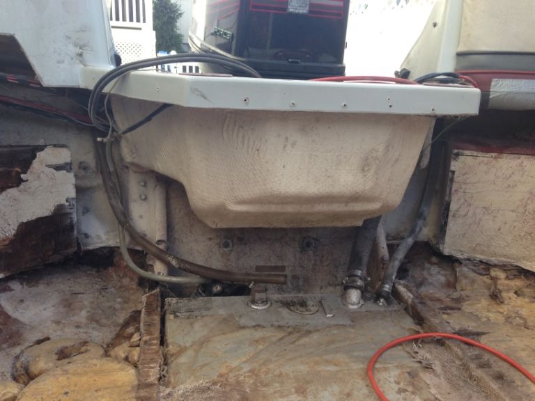

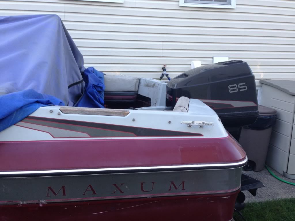

You're off to a good start. Pics are always a big help. Get the longest blade you can find for your sawzall and it will bend and lay flat on the deck and cut those boxes right out. Post up a pic of the rear (stern) on the outside so we can see what it looks like. Another one standing inside and looking down across the back of the transom. Once the boxes are removed along with the deck we can give you a better idea of what will need to be done with the splashwell.

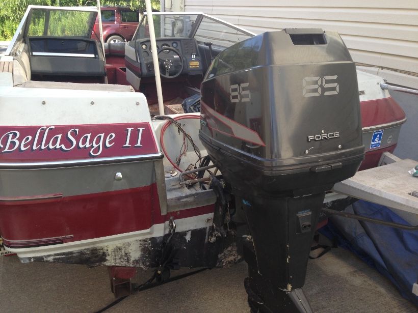

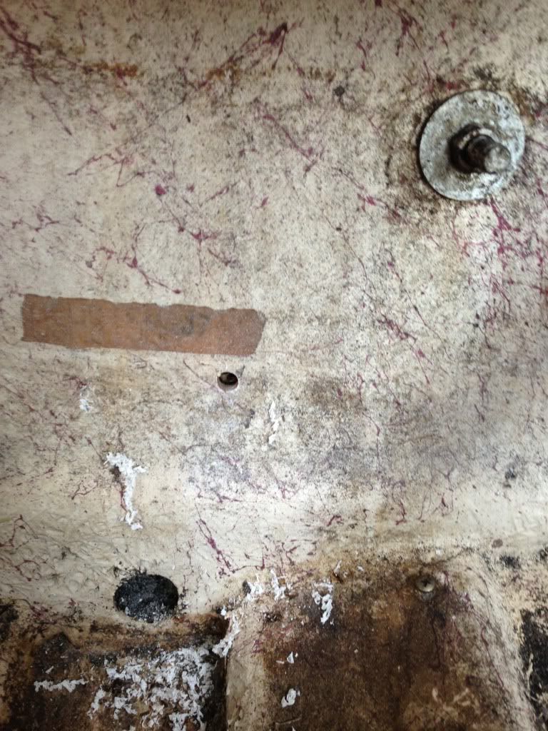

Took some photos of the transom.
further
Jun 18, 2009
1,038
Re: 1988 Maxum 1700...There's no turning back now!

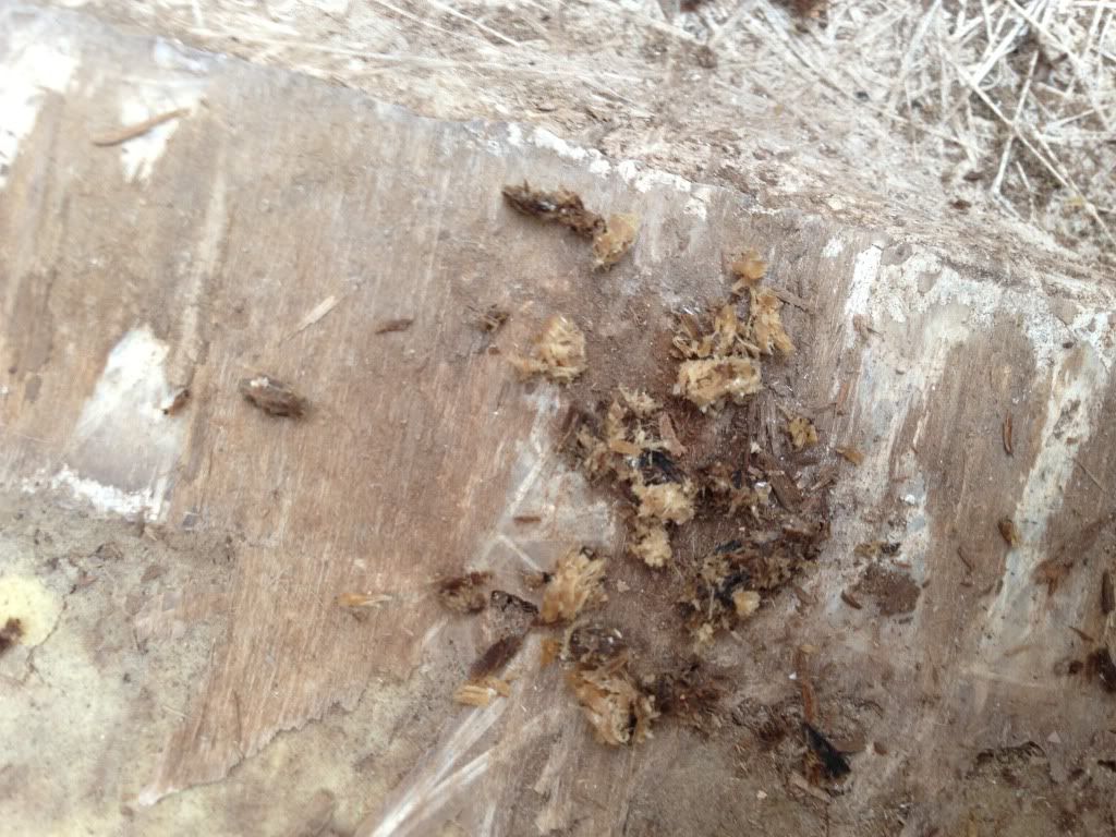

I took cores of the transom also - bout 5-6" above the bilge area. first core didn't look so bad. second core not so good
So i'm gonna continue demo for now little by little. What do you think on the transom and splash well? I'm sketched out about removing the splashwell and getting at the transom.
Thanks for your help with this. This forum is great and I wouldn't even fathom attempting this without the guidance of the pros on here!

You will need to decide to either remove the cap of the boat entirely or at a minimum the splashwell across at the gunwales.
It can be done, has been by many. YOU CAN too....

Post a pic of the Gunwales at the rear corners. The pic JBC posted is precisely what you'll be doing. Once you post the corner pics we can tell you where to make the cuts.

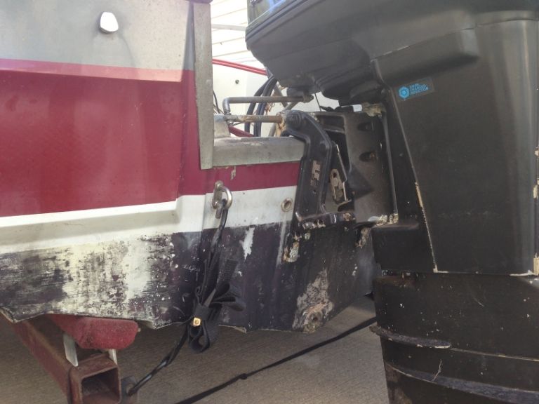

Here's the pic of the gunwale port side
jigngrub
Mar 19, 2011
8,155
Bad thing about those f'glass boats is that once the deck goes, everything below deck is past buggered and all of the denial in the world won't change it.
I'd cut the cap between the first and second snap out of the corner:

The rubber in the rubrail can be removed and there will be rivets or screws holding the to halves together. Just remove the portion that needs to be released to allow the cut portion to come off. JNG's cut line is as good as any. Is the transom flat across the back or is it slightly curved?
