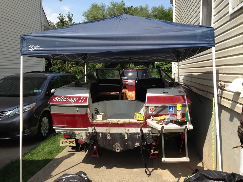

Finally spent some time on the boat today. Built the stand, pulled the motor...
Super tight work area but making due...

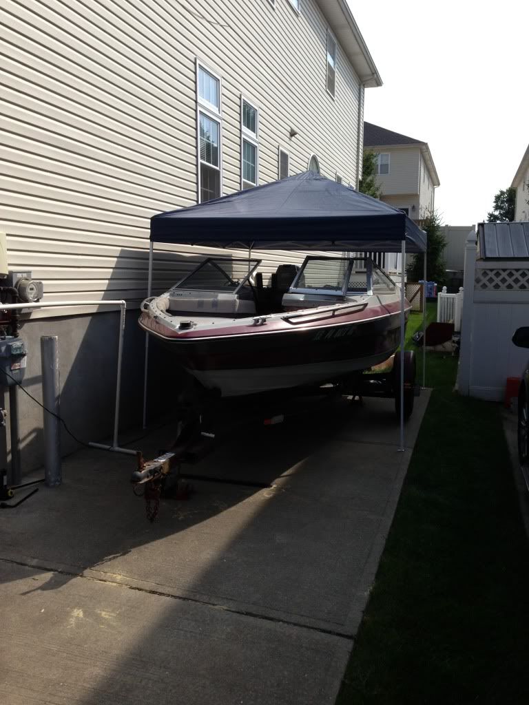

Yep in the burbs. Staten Island actually so more like urbs. Very tight quarters. Renting at the moment and landlord doesn't mind as long as I keep things neat. Neighbors are great actually. Always coming by checkin out the progress and offering help and tools if I need. Def lucky in that respect. Although they don't know what's coming with the grinding lol. I'm planning on tenting up tho to keep it contained.

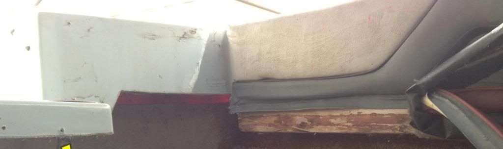

How are the interior back rest panels supposed to come out without brute force to yank them out?? They are screwed into the gunwale/cap from the outside in, so looks like either its brute force to yank them off or removing the vinyl, getting under the foam and unscrewing. It's like the original installation was done with the foam and vinyl attached only at the top, the plywood was screwed into the gunwale, and then the vinyl and foam was brought down taught and stapled. Really amazing the manufacturer couldn't have used a more effective method of fastening these. I'm trying to avoid dis-assembly of these cause I would like to have a reference/pattern for re-upholstery. Any suggestions or insight? Also, how the heck do I re-install these when all done? I've tried searching as I'm sure others have dealt with this issue but haven't found too much good info on it. I was thinking of using my prybar but worrried bout damaging the FG on the cap. Here's a pic of the port stern panel that i took the bottom to sections of vinyl off to expose the top section.. I later peeled the top vinyl up and found the first screw - just seems very tedious to do this and will ruin the reference/pattern I want to maintain for re-assembly...

If you are cutting the gunwhale off at the back, I'd leave the backrests on as they will be part of the cap that comes off. Then you can carefully remove them in one piece as you'll be able to see what's behind. My own boat is an 89 SR180 BR, so construction methods appear to be fairly standard around that time period. Whilst my boat rear is an inboard with a full width sunpad/engine cover, all the upholstered panels that attach to the boat are vinyl covered ply panels attached with SS tee nuts and bolts, then held to the boat side by SS nuts. If you haven't much room at the back of those panels, then maybe they used another method of attachment. One thought springs to mind and that is constructing new sunpads using a thinner ply backing and then using large velcro panels to 'stick them to the boat rear. Velco should hold them really good and removal will be a breeze. Another method (and I don't know where you'd get the bits from) would be slider bracket arrangement. The panels have a metal slider and the gunwhale has a shaped bracket that the slider slides into. Basically you hold the panel above the brackets, then push the panel down to locate the sliders into the brackets. A similar action would be sliding a bolt shut. Apologies if I haven't explained that well.

I'm actually going to be cutting about 6" into where the back rest currently is so I'm going to have to remove it. I removed the section along the stern as you can see in the photo above and also the back rests at the bow against the dash. These were removed by brute force cause there was no other way to get at the fasteners. The manufacturer screwed the ply from the outside then covered the screw heads with foam and vinyl so there is no way to get at the screw heads without removing the vinyl and foam. Very annoying. Looks like i'm going to either pull them off or maybe use a metal blade on the sawzall and cut the screws carefully.

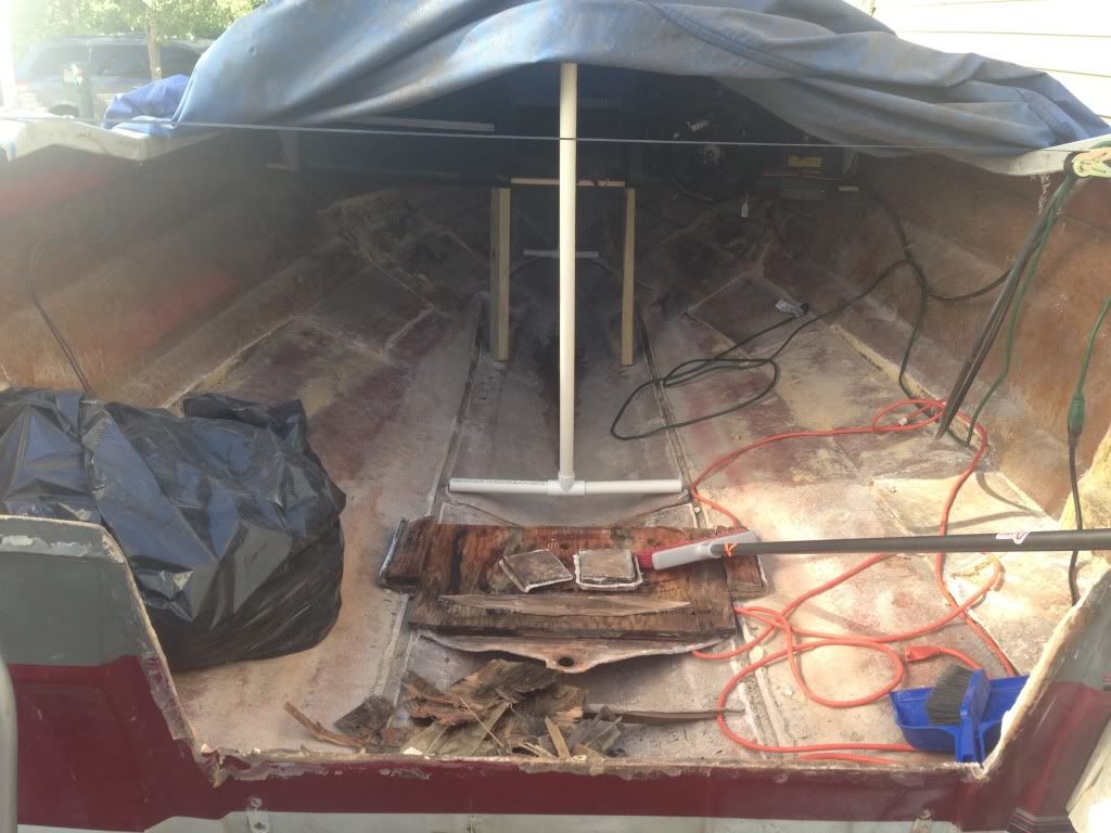

Got all the back rests off with a little force and sawzall to cut the screws between the back of the ply and gunwale.

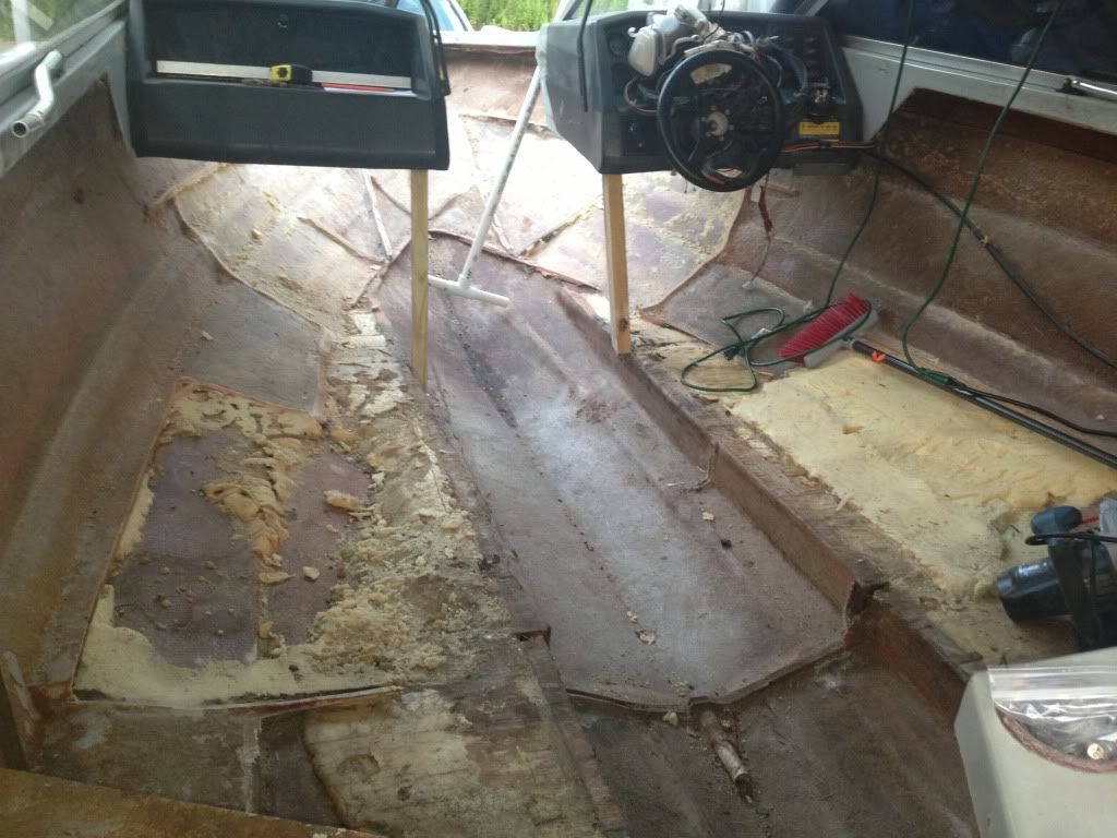

Planning on getting to the rest of the foam tomorrow between honey do's and cutting some of the lips to make for a bit less grinding. Still haven't decided on the cap. Should I cut the stern section to remove just the splash well or take the whole cap and slide it back and forth on 2 x's someone had suggested previously? Can't decide. Someone talk me into one or the other.... Anyway here's a few pics...

Nice glassin eh? What the??

That looks like chopper gun (EDIT: I think mat now after looking again) My Glastron of the same year was rove.

Chopped :)
Ripping out the transom and stringers next.

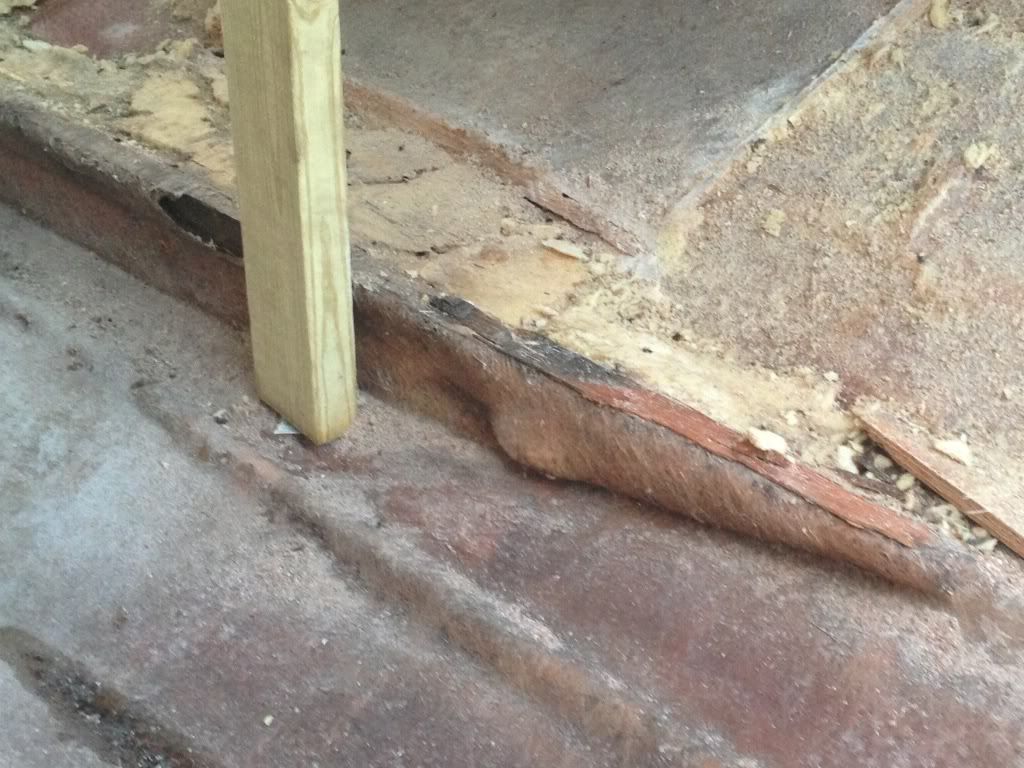

Some progress pics. Got the stringers out. Starboard came out in one piece. Port side not so much. Bout 1/4 of the full height of the wood left in the fg wrapping. Amazing stuff.
Also got the transom out and cleaning it up.

Nice progress further!! let the iching begin!! Hey nice factory swirly of adhesive holding that transom in.
