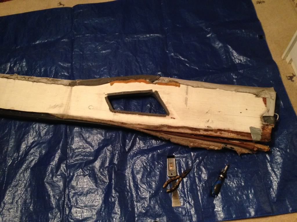

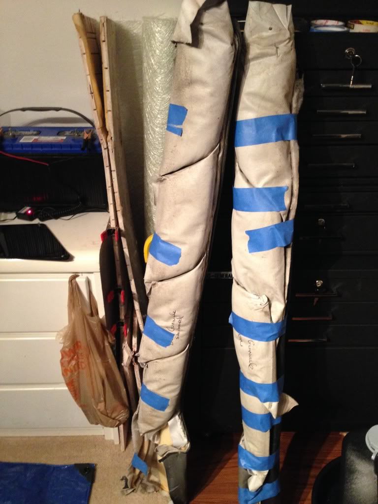

Hey all,
So I'm in the process of re-doing the upholstery and removing all the old stuff from it's wood backers. Trying to keep everything together so I can use the old as templates.
I'll be replacing all the wood over the next week or two with 1/2" exterior. Any recommendations on what to coat the wood with? The original looks like it was painted with something and I'm thinking I'll do the same just not sure with what would be best. Any suggestions? Here's some more pics

Hey neighbor....Ive seen some with just primer/paint, some coated with resin or polyurethane...mine were either just painted or left bare :(...and they dryrotted...when I do them over, im coating the wood with resin.

Yeah was thinking resin as well but not sure if that's overkill since these pieces won't really be exposed to moisture/weather all that much but I guess since I'm doin it, I should overkill it :laugh:.
After 25 years, the originals aren't in all that bad - i'd expect worse but it does look like they were painted on all sides including edges - some areas though where the paint wore, have dry rotted.

I used copper-green treatment on the wood for my upholstery. It is supposed to keep it from rotting. Like further, my original wood seemed to be just treated ply and was still in pretty good shape after 25 years, so I did not go through the trouble of resin/glass.
