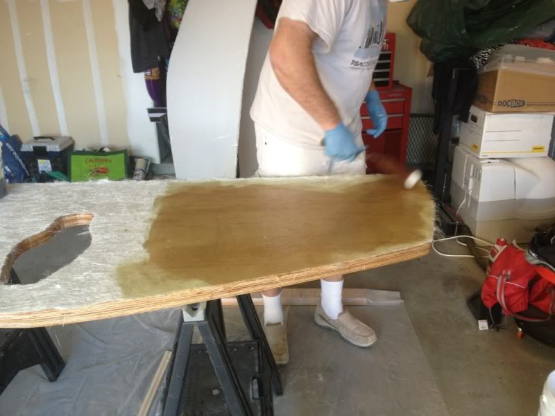

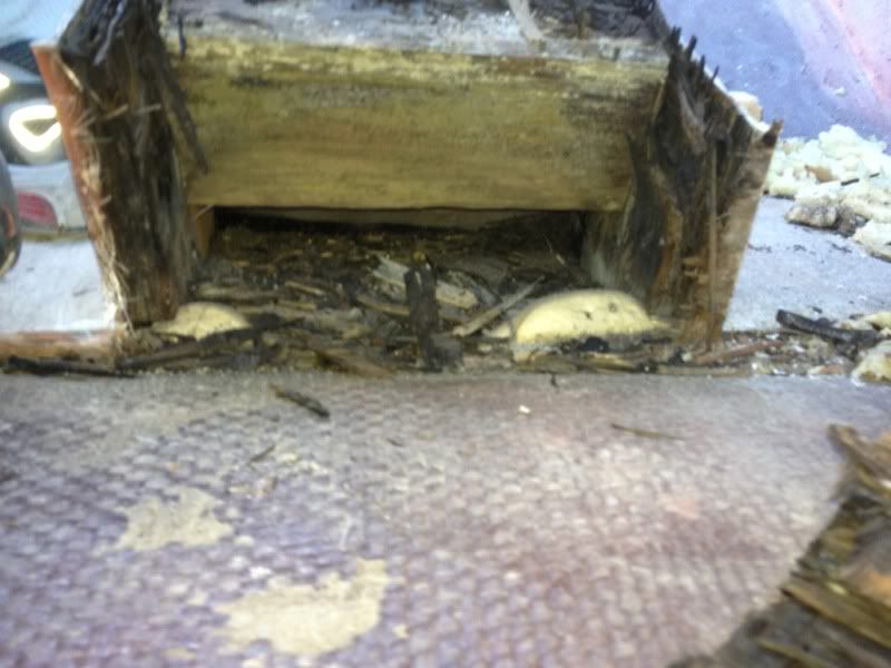

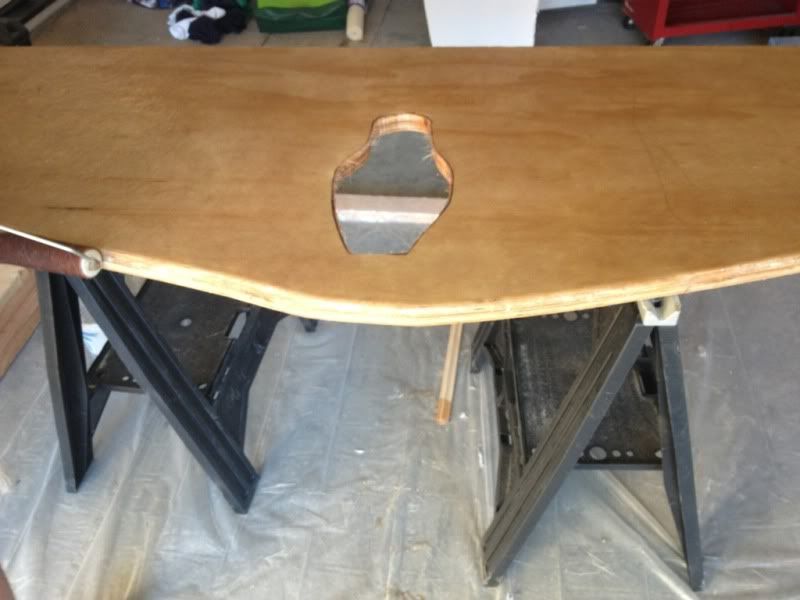

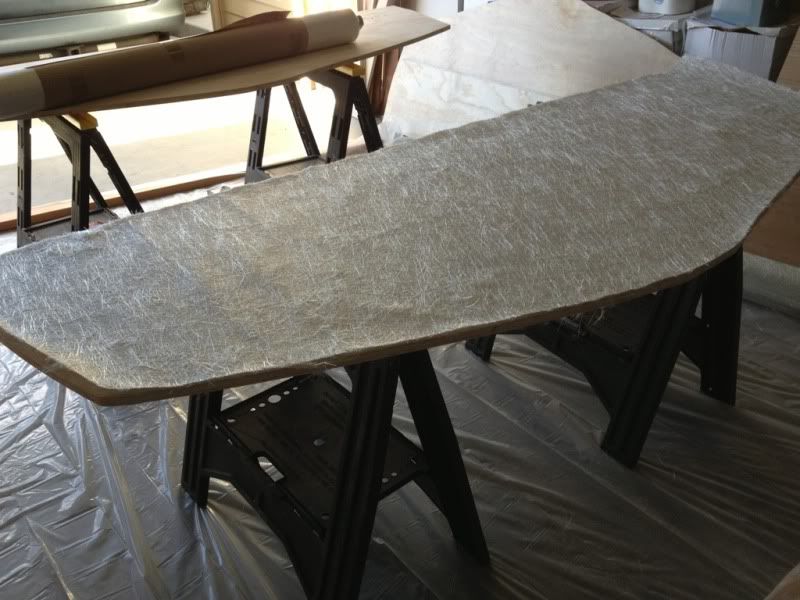

I think we made pretty good progress this weekend. We demoed the rest of the bilge area and removed the gas tank. We cut the transom wood and laminated it together. We covered it in CSM and bedded it in the transom. It is currently clamped and curing. We also moved the boat into the garage because our HOA finally came down on the boat on the driveway. Here are the pics of our progress. Here are the pics of the progress so far...
A couple of interesting shots of the motor mounts - one from the top
One from the side (starboard mount had been foamed, port hadn't :confused:)

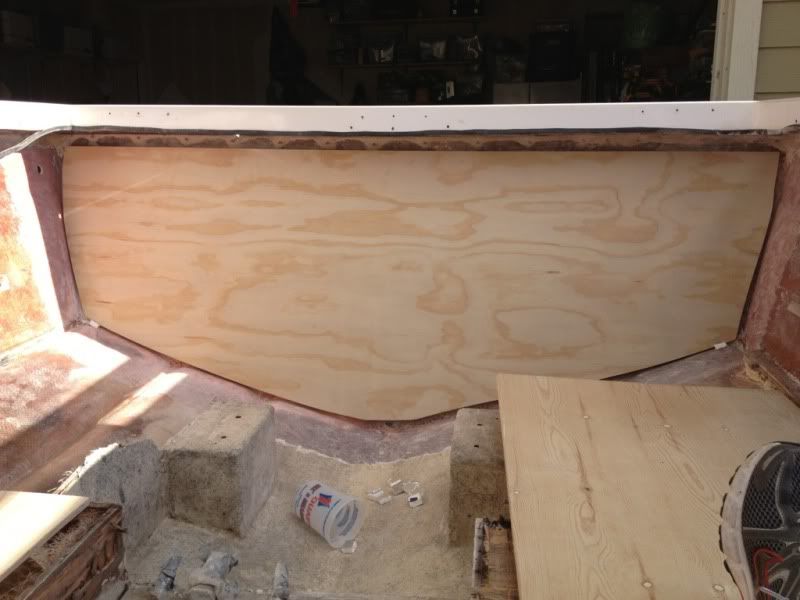

Test fitting the transom
Ready to laminate

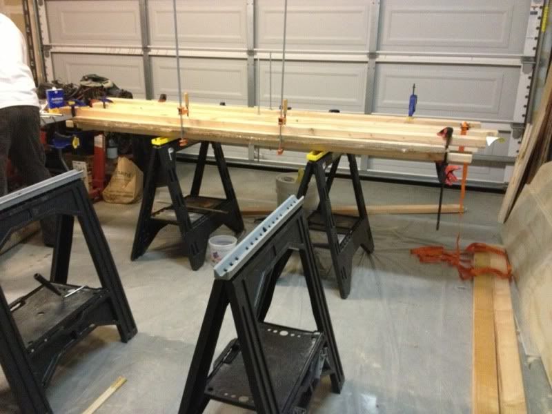

Clamping down the laminating layer

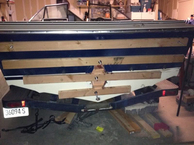

Covering in CSM
All covered
And clamping into the hull

Did you precoat the wood with resin prior to applying the CSM? How much PB did it take to glue it to the outer skin? Did you have plenty of squeeze out to do the filleting? Am I correct in saying you laminated the two pieces of plywood with resin and CSM and not the Titebond III?
VolleyGirlSC
Aug 9, 2012
55
Re: 1987 Reinell 192s Restoration Project
Yes, we precoated the boards with resin before we laminated them together. We couldn't get Titebond III here and I didn't want to wait for the cure time of the PL. So we resin soaked the boards first, letting it soak in until tacky, applied resin again to the sides that would laminate together, put the CSM on one side, wetted it out and then clamped them together.
After that set for 24 hours, we put resin on all the edges again, and both sides of wood, then covered it with CSM. Once that set overnight we troweled the PB onto the inside of the hull and onto the transom wood and clamped them together. It did squeeze out around the wood - more than I thought it would. We used 4.5 pints of resin with 4 pints of colloidal silica and 2-3 pints milled fiber. We did three batches (2 pints, 2 pints, 1.5 pints) which we measured out and had all set and ready to go. Definitely easier with hubby mixing and me troweling. The last 1.5 pints of resin we had to use some bread flour as we ran out of silica, but we still added milled fiber as well. All in all, it went pretty smoothly. We clamped it into the boat and filleted the PB that squeezed out. I will need to go back and add more PB around the vertical edges and the drain hole because I am not happy with it. Can I just add it onto the cured PB that is there to fill in the gaps? We didn't have time to do the fillets completely Monday night because we had to pick up the kids up from daycare.

We took most of this weekend off with family, but spent some time today in the boat. We tabbed the transom in with CSM, covered the the entire thing with 2 layers of 1708. Now we are in the process of tabbing in with two layers of 1708, unfortunately it cooled off this evening, so we'll finish that tomorrow.

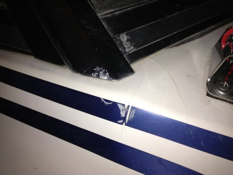

I have a question regarding the top near the windshield. There are stress cracks (I assume from the rotten floor), do I repair these the same way as I would stress cracks in the hull or is there a special way? (See close up pics below).

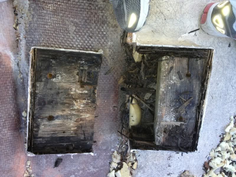

We made some demo progress last weekend, but not as much as I would have liked. I still need to get the bow seat supports, the console support and the floor/foam up into the bow out of the boat. I hope to get some demo done this weekend.

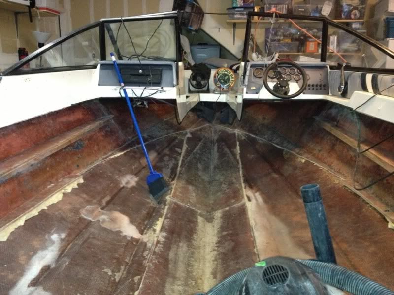

This weekend we got a little further. We didn't have a lot of childcare, so we only got the demo done. Now we have a lot of grinding to do. The next two weekends are busy with family stuff, so it won't be until after Christmas that we can any significant progress done.
Question for the experts - are the lighter pink spots on the hull delamination? If so, do I grind it down and add a layer of 1708 or is there a better solution?
