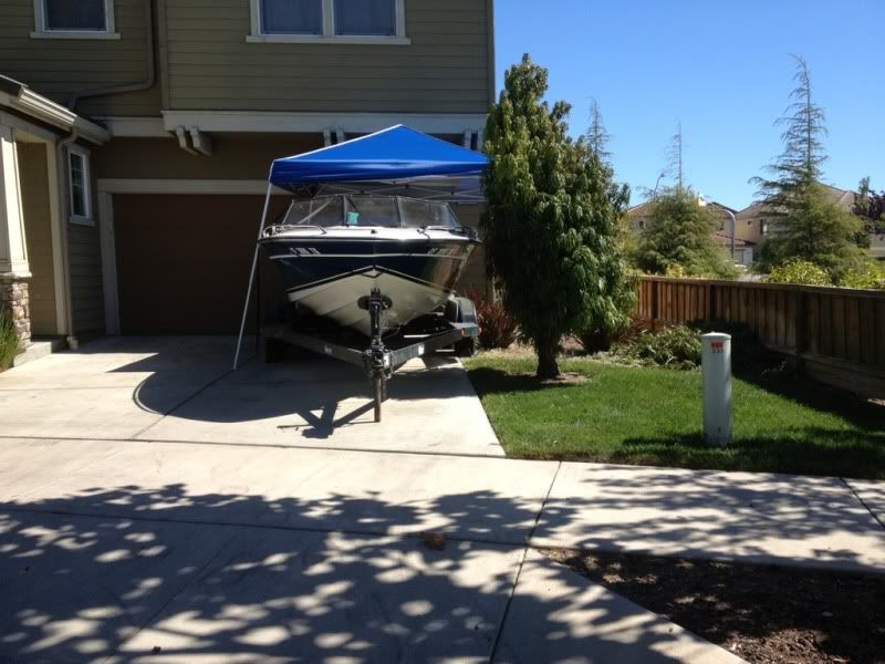

I think I will be heading to the store tomorrow to get a canopy to put over the boat to give us a little shade to work in since the boat won't fit in the garage on the current trailer. I can't do the semi-permanent car one, because my HOA will burn it down, so I think we'll get an EZ Up type that I can put up on the weekend and take down during the week.

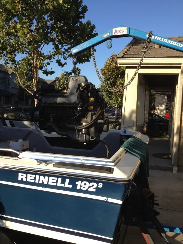

Wanted to update on our progress. We pulled the engine today which went surprisingly well considering we've never done it before. It was a lot easier than doing a car, that's for sure. The towable high engine hoist that we rented for $38 dollars was perfect and made the job really easy.
We took more core samples of the transom and motor mounts. There is an approximately 1' x 1' area in the lower starboard transom that is soft, but the rest is solid and dry. What are the pros and cons of injection epoxy versus partial replacement versus full replacement? Obviously full replacement will be best end product, but what's the risk around a partial replacement Should we go ahead and skin what we can to get a better look? Our transom is 1.5" deep across the full width of the stern, so we'll replicate that exactly. Can we replace the transom without removing the cap?
The starboard mount and bilge bulkhead are pure rot, the port side has a spot or two, we'll pull more floor up to get a better view. The factory bulkhead and stringers were half-inch, should we stay with that or upgrade to 3/4 or 1"? How long does the pky need to dry before we use it? Thinking about picking it up tomorrow as we won't get to even work on demo for another two weekends due to scheduling.
I also bought a second bigger respirator with replaceable cartridges so that hubby and I can demo together. Not fair if I get to have all the fun!!
The current plan is to remove the housing, blower, etc from the transom, skin the transom and assess what we can. I think we'll end up with a total replacement, but we'll see. Then we'll pull up the floor, foam etc up to the engine compartment and stop there until we replace/repair the transom. Then we'll do the rest of the floor. Should we demo and replace the stringers one at a time? Or can we take them all out? I don't want to lose support in the hull if possible. It's on a bunk trailer.

I wanna get me one of those high lift hoists . . . that looks awesome.

@tpenfield - the lift worked great - I highly recommend it!
