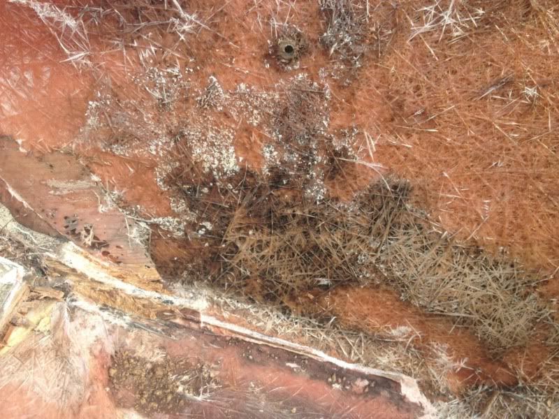

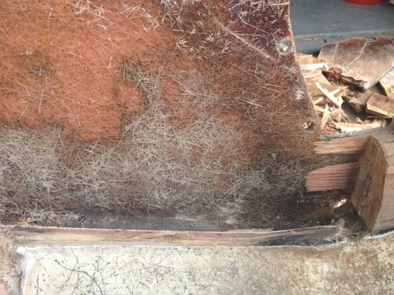

We haven't made the progress that I wanted. My older son and I both had a fun week with the flu. I did get a few hours in on Sunday though, which was very therapeutic. I picked up a cheap oscillating tool at Harbor Freight and I love it. I will have to get some more blades, but it works wonders.
I have half the transom wood out, but the fiberglass of the hull underneath looks horrible - I think it is actually moldy. Once I get the other half out, I'll grind it down to fresh glass - is there anything else I should do to treat that mold? Should I add a layer of class to the hull before I put the new transom wood in?
Your determination, even with the flu, is admirable. You could use some bleach to chase away the mold. . . . The fiberglass looks like it is "chopper gun" method, and not hand layup. So, you will probably find mold in many areas. I would not grind too much . . . maybe do the bleach and then grind to get a fresh surface.
When I did structural repairs on my 'old' Formula last year (F-242), I had mold underneath the resin coating on the stringers. The wood in the area was fine, just surface mold, but it was growing on the surface of the wood, underneath the resin ?!?!?!? Soooo, I had to grind away the resin to get at it. Of course grinding away the resin also got most of the mold. I did hit it with some Ethylene Glycol (i.e. automotive antifreeze) and let it soak in for about 1 week before re-coating.
Uniform thickness within spec for the transom assembly are going to be key concerns for the transom area. So, take those into consideration when adding material, etc.
Thank you for the info - I think I will grind a bit to try to get fresh glass and kill any mold if I can't grind enough. I hadn't thought about the thickness so thanks - that would be a really painful rookie mistake to make.

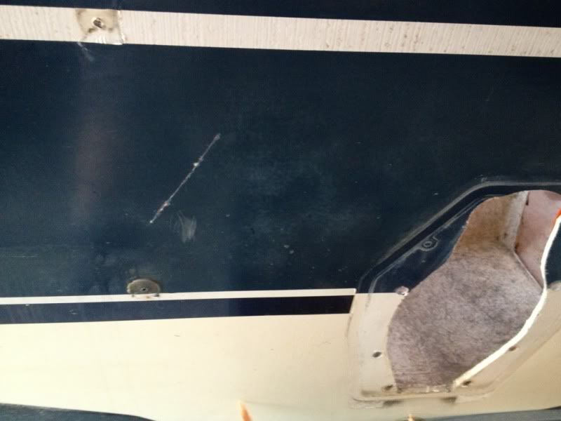

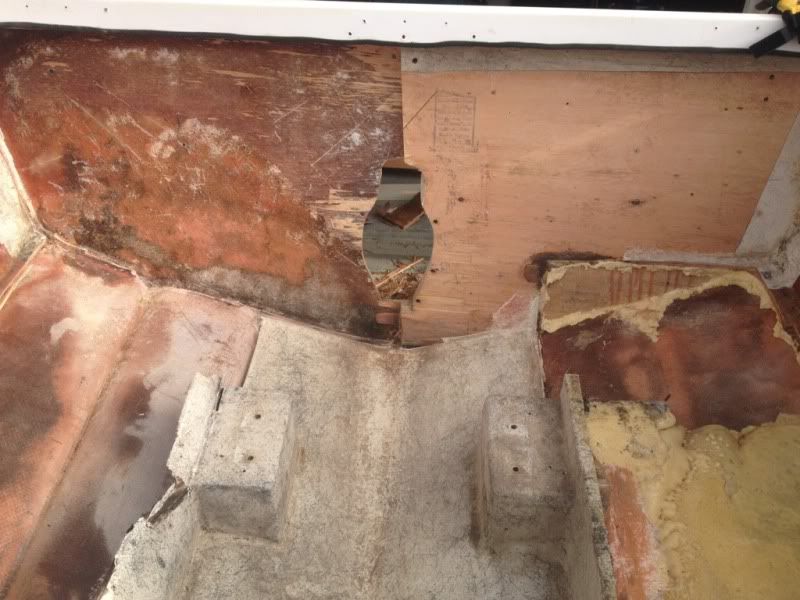

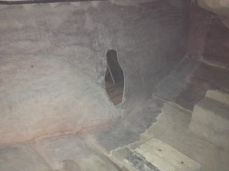

I really messed up today getting the wood out of the transom - any thoughts on how I should repair this?
Oscillating saw got the best of me - about 5 inches long and all the way through the hull in the transom. :facepalm:
jbcurt00
Oct 25, 2011
25,328
Re: 1987 Reinell 192s Restoration Project
It is of no consequence, except there will now be a repair on the transom's exterior skin.
Is that blue banding paint or gelcoat?
What were your plans for the exterior of the boat?
The transom, where there will be new plywood bedded in PB/PL, is the BEST place to daylight your hull. ;) Just remember it's there & once you get the plywood out, & start prepping for installation of the new wood, we can address it.
So now you have some idea of how the saw sounds & cuts etc when you are getting close to punching thru the hull. Hopefully you can avoid doing it again..
We've all done it, some worse then others.
You are not the first to do that sort of thing. I saw a thread on here where the guy ripped a couple of 2 foot long openings in the bottom of the hull !?!?!?!?
I would just stuff some CSM and resin in the slot and then you will want to gelcoat the outside area.
How do I tell if it is paint or gelcoat? It looks to me like the wider blue band is paint. The top white tape, bottom thin white tape and bottom blue tape are all just that, tape, which is peeling off. Below that I believe is the white gelcoat.
I am not 100% sure about the exterior. I was planning to wet sand and polish to get the haze out. If that doesn't work, I'll probably repaint/regel (not sure which I should do). Now with the cut, I may just go ahead and get it redone once we've got the interior completed. Any suggestions on the best approach?

I got the rest of the wood out this weekend and bought the new wood - I am letting it dry in the garage for the next few weeks. Next weekend I have an exam, but I am going to try and grind on Sunday. I'd like to get the transom and bilge area completely grinded, but we'll see if I can do it. Otherwise it will be the following weekend.

If you have acetone, put some on a rag & lay it against the white/blue stripes for several minutes. It may wrinkle/loosen the tape, but that you can usually ID because it starts to tear/peel w/ age. Paint will also wrinkle up. Cured gelcoat will not be affected by the acetone.

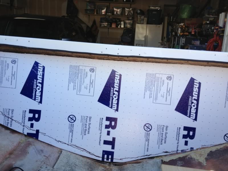

This weekend we didn't get as much time on the boat as I would have liked. The good news is I passed part 3 of the CIA (Certified Internal Auditor) examination on Saturday - so I only have 1 more test to go until I complete the certification. But that took up all of Saturday for me.
On Sunday, hubby and I got covered in dust grinding out the transom in preparation for next weekend. We first cut a template in foam based on the lip of skin we left, then we were busying grinding and grinding and grinding. I can't believe we're going to have to do this to pretty much the whole boat! :eek: We created so much dust - we had to shop vac over and over - we had all the appropriate safety gear on and so clean-up for us was fairly simple.
On Friday, I have a bit more grinding to do then we'll cut the wood, resin it, lam it together and cover it with glass. On Saturday, we'll install the transom in the boat. Hopefully on Sunday we can demo and grind the rest of the bilge area in prep for building that area in next. Here are some pics of the progress so far.
