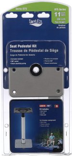

Whatever you do, put an aluminum backing plate on those bases under the floor, dont just screw or rivet them in. Bolting to a plate means they are never going anywhere. Could bolt to large washers too. The other option I had to use on a few seats are nuts with edges that grip into the wood. As you put the bolt in tight it draws them further into the wood. I put locktite on those bolts too so nothing moves.
T- nut
Also, I had extra plywood so I created 1.5 inch flooring under the seat bases by using it as the backing. No complaints thus far.

Router would be much better than my method if you can, but I didnt own one at the time. Just dont forget to seal that wood from every angle and hole. I put spar down every bolt hole. On my transom I oversized the holes, epoxied, then drilled through the epoxy so no wood was ever exposed where bolts pass through. That was highly recommended to me by some of the guys here.
I knew @SHSU told me about the t-nut, couldnt remember the name. He made a very good point about the speed rating of the pedestals too. @MNhunter1 ‘s pics show some good stuff as well. T-nuts, wood backing AND connecting plates (important for an even floor), and spar sealant. I put a coat of spar over my epoxy floors as added protection, and did spar on my consoles/side panels. Real test though is the Admiral’s wooden hammock stand which I refinished during the boat project. It sits outside 24/7 rain, sun, snow, etc. Looks the same as when I finished it over a year ago with 3 coats of spar.

As for the seat mounts/pedestals, are those rated for movement or only stationary/under 5 mph?
SHSU
Im not sure on those pedestal ratings, really the plan is they will be stowed or unoccupied until we hunt or fish. They are this same model i believe.
I also have this seat Base I can paint and reuse with a more appropriate seat.
My buddys dad is an aluminum welder and i used to work for him back in the day when i was in college , he came out and checked the project out on sunday and is going to weld me up a rear transom box/storage bench/ seat/ elevated pedestal base for fishing. we are using these 2 pics as a reference right now. This would also double as i seating are for 2 passengers getting to the spot.
I want to put the console back roughly where it is, have a raised deck, lower than what i removed from front of console to bow with a latch for storage. have a removable pedestal on front deck, middlish of boat close to transom box, and one on top in middle of transom box. So i would have 3 bases w removable seats, seating for 2 on the transom box, and i would be able to drive/hunt from my chair
