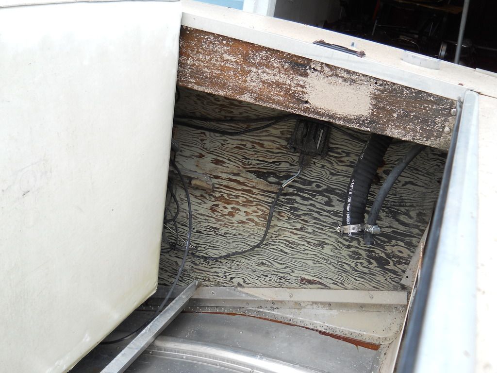

Here is a pic of my transom. I was wondering if I should sand and paint, sand and leave it alone, or sand and use a poly or spar? Any thoughts.
Watermann
Jan 12, 2013
13,842
I would remove the transom cover and inspect the wood closely and the edges are what needs sealing the most. Is that the original transom? I'm not sure how much good it would do you only being able to seal one side only. Also the wood support(s) for the cover look like they need some attention too.

From the looks of it, it looks original. The wood doesn't look bad it's just peeling paint for the most part. There are no soft spots and the transom feels and looks really solid. The holly was garage kept before I got it. The floor was torn out because someone did a really bad floor replacement and foam some time ago. Allot of PO damage to floor as well. There was also a strong odor of rat urine which I was able to get some of most of the floor torn out, I just need to do some scrubbing.

I see your point about removing the cover. Maybe I can try to get it done before it starts raining too hard again. Thanks Watermann.

DT - One more place to look at the transom wood is around the keyhole cutout for the drive. You can't see much on the outside, but inside around mounted hardware is a place to look. That area seems to the first to start to go because the sealing and gaskets dry out.
