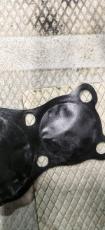

Bad fuel pump membrane... It was new, maybe in the intallation I damaged it.

ANY small pieces of metal found inside? I've seen the check-valves fall apart & pieces tearing the membrane
Didn't noticed any, actually the service I did to the pump previously was changing the check-valves so I got to them.

If the diaphragm is brittle and slightly cracked fuel will leak through and it will not pump sufficiently.
