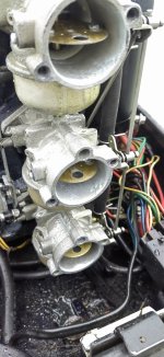

I have a 1989 Force 85 hp motor, runing the motor WOT today it started working good then it started bogging and going slower maybe 50% the speed it usually goes, I opened the motor cover to inspect and noticed there is milky fuel in the carb intake, see the picture attached. Is this normal or and issue? what can cause thisI've read in tbis forum that this could be the reeds valves not working good.

Any water in the fuel?
53,348
What was the temp you were boating in? Do you have a fuel/water separator filter?
Most likely you were boating in cold weather with water in your fuel

That milky stuff is normal !
Never seen it before that's why it called my attention.
I ran the motor today again in it is erratic, it idles good, then going from stopped to WOT ran very bad for about 5 minutes then from nothing it started running very good for about 10.minted like it's something was unclogged, then I stopped and repeat and was the same rough start for some minutes and then it ran good.

Just an update I took the boat to the lake again,,, no work was done to it from the previous take out, I just wanted to try my luck and have more detail of its behavior. Milky fuel seems not to be an issue any more, it seems that the last time I ran it I got water for trying it with out the cowl and getting watter splashed there, this time I got no water or any indication of milky fuel. Now it still is having issues getting into high RPMs, what is strange to me is that we started pretty good in the morning for about 10 minutes running steady good RPM's but suddenly it just reduced RPMs and I could't make it ran well again, we wanted to fish so we decided just to move short distances at low speeds, the boat was steady at low RPM's taking us from one side to another but at any time I tried to rev up it just died.
