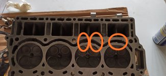

You're correct, the leak is NOT the exhaust valve itself. However when I piur water into the exhaust port, water was trickling out. When I piur water into the intake hole, it held fine. But... After removing the intake valve, I find the hole. Question now is how the heck that happened??? But I'm now certain this is the reason why cylinder 4 was not doing it's thing.
Ahick, Matt Fl, if this hole is patched well, can I get a reconsideration that this will fix my issue. :)? I measure the block, the piston does not go beyond the block. Meaning if I take a straight ruler and place it across the cylinder, at TDC, i can slide the ruler across without touching the piston. However, I see divot on the piston face, which is to provide clearance for the valve??? But making adjustment to valve clearance can help? Or is this a bad head and it won't work?

I think a new head will be better choice. There will be a better seal with a new head cylinder. The picture show the worried area where seal is lost due to corrosion.

IMHO, junk that head for sure. It's not even worth thinking about.

Basically that head most likely will not be reliable, so if you want a reliable motor then a new head is the way to go, but if you're OK with the risk in exchange for fun then go for it with that head. As you suspect, valve clearance (and higher than spec compression) may be an issue after the machining. Now that you know the pistons don't protrude out of the block, the next thing to test is the valve to piston clearance with the valves operating. One way to test is put it back together, timing belt and all, then with the spark plugs out turn it over slowly by hand and make sure it spins freely. You can also put some clay on the pistons, spin it over, disassemble and the impressions in the clay will tell you how much clearance you have. There may be thicker head gaskets available which could help resolve compression and clearance issues. I don't know if you can get away with multiple stacked up head gaskets on that motor or not, but that's another potential solution.

I normally take the boat out in the open water so I need it to be reliable. I'm lucky that this problem didn't left me stranded the last couple time I went out. Yikes...

I went ahead and bought a new cylinder head. I didn't want to chance it and having it break down on me on the water. The old head was in pretty rough condition. Also, head gasket isn't cheap so it was better to spend the money for a new head.
