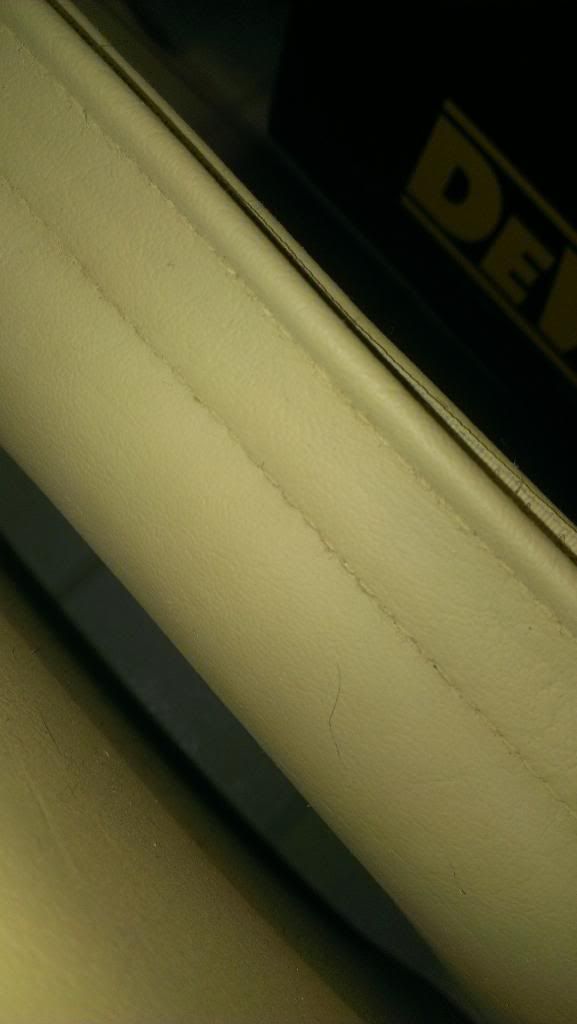

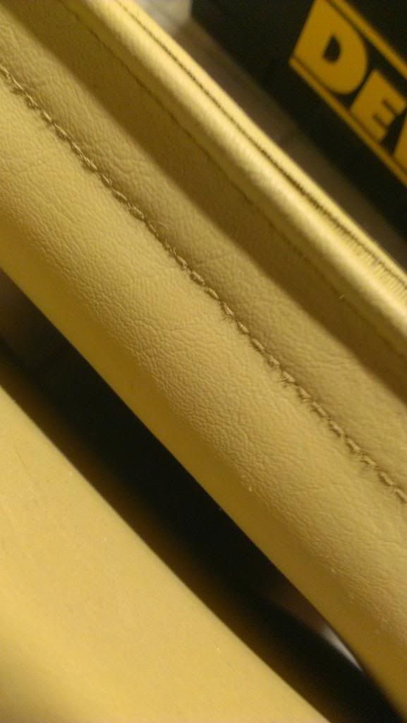

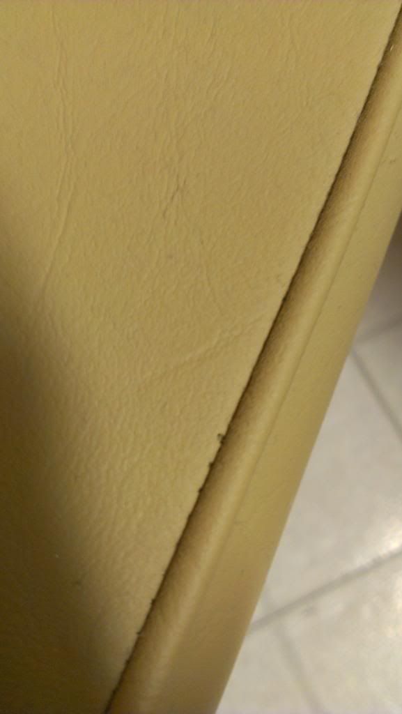

I was planning to recover my seats this winter, but since this has happened I am going to try some spray vinyl dye. May do one seat next week.
I had really good results using Rusto dye:
Before:
After:
Wear & durability testing pending, so no test data, yet :facepalm:
Before:
After:
How does it look over the seams? Can you tell something is built up over the stitch, or does it blend nicely? Even if I only get a year or two before it starts to look bad that would paste till I can afford a recovering.
Also, what did you do to prep the vinyl pre spray? Can I rub them down with acetone then spray, or is that too harsh?

I think the seams & stitching covered pretty well:
It shot like paint, rain like paint when I stopped moving & put down too much, but left the faux 'grain' texture showing. I took the seats apart from the hinge to clean them, used TSP & a toothbrush to scrub the welting & grain really well in the early am. Let them dry in full sun most of the day. Brought them up on the porch under shade about 4p, wiped them down per the directions, acetone I think, and let them cool for a bit.
Took it slow, and shot the seats in an order that made sense at the time. Edges, seams & welting 1st, backside of the seat back, perimeter of the cushion, then the field in a crisscross pattern to minimize an uneven texture/appearance.

Those look great! I'm so tempted to try the rusto. The trim panels and bow seats don't see much abuse, so I will use it on them for sure. The rustoleum is 6$/can vs 12-14 for the true spray dyes I've looked at. The green I want to use I found only n the duracolor dye, but I won't use much of that color.

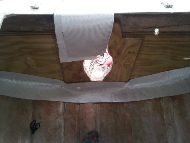

I got the transom tabbed in today with 8" 1708, then skinned with a layer of 1708. I'll add one more layer of 1708 in the am. It is more difficult to get the glass down than I thought. I would attempt to lay a spot down that had bubbled, and that would always pull some up somewhere else. So I got a few spots where there's a bubble I don't like. Which is why I held off on the final layer. I want to grind and fix the spots I don't like after they dry before I skin it with the final layer of glass. All in all I'm pretty happy with it so far. Should be plenty strong when I'm done.
I don't have any pics of after I started glassing. Don't wanna get resin all over my phone! I'll take one before I get started on the final layer in the morning. Id love tips on using the bubble buster roller. It appeared to me to do nothing.

I only found the roller to be helpful in moving resin down on really flat surfaces -- it was handy when laying down 6 oz. cloth when I did the deck. Otherwise, not so much.
You have the right idea, I think. Get the first layer right, then move on to the next. One thing that helped me was to stay with it and keep working it as it started to kick off. Sometimes that little extra bit of tackiness would make a lot of difference in how the glass would lay down.
Good luck with the second layer!

The bubble roller is used towards the end as the resins starts to tack. With the 1708 use a 4" short nap nylon roller and wet the wood with a light coat first then stick the glass to it and use your hands to kinda smooth it into place espescially into the corners and edges. then pour the resin down and use the roller to roll out the glass until it goes clear. Don't Over roll it and don't roll to heavily. When it starts to tack use the BB roller to roll out any bubble always rolling from the center out.
