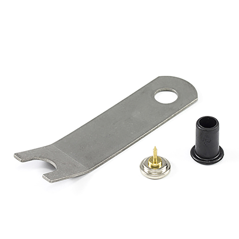

Starting on Thursday of this week, I bought some 3mil plastic and made a template of the bow area and then transferred into my Weathermax80 material, cut it out, used double fold sunbrella 3/4" binding around the perimeter, sewed in 1 1/2" poly webbing (snap backer), then put approximately 24 snaps around perimeter. Went to put it on the boat yesterday and due to excessive wind speeds (30mph sustained, max like 50mph) was unable to get the boat male snaps mounted to the boat. Had an issue using my pop-rivets in the snaps as the opening is too small for the tip of the gun, so now I've got to go with screws in lieu of rivets (My Baja had all the snaps attached to boat with pop-rivets).

Just grind the tip until it fits. That's what I do. Many others do the same.

Once again, you've come to my rescue! That's what I'll do!

On my pontoon cover, I have done both. Depends on how lazy I am to get my pneumatic rivet tool out and compressor going. Also, with rivets, water can get through so keep that in mind.
