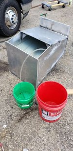

One thing I'm wondering about going forward is having storage below deck like say for fish that are caught. Is there a source for a tank as such? The boat is very deep and could afford to have a storage compartment like that built in.

Yeah I was trying to see if there were prefab poly tanks that I could just drop in similar to a fresh or waste tank but with a open top and a lip. It looks like I may be forced to build one instead.

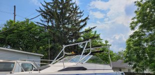

1 1/2"tubing came in today for me to fab the hard top and swim deck/ jetski carrier. I was slightly concerned about putting a 90 in this pipe, but it bent great. There is a bit of waveiness in the inside of the 90 but I think it'll be just fine for this boat. I welded some smaller tubing back in the summer for a few projects of mine and they all turned out good. The ambulance has a overhead rack for the generator, The bike is a pannier mount for motorcycle adventuring, and I built a surf fishing cart.

This will be what I'm working towards. I think perhaps I may want a spotting tower up top aswell. The rocket launcher mount on the aft section is gonna be raised in the center to keep. From knocking heads on the pass to the stern because of the 2 level deck going into this boat.

Today saw some productive work. Don't kid your self about the strength of that tube trying to remove just the slightest degree out of that tube was impossible even bouncing on it with the bend down and the other end under the ambulance.
These are just mocked in position just to understand how is gonna fit there's extra material on both ends for adjustment.
It's cold can't wait to get this thing erected to allow a gigantic tarp to drape over for a better climate.

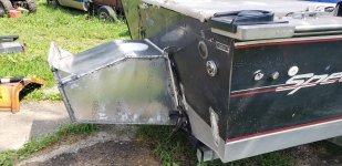

hey i meant to ask how big was spectrum and how did it act with a bracket? i was going to bracket my 17 footer but everyone said it wasn't wise of course a aquasport dont seem to be as wide as those.
huggyb1972
Apr 1, 2013
256
It was a 19' with about a 80" beam.
It came on plane better at a lower speed.
The transom was approximately 2" higher in the water.
My speed increased to 40 with a couple adults and me on the boat. Max before was 36 on the OMC 2.3 TKO.
Handing was good, throwing a tube around was not any harder than any other boat though I could've stood to have hydraulic steering, over cable.
I did have trouble with the engine height I had to add a 5" extension because the power head was to low and was sucking water into the bottom cylinder and causing issues (I think)
