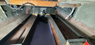

Well it's been consistently in the 90's temperature wise here in California and so I have to work early in the morning or late in the evening...... until now.
