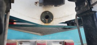

I'll have a better idea of how bad the rot is after pulling the engine. The way things are going, I have a feeling it's not going to be good. I noticed what appears to be a stress crack radiating from the garboard drain when I pulled the outdrive yesterday.

Yeah, that's right about at the bottom edge of the transom. Since you'll have to cut the bottom half off anyway, just do the whole thing. By the time you cut the transom in half, it's not really any more work to just take the whole thing out.
