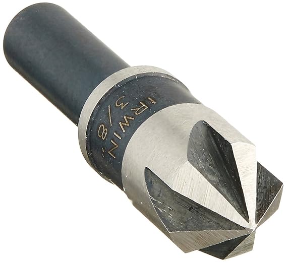

Yup a bead of pb and coat holes and screws then fill the countersinks with pb. No water will ever get in from the screw holes
kcassells
Oct 16, 2012
8,738
To counter sink get a drill bit similar this. There are a million of them readily available.
